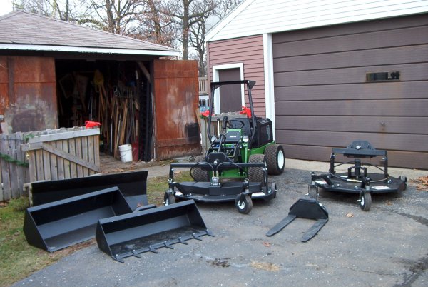

Or, you could get a Power Trac like mine and get a towing adapter and be all done. :D

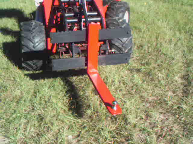

OK, I finally found a picture of the ideal set up for me. These forks was purchased for about $160, and adapted to my
Power-Trac 1445. I also use it to lift other things, engines, tires, welder generators, etc.

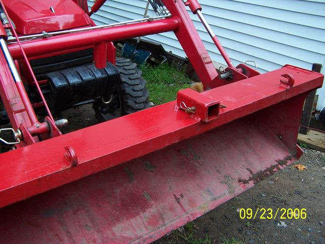

Dan,
I did what JB did except he bolted his to the bucket. I reinforced the top of my bucket with a piece of 2x2 angle and welded a receiver in the middle.
