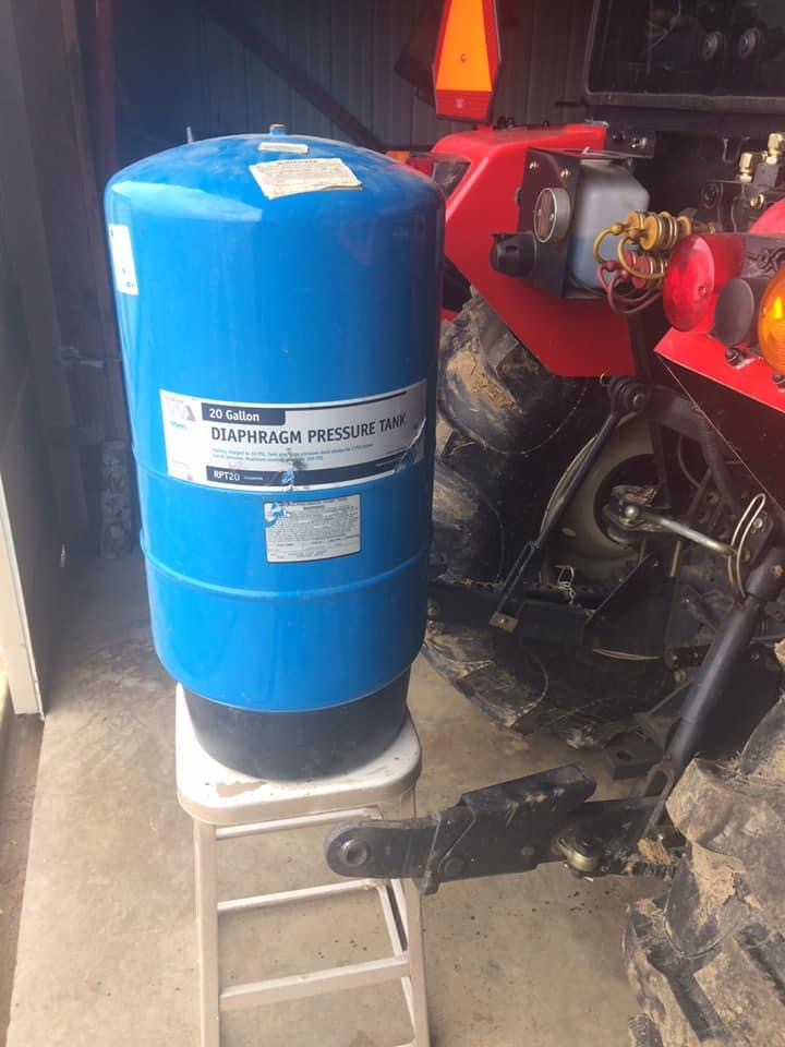

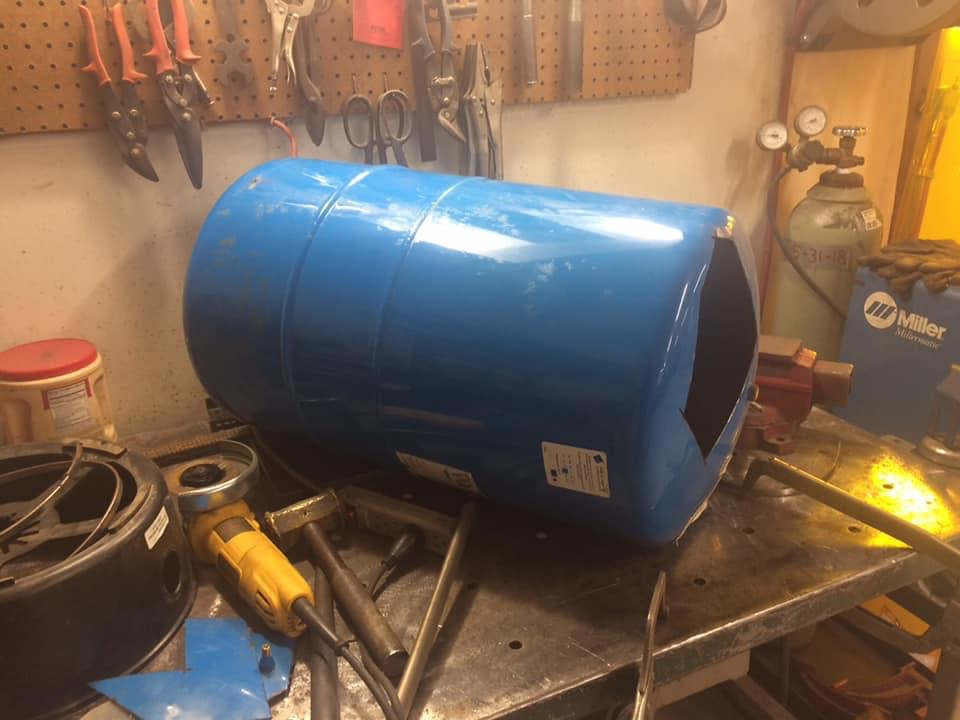

I do not know how I missed this thread. Orebonder you did a great job on the fab work. Thank you for showing us what you did and how you constructed it. I am curious on some details on the reservoir. The well pressure tanks generally have a diaphragm that is attached to the inside sides of the tank. Did you remove it, and if so how did you do it?

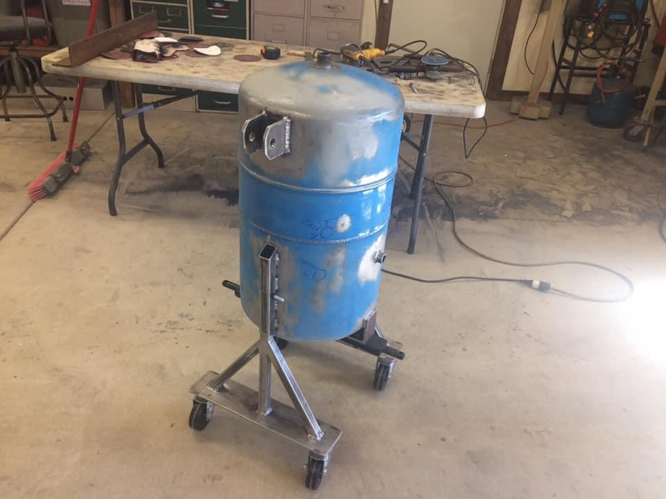

This thread must have just slipped through. Look at the great planning, beautiful welds and end result. Even the shop is organized and shop rollers home built. Love the pictures and wish I could do a job like this.

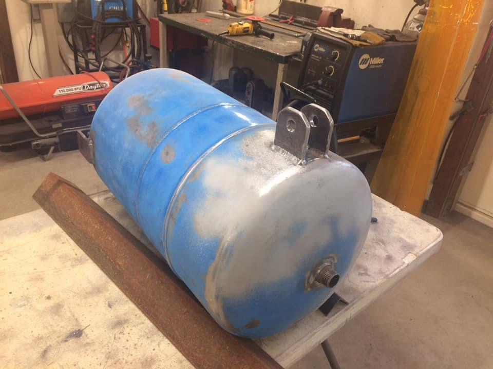

Thanks....
I cut a chunk out of the bottom...removed the bladder and the metal ring that holds it in place...then welded the piece back in place.
