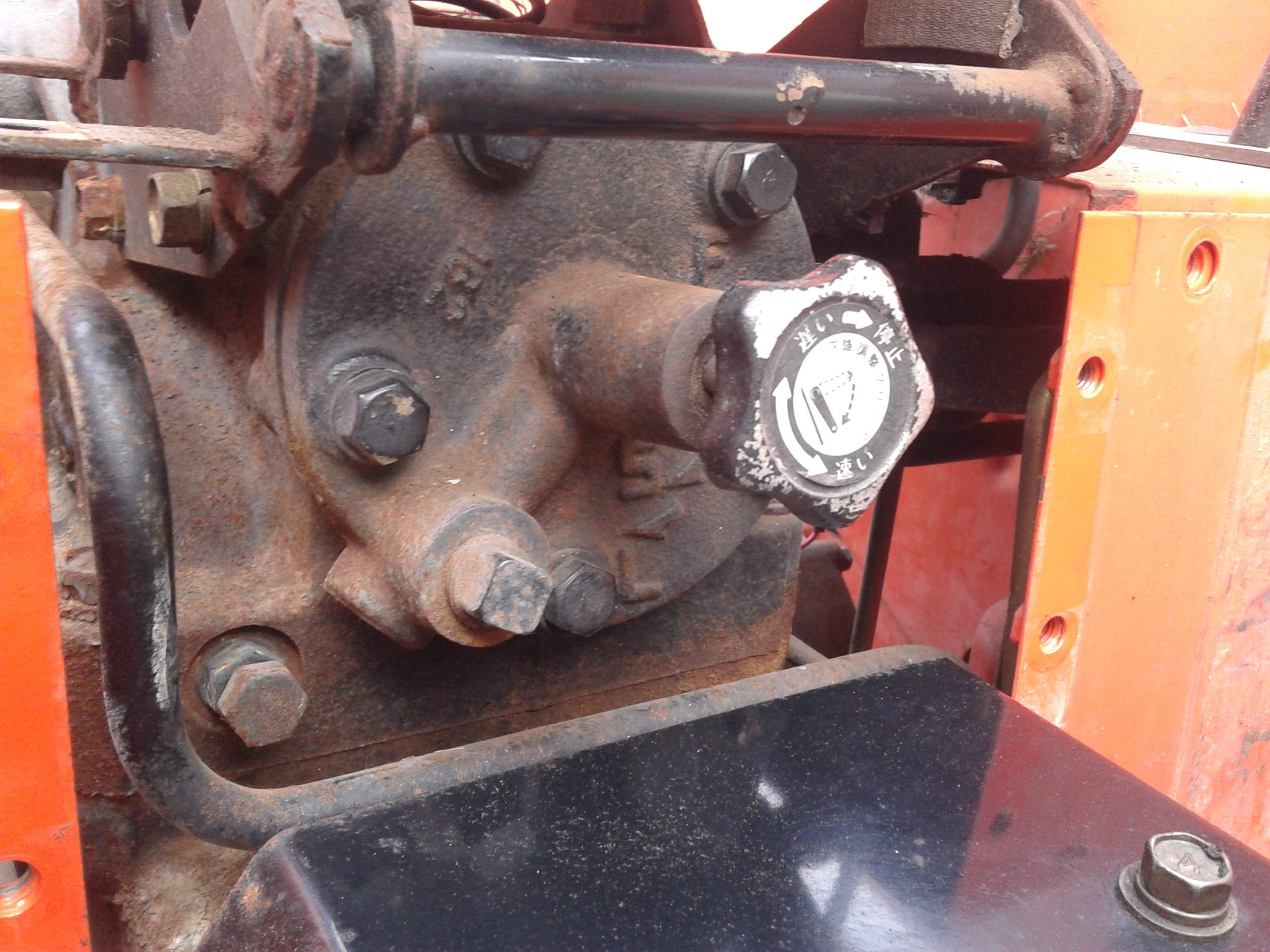

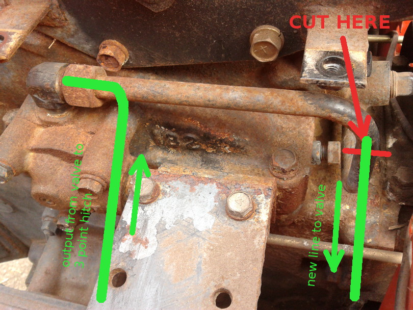

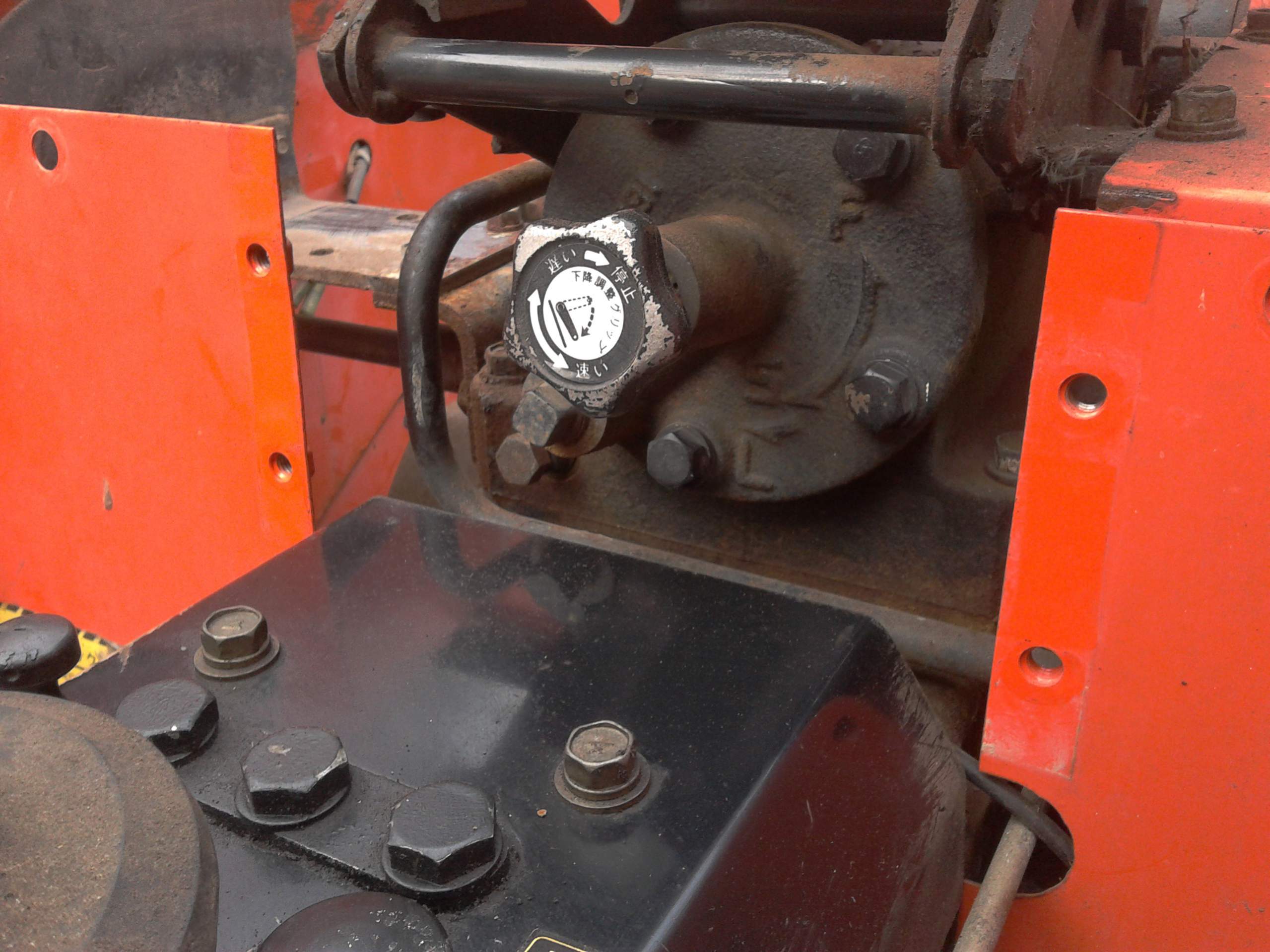

Although J_J gave me terrific advice on the PTO pump, I was just about ordering stuff, when a friend stopped by. He asked me why I wanted to use a PTO pump, I said because I don't have hydraulics on my tractor, he said you do have ..., I was like ... ??? uuhh no. He said you have a 3-point hitch, so you have hydraulics, you just don't have auxiliary outputs. If you use a PTO pump for the front en loader you want to build, you can not use your PTO anymore. At that point, I was like ...okay ... you have a point but how ... he didn't knew it exactly but gave me some pointers. I should:
  • cut the hydraulics line before it entered the 3 point
  • or put a line to the hydraulics regulator
so this afternoon I took of the chair and some bodywork and this came up.
The pressure line is 12mm (+/-1/2inch) so this is my guessing:
I think could reconnect the pressure line with some olives and union nuts and deviate the line to the new control valves. Then the power beyond outlet of the control valves back to the 3 point hitch inlet connection.
The other option, I don't have a clue whatsoever. I see there are some marks like "L" and "S" and "F" and some numbers and arrows on the regulator but I do not know what they mean or what they do.
In the end, if this is possible, this will be a better solution since I still can use the PTO for other things, even with the FEL still connected. And as a "bonus", save some money to spend for other attachements (no need for extra hydraulic tank, filters, etc. ...)
What is your opinion on this ?

Scons,
You are correct on the pressure line and power beyond connection.
The unknowns are:
Where is the system relief valve located on your tractor? What is the pressure setting of this relief.
Where can you return oil back to the reservoir from the "Tank" port on your loader valve.
Relief valve location concern is that you ALWAYS want the relief valve to be the first valve out of the pump.

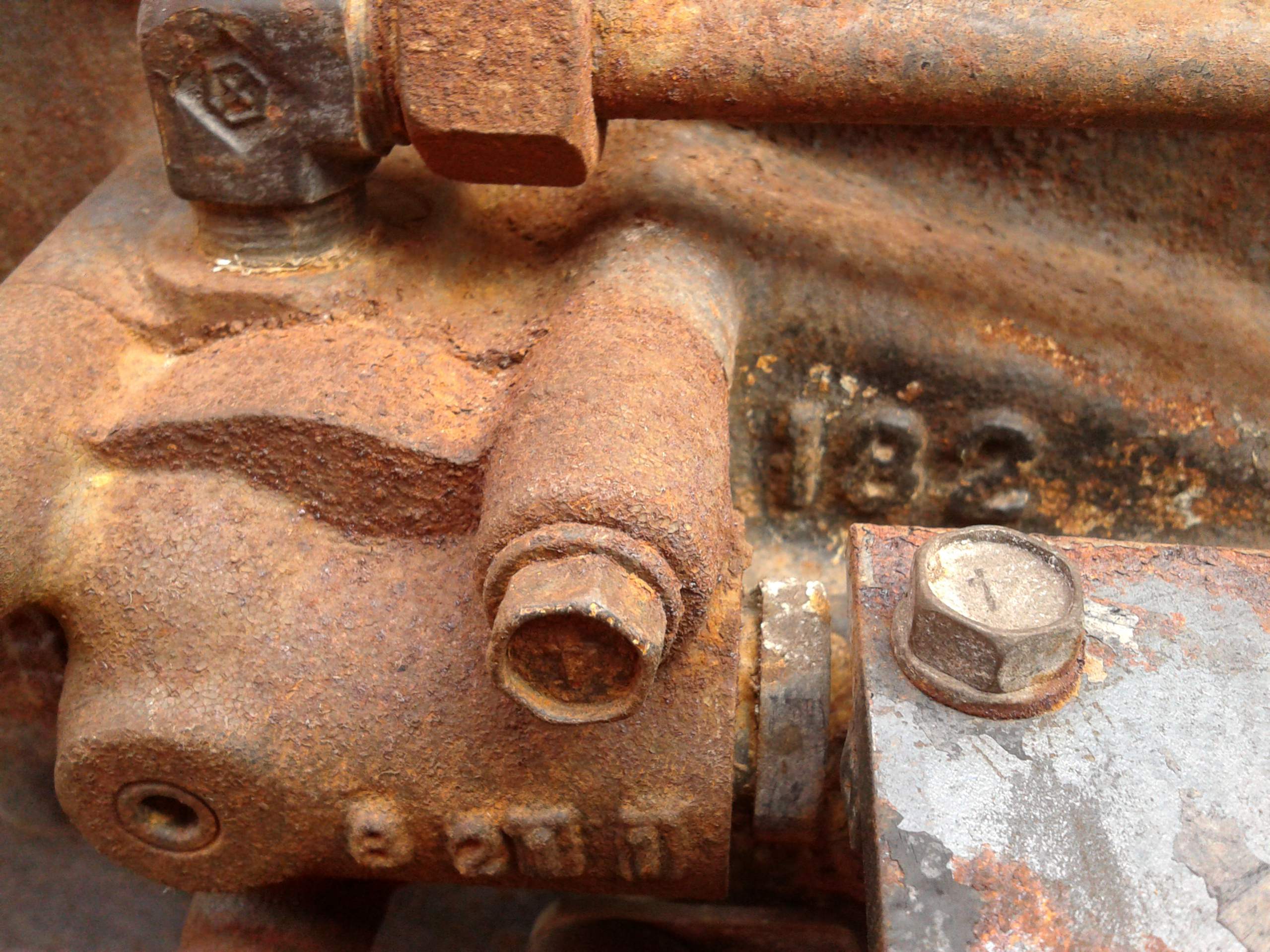

The unknowns are:
I think this is the pressure relief valve since the bolt isn't all thightened in.
I don't know these answers. I don't have a manual or service manual. These are very hard to find. So if someone has one, please pm me and I will be glad to get a copy, even for some change.

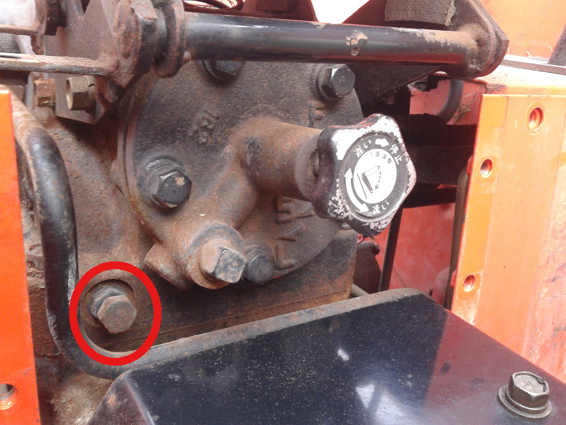

Don't know that yet, haven't bought a controller valve for the loader yet, but I think there are some options for that if needed, there is an inspection cap next to the gear shifter. There are also 3 bolts wich I haven't unscrewed yet, will do that tomorrow to check if they can be of use.
