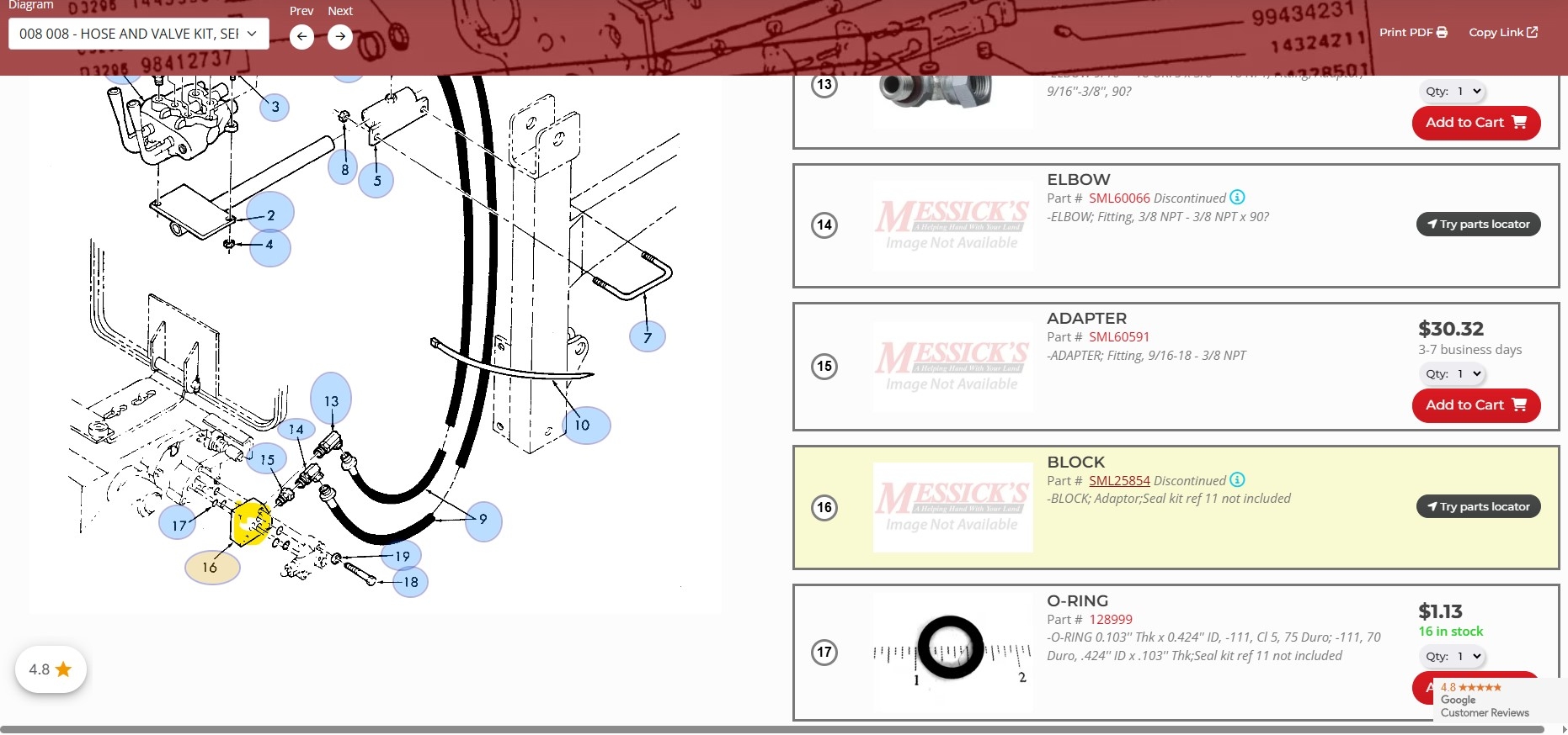

There is an adapter block that has to be installed on the top cover assembly to get a supply and return for the loader. It is pictured here, but not available anymore.
Kleiber Tractor has one for sale: NEW HOLLAND Part # SML25854 INACTIVE:BLOCK » Kleiber Tractor and Equipment, Texas
Ebay lists one: Mitsubishi 1600-2650, Ford 1100-1910 Tractor Power Beyond Hydraulic Block | eBay
Last post in this forum thread, the guy can make one: Looking for SML25854 Hyrdraulic Adpater Block for Ford Tractor

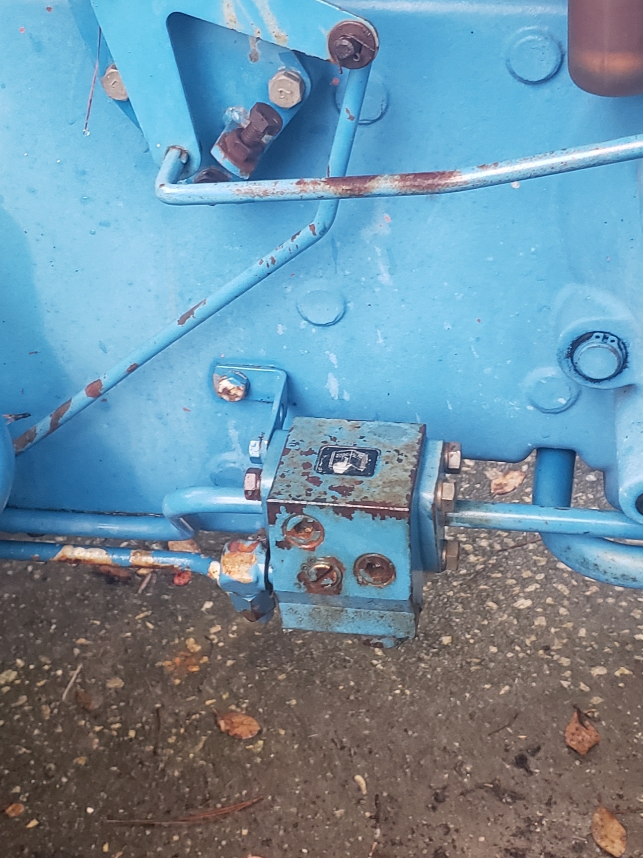

I am attaching a picture of the side of the 1210 and wonder if this block on hydraulic lines can be used to power the loader. Pic
probably doesn't show enough of the system to track it

That is the block on the 1210 to tie into. I am pretty sure the front port is pressure for the loader and the back port is return. With the lines hooked up, you need to turn the slotted spool, on the block, so that oil can go to the loader.
