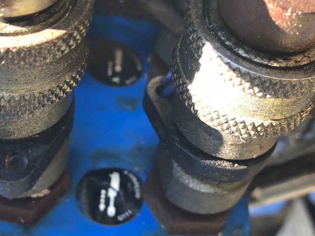

This is a 4 wheel drive, conventional clutch. three point, FEL and power steering from main casing... I really don't know if there are separate pumps for power steering, 3 point, and power steering. I ASSUME.. there is a pump for the FEL... as it is tubed into bottom of case and "sounds" like there is issue there at times.. cavation? overload? dry?
I **** well might have hoses crossed... hence the picture at female points on tractor. one is top row... one is bottom row.
or ... i bent the **** FEL its in a bind and the cylinders can't move it... but.. I do not believe this is the case (no creaking)
new valve is NOT in my hands... is from serial number on tractor at new holland dealer where I purchased tractor.
New valve is not in... couldn't tell you if pressure relief valve is in valve body... and if so... it were trashed.
uh... any of this help?

Does the 3 point hitch work properly now? With 7 hoses on the FEL valve, The FEL valve's power beyond port is likely supplying the 3 pt hitch so if the 3 pt is not working now and was previously, it is further evidence of a hose in the wrong place.
told this was a "dual open valve"...
The FEL valve will have two spools and be of open center design. Some more elaborate tractors and construction equipment operate on a closed center system. With the open center system working properly, oil is flowing from the pump through the valve body and back to the transmission case or reservoir. Only when a lever of a control valve is operated is there any significant pressure in the output from the pump.
The sound from the area of the pump is likely because a pressure relief valve is having to open because the flow is being improperly restricted nor directed
The pump would have its own relief valve as would the FEL valve.
As I understand things, before the two hoses started to leak getting a truck unstuck, the FEL was working OK. It is sounding more and more like a hose tied into the three metal tubes are connected to the wrong place on the FEL valve.
Could you plse post some photos showing more of your FEL valve and the tractor and loader from several angles.

Thanks Dave,
I will get some photo's posted in the morning.
My main concern is my understanding of which end of the cylinder is return...
I am tracing the hoses, back through the tubing, to the quick connects.
there were little colored orings on the hose and connector to match up, those are gone... I didn't mark anything before disconnecting
trying to follow the pictures above... believe top two connectors are for arms... bottom two for bucket.
The 3 point has not been effected at all. nor the power steering.
I do agree... that losing hoses at this rate is WRONG.. however, calling them HYDRAULIC hoses is a huge compliment to them. This machine has been through two hurricanes, and sat out in the Texas sun for almost 10 years. Every time you strengthen one point, you are compounding force on another. Saw that coming day one... luckily the hose shop is a half mile down the road and cheap.
That valve is really toast... draining the fluid out .. (prob 50% water)... letting it sit, then reinstalling the valve, i believe has sent trash into valve. Worse than when all was in emulsion... fluid was out for two days.
I have had cylinders bleed off on backhoes, i don't understand how TWO cylinders could bleed off at the same time... just back-flow through common lines i assume. With problems with all four cylinders prior to this mess... i am pretty sure the valve is history.
just confirming I have hoses connected to correct quick connects would be a plus.
She was acting like i could use her to finish a quick project before the next rain... if I was an inventive operator.
True fix is to put on valve. Do need to be sure hoses are correct... forever
