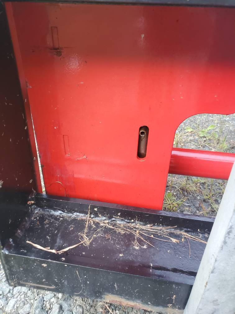

Hi all,
I have a probably rediculous issue. I was swapping my bucket for forks the other day and found one of the locking pins hopelessly frozen. It's always given me a little grief but I've had the bucket on for a few years so it's had time to freeze. I tried PLENTY of penetrating oil. Nothing.
I pounded the pin up with a hammer enough to be able swap out the forks but obviously this needs addressing - it is no looser. I would like to pull the pin all the way out and clean it, sand it, replace it - whatever it takes to get the action smooth.
However, the linkage elbow has a pin through it. And that pin goes through a channel in the fel frame (pictured). I dont want to just start hammering and hoping. How would be best to proceed while minimizing collateral damage?
Thanks for taking the time.

It doesn’t look like there’s a factory grease fitting on that. My Kubotas have a grease fitting and if I neglect greasing it it’s a duplicate of your experience. If it’s greased it works easy. I’d pull the pin completely out of the holder and drill and tap the holder for a grease fitting.
/ Front end loader - frozen lock pin #3
Even my after market adapter plates came with grease fitting for the pins. But something may be tweaked if you had to hammer the pins up. Is there any clearance at the bottom of the plates where pins meet the attachment? Do the taper on the pins engage the attachments at equal length?

Check out Roll Pin Punches at McMaster Carr.

Pretty shiny tractor to have a frozen pin. All mine have grease zerks, Kubota inside, Bobcat outside. Have to tap the roll pin to clear the backing plate to remove. Either drill for zerks or routinely spray with lubricant like corrosionX when greasing loader pins.

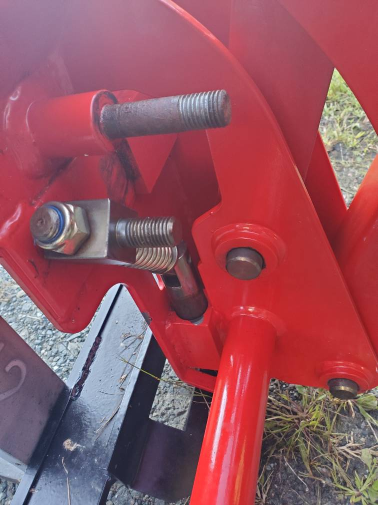

You can remove the whole quick attach plate from the arms. The pins are seen in the pic. Just removing the top one and letting it pivot down would give you more room to work, but I would remove it. Then you can see about drilling and tapping for a zerk for lubrication.

No issue moving the bucket around. No zerks at this particular point. An admission... never heard of roll pins but have a kit coming tomorrow. I will try to tap it out, clean it the large pin, and grease the holy hell out of it. Lesson learned.

After getting the roll pin kit, I was able to work the locking pin back and forth, greased the hell out of it, and now it's freed up. I'll start greasing those pins when I do all the zerks. May try to tap a zerk if I get brave enough.
