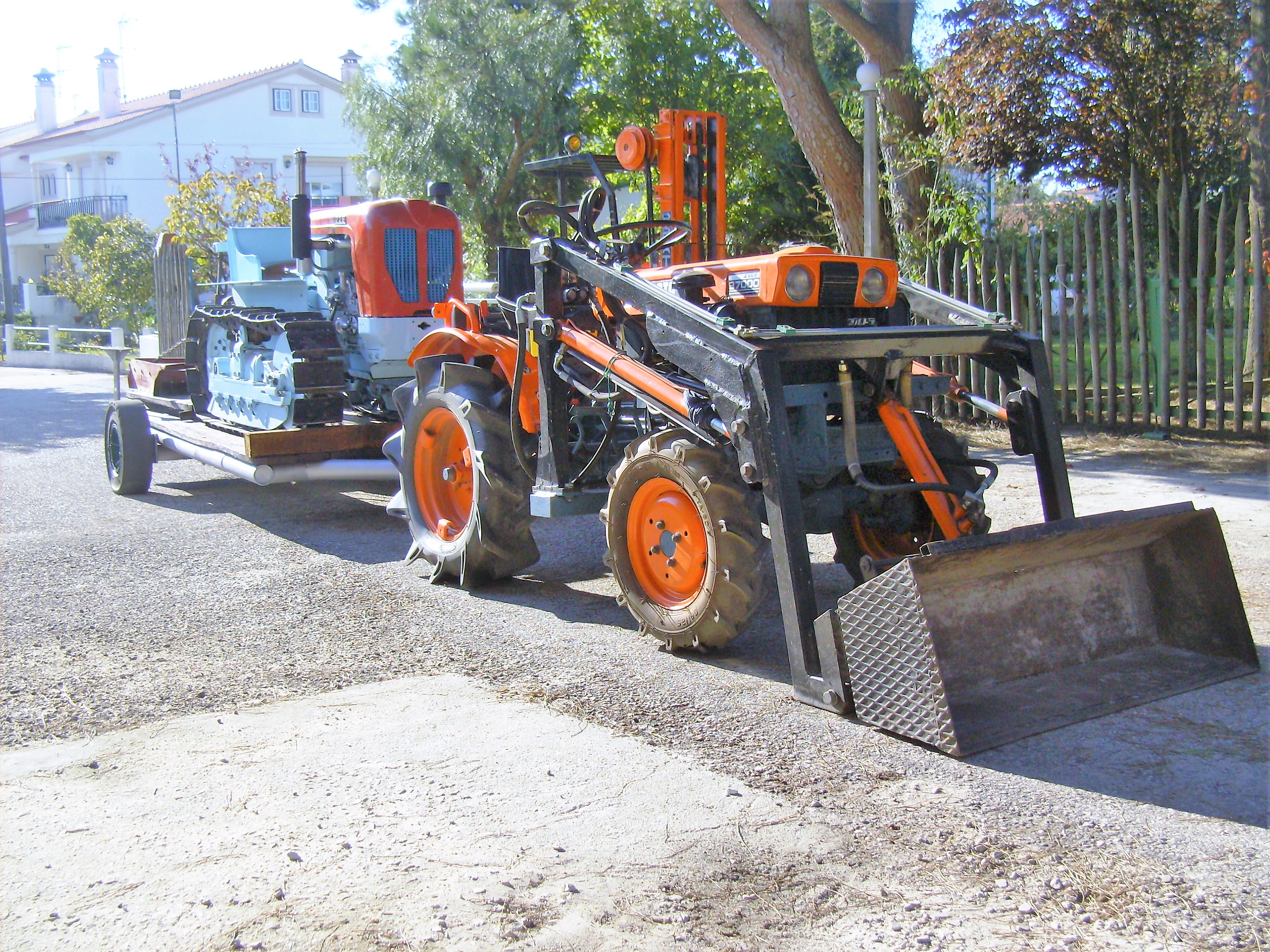

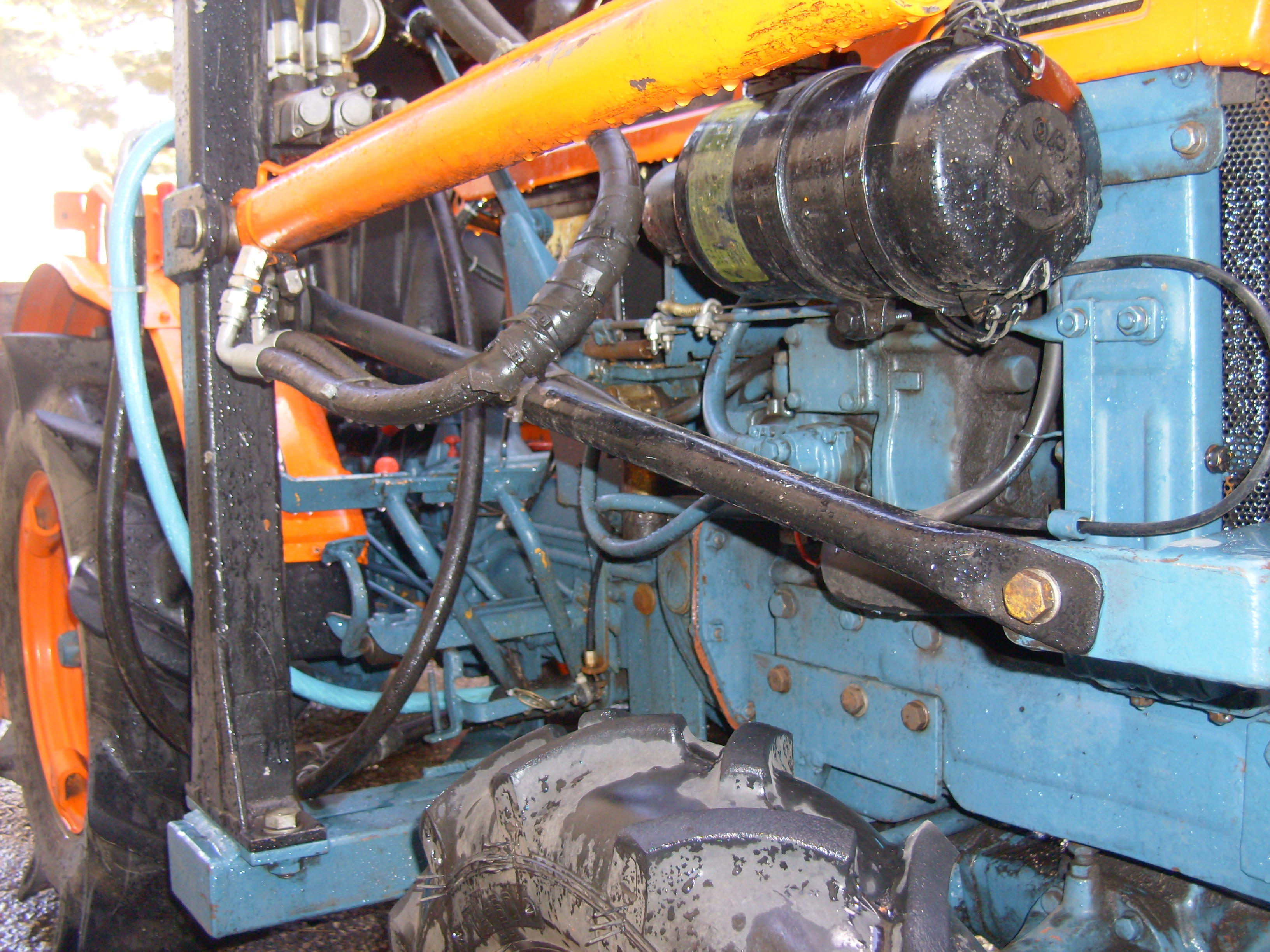

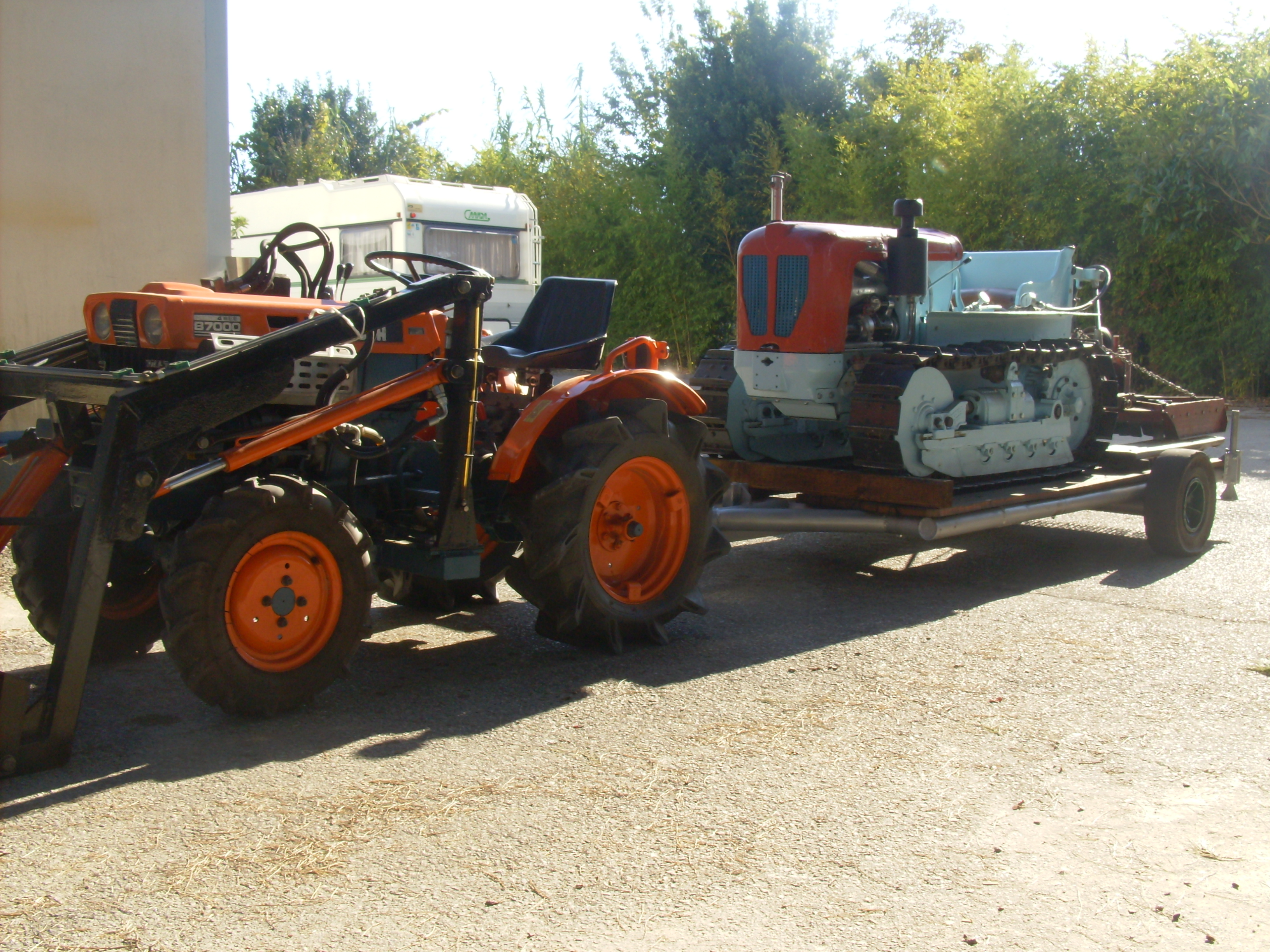

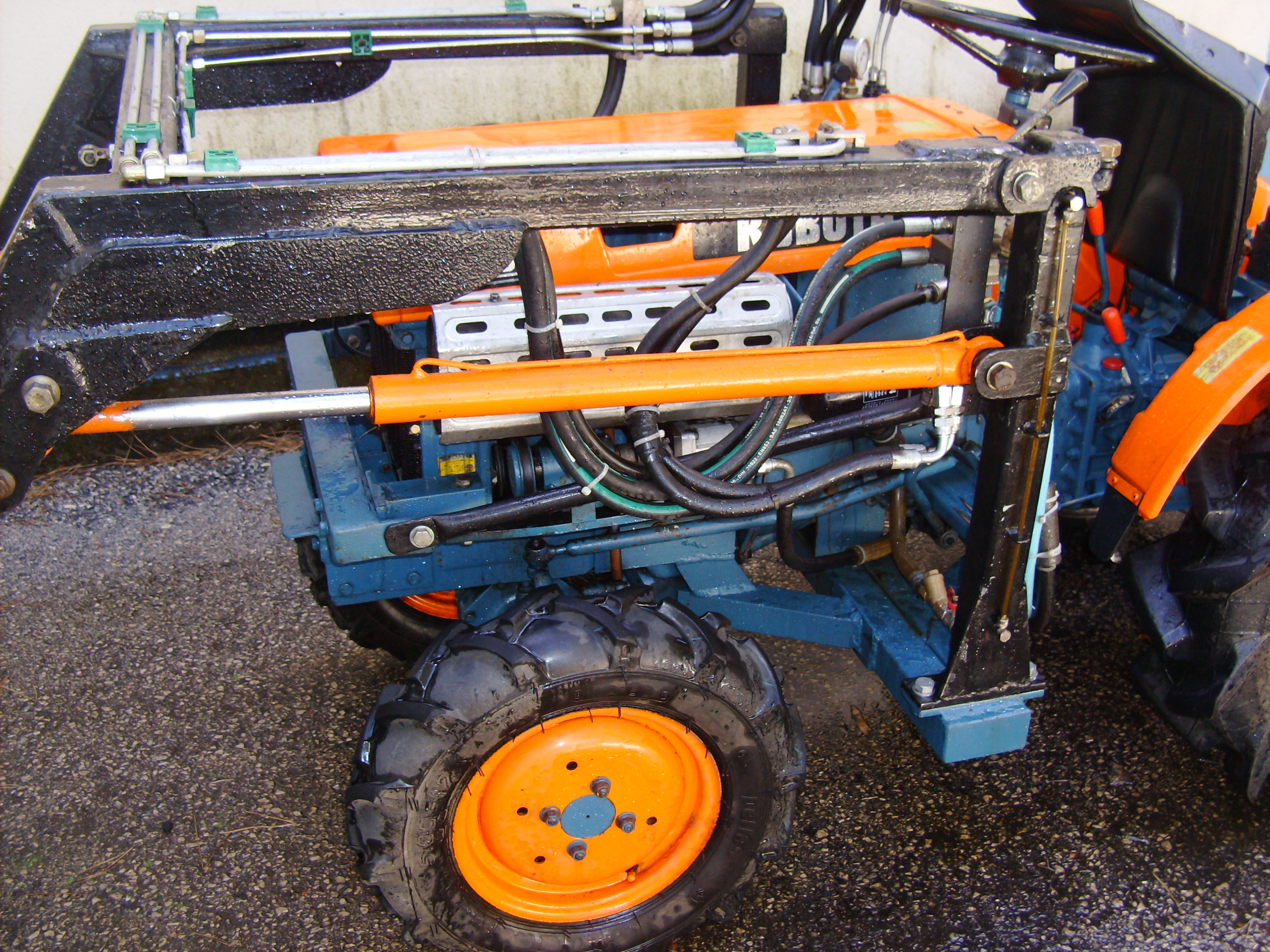

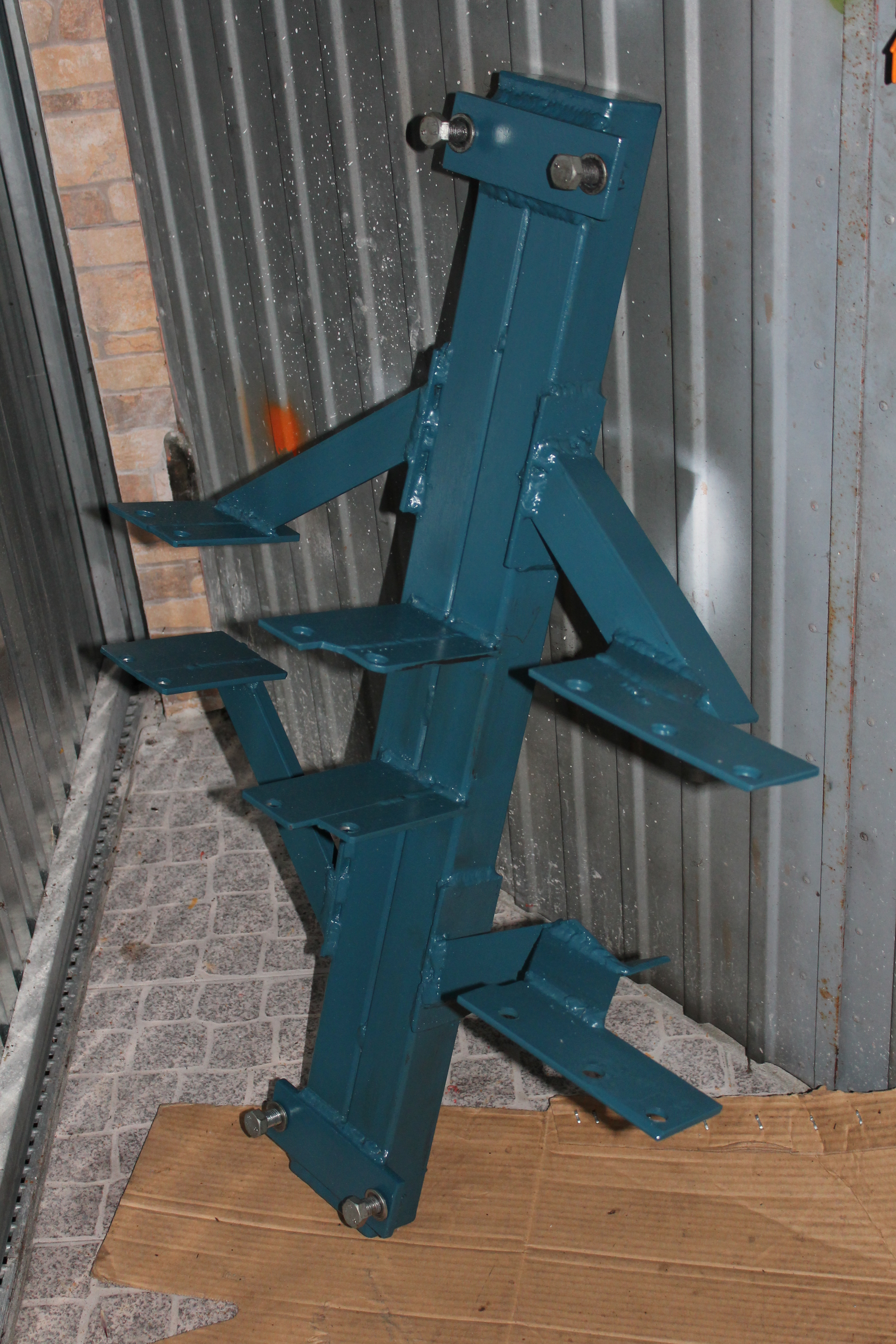

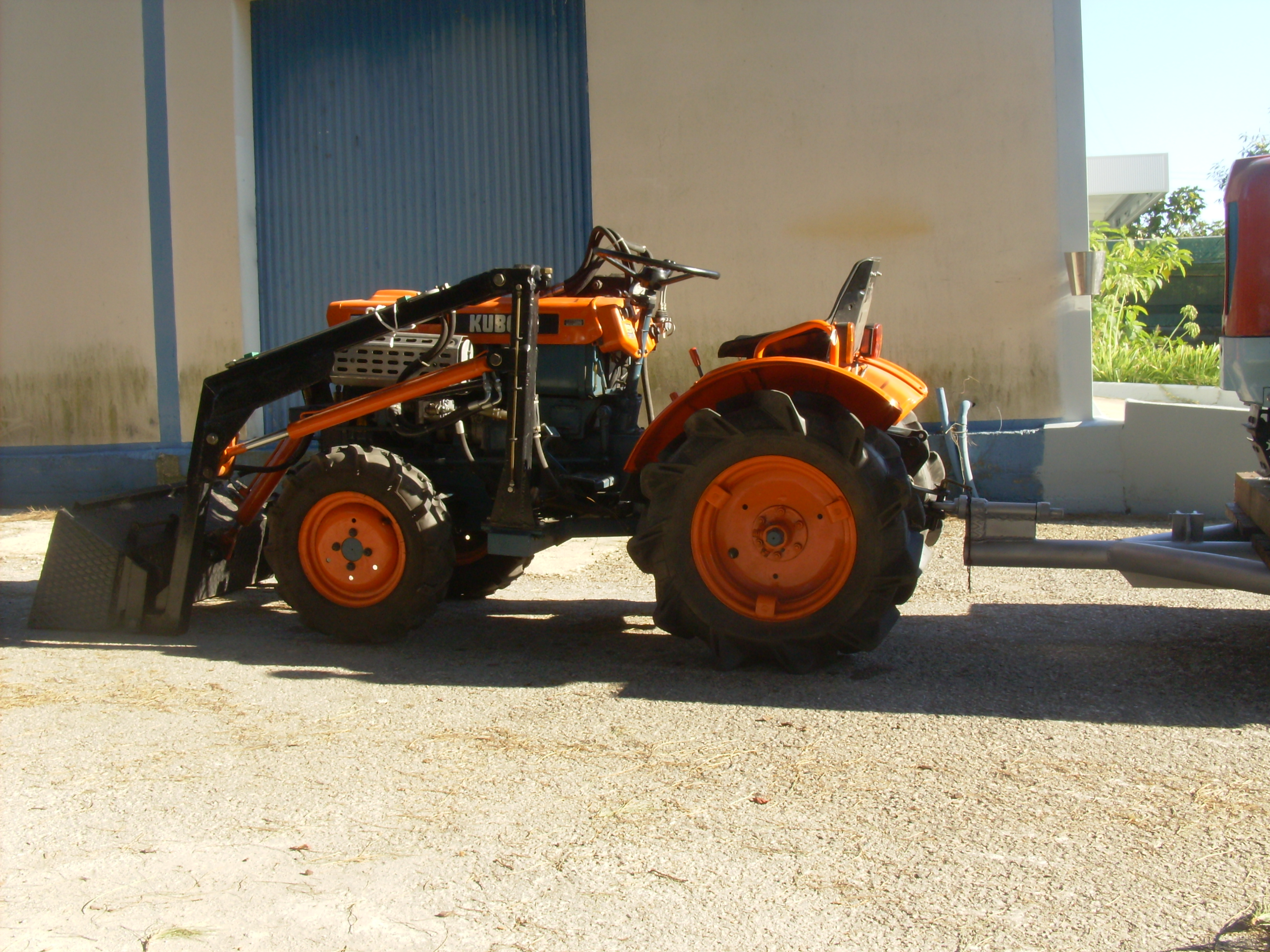

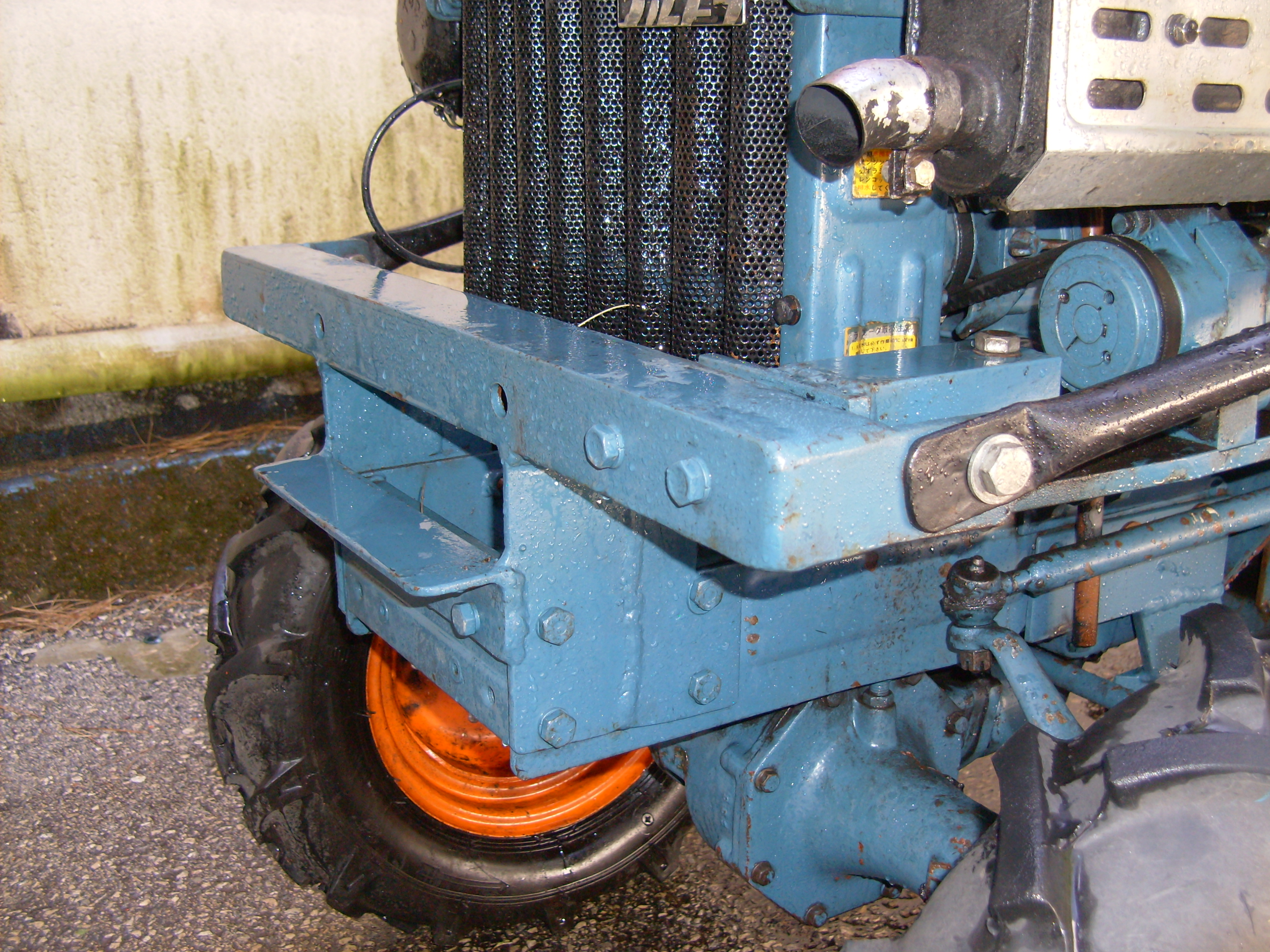

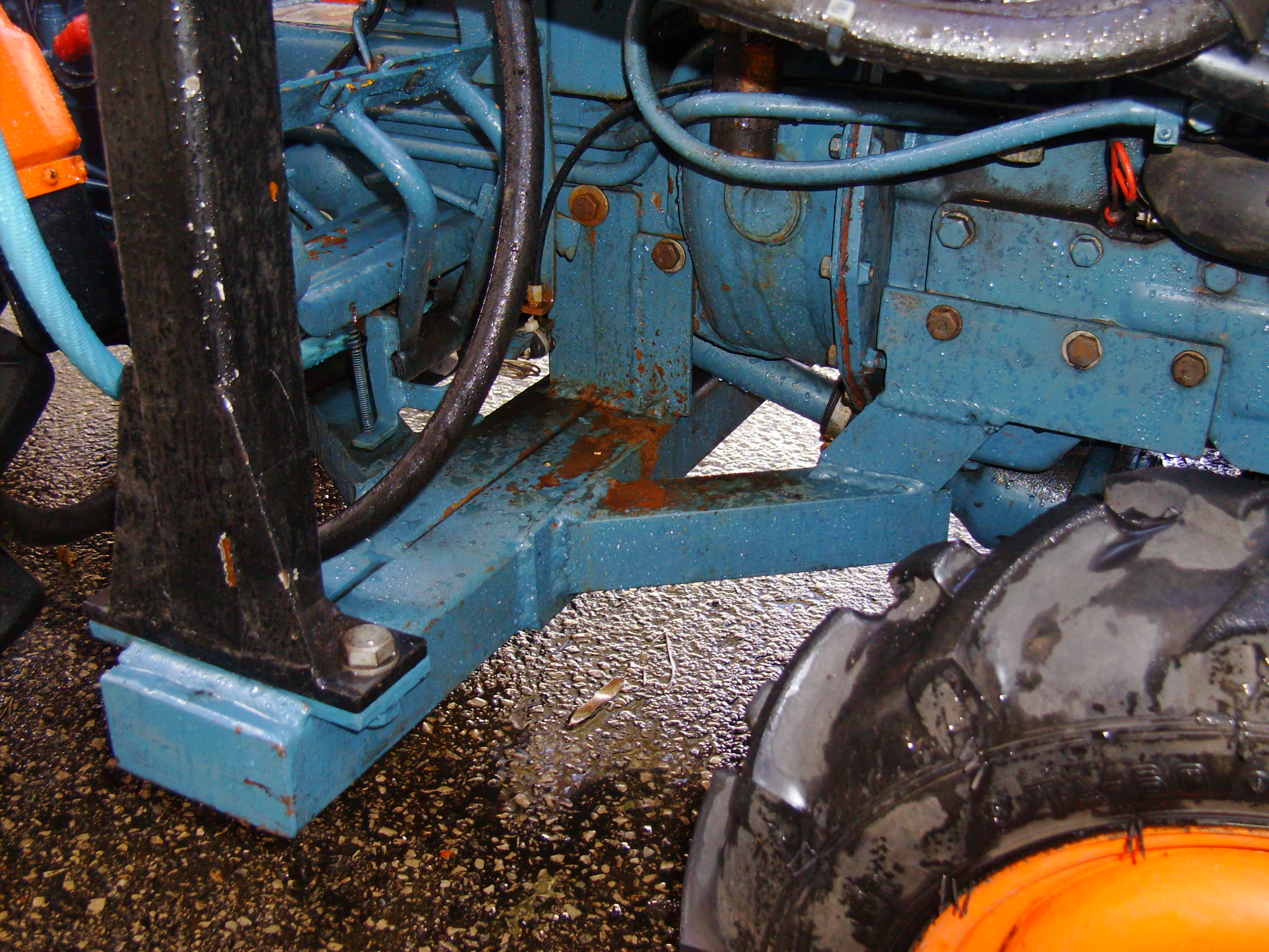

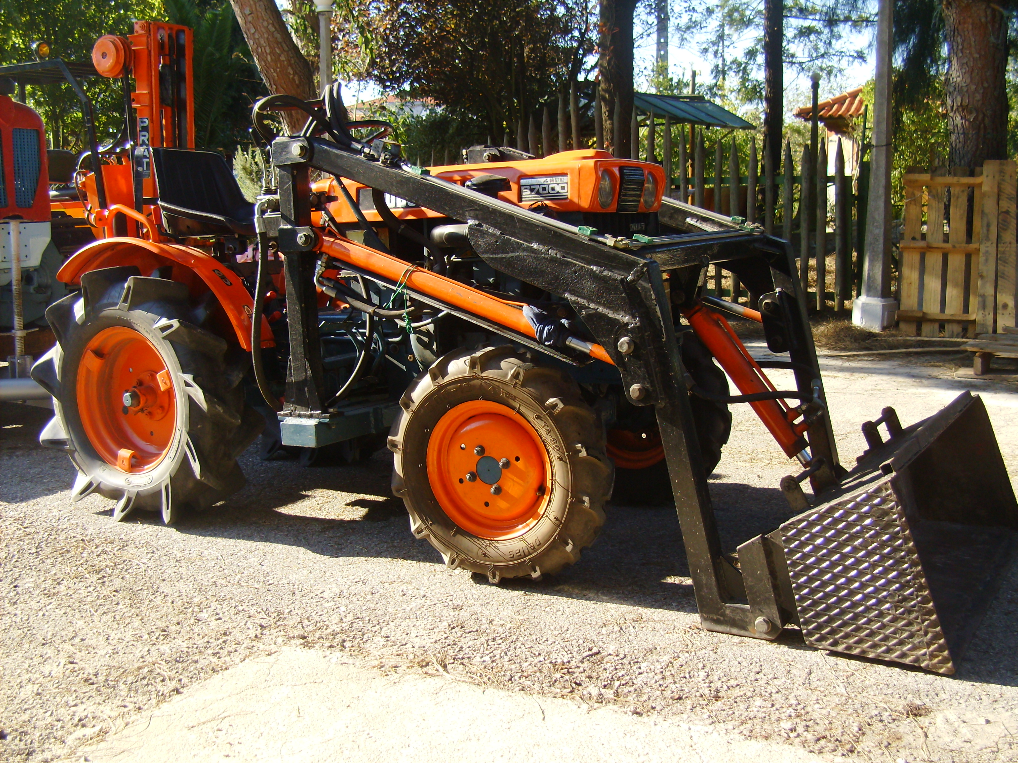

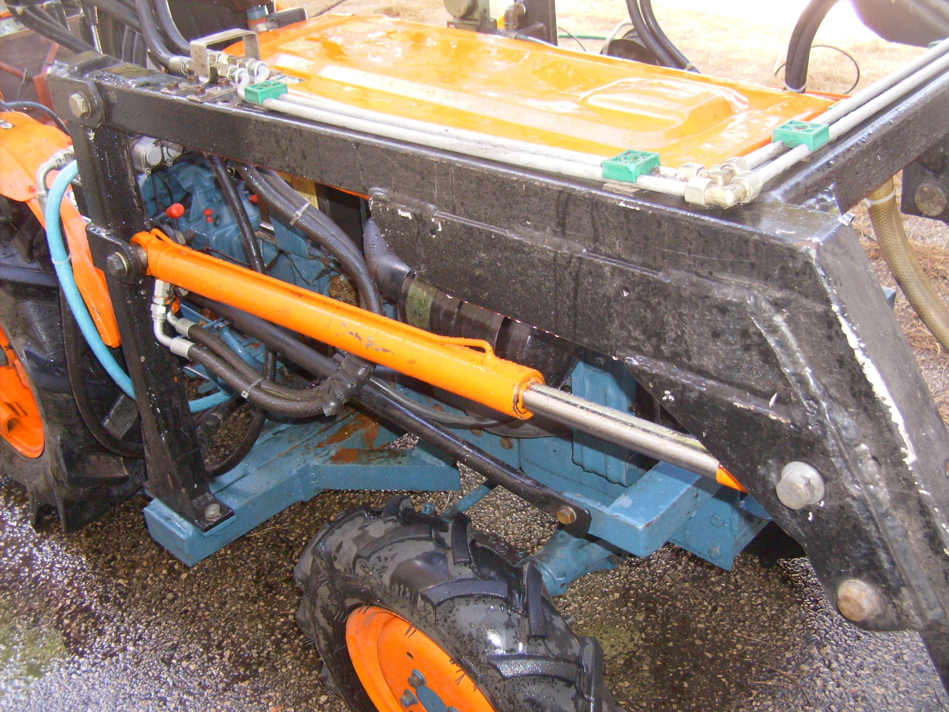

I made a loader of a Kubota B7000 a long time ago.
Bought some cylinders on the scrapyard. Two of them were from lifting the cab of a truck, the other one I can't remember.
I had a long piece of 60x60x5 mm square tubing that was enough for the entire loader plus subframe.
At the time, I didn't have a lathe, so I couldn't modify the cylinders to my taste but it still ended up alright.
The subframe is key and you want to spread as much forces as possible from the front to the back. These tractors are not really meant for loaders. The front axle won't take much abuse from lifting heavy stuff and the aluminium transmission housing won't help much either.
Add some diagonals from the loader towers to the front of the tractor. It will help a lot. I mounted a separate pump under the exhaust, driven of the crankshaft via a V-belt. One of the towers was the hydraulic tank.
One mistake I made was that I had not enough curl with the loader close to ground. I had plenty of dump, even at max height.
Mine was limited around 450 lbs of lift capacity and was plenty for that size of tractor. Once you mount the loader one, it will be very tippy and light in the back, just be aware of that. I fully recommend either get wheel weights for the back or fill the tires and still run an implement or some sort of counter weight in the 3pt.
Here is some random pictures. Hopefully it helps you some.
