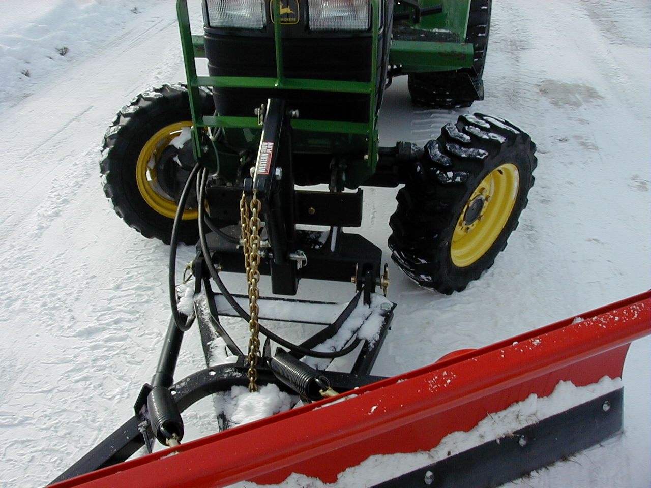

I had a blade on my TO 30 Ferguson.. then another on my JD 420 Utility, and now a blade for my JD 4300. Pretty easy to fabricate and weld something up using existing blades.. it will push dirt, rocks, gravel, etc. too.
Where does the push load go into the tractor on you setup?
Fabricated bracket between plow A-frame mount and tractor hooks into the mid-mower front mount plates and tilts up to mate with the front weight bracket, held only with two 1/2" bolts.
   / Front end blade for a tractor? #25
I worry about loading the axle mount and the engine to transmission interface. I've seen a few failures at those locations.
Prudence is warranted!

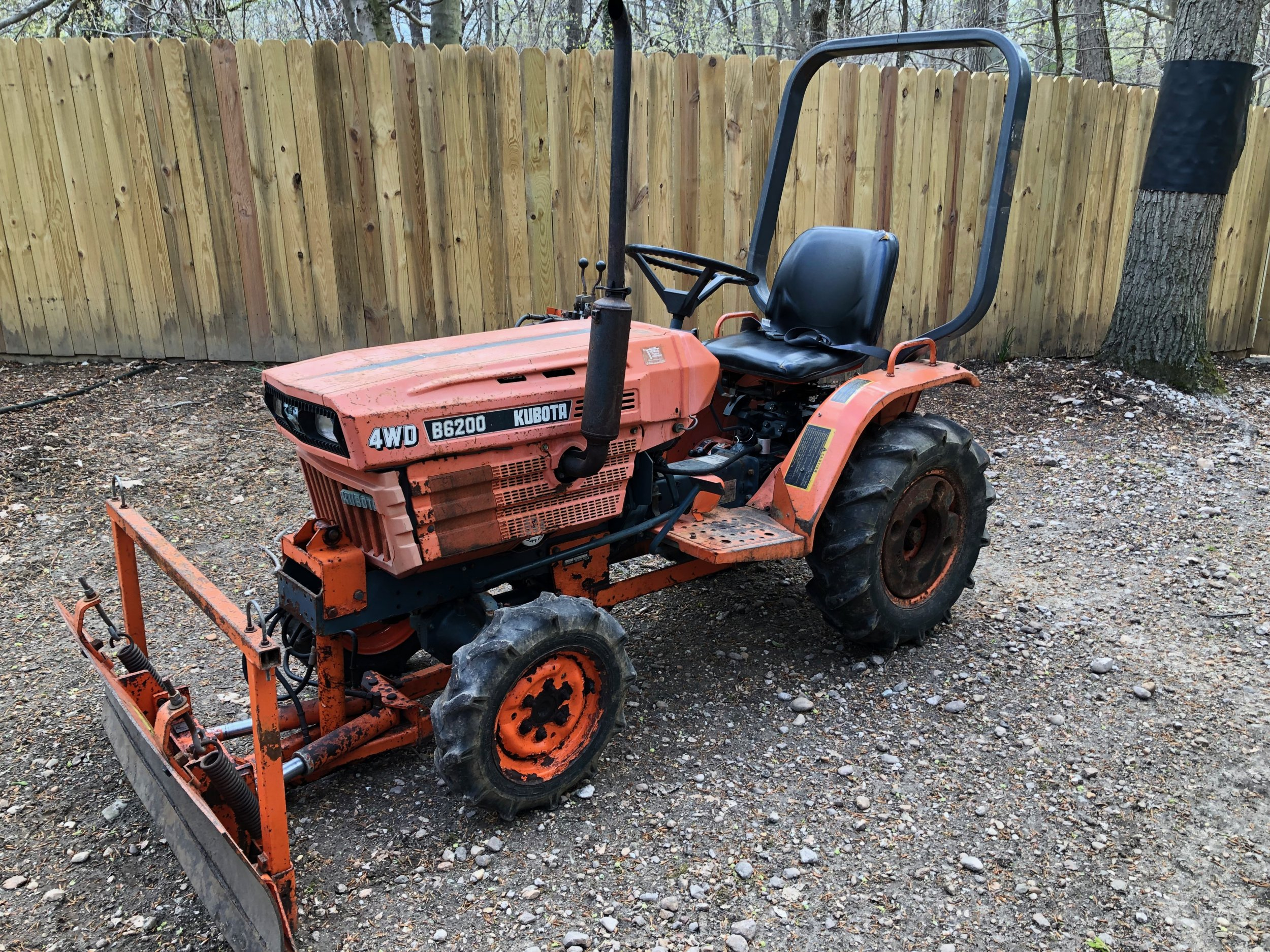

I know you can buy them for the little kubotas. My old boss had one. I thought it was for plowing snow. He had a bx25. It wouldn't be hard to make, if I remember right, it fit in the front bumper the same as the fel does, and attaches back in the middle of the tractor the same way also. The the geometry of the arms were different. He could angle it while plowing.
We have one for our BX2660, it mounts to the front "bumper" but doesn't attach any further back than that.
It has two long pins that go crossways into the bracket that the front of the mower attaches to (underneath the very front of the tractor) and two wedge clamps that go on top of the "bumper" and that pinch everything tight.
