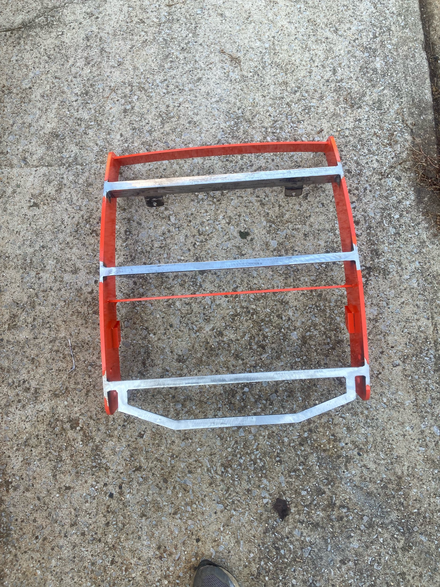

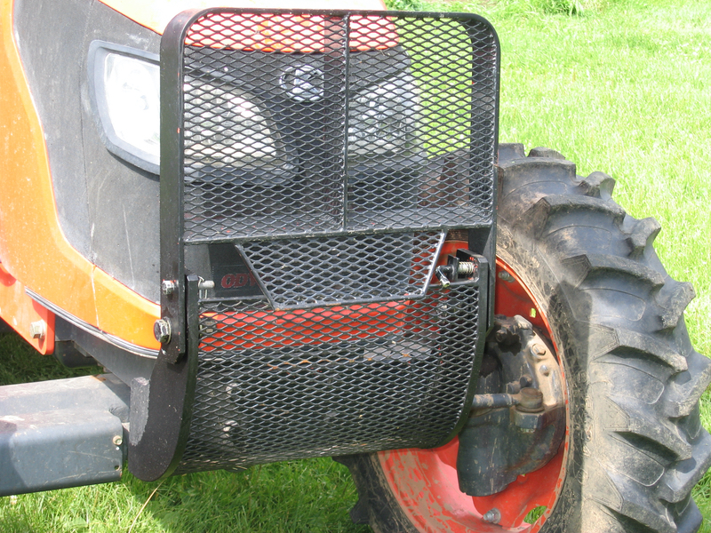

I took my OEM grill guard off and took it to a local welding shop. A young fellow there worked this up. It's saved my tractor a couple times - that I know of. I pull the locking pins - tip it forward - then I can open the hood.

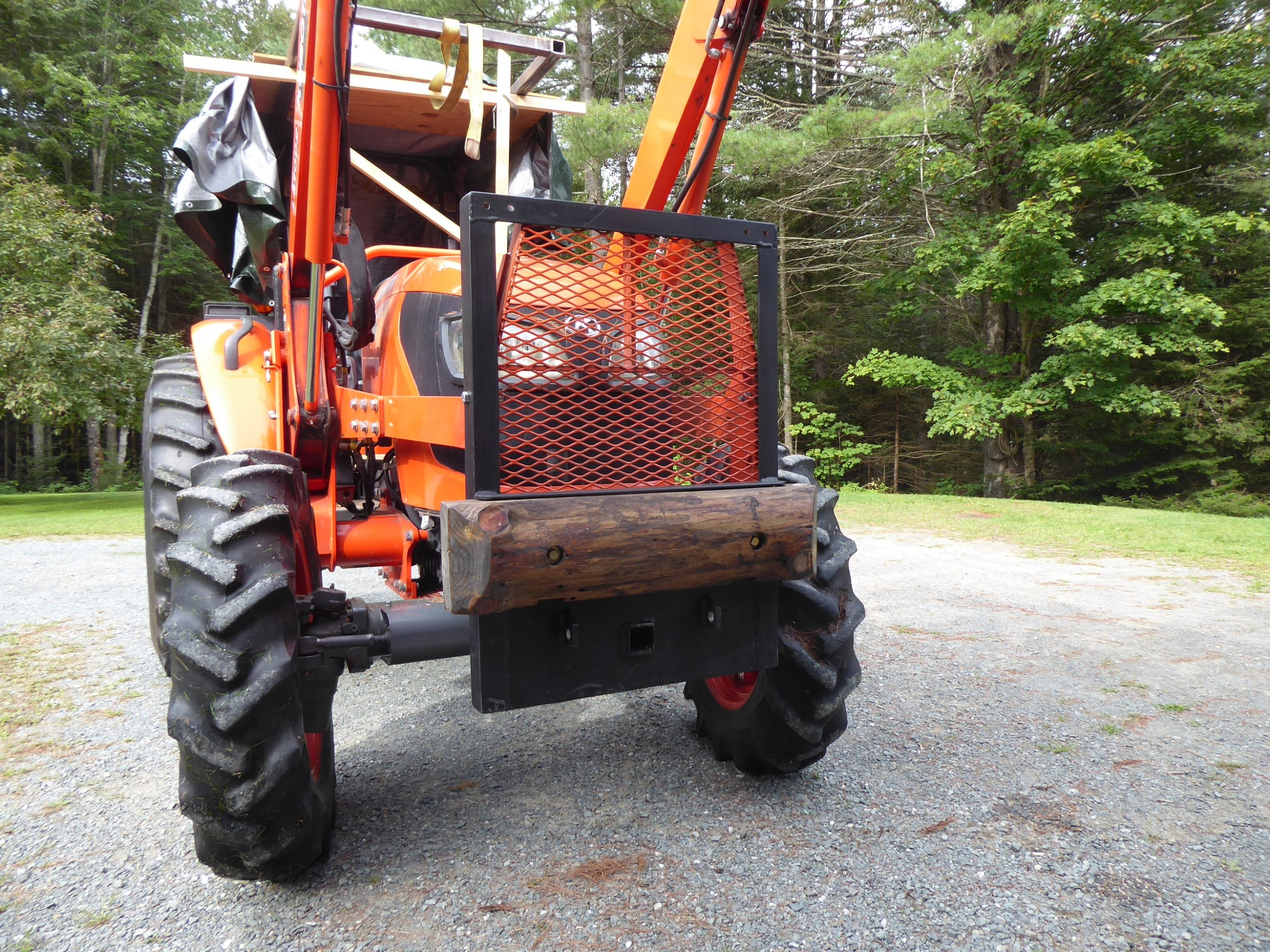

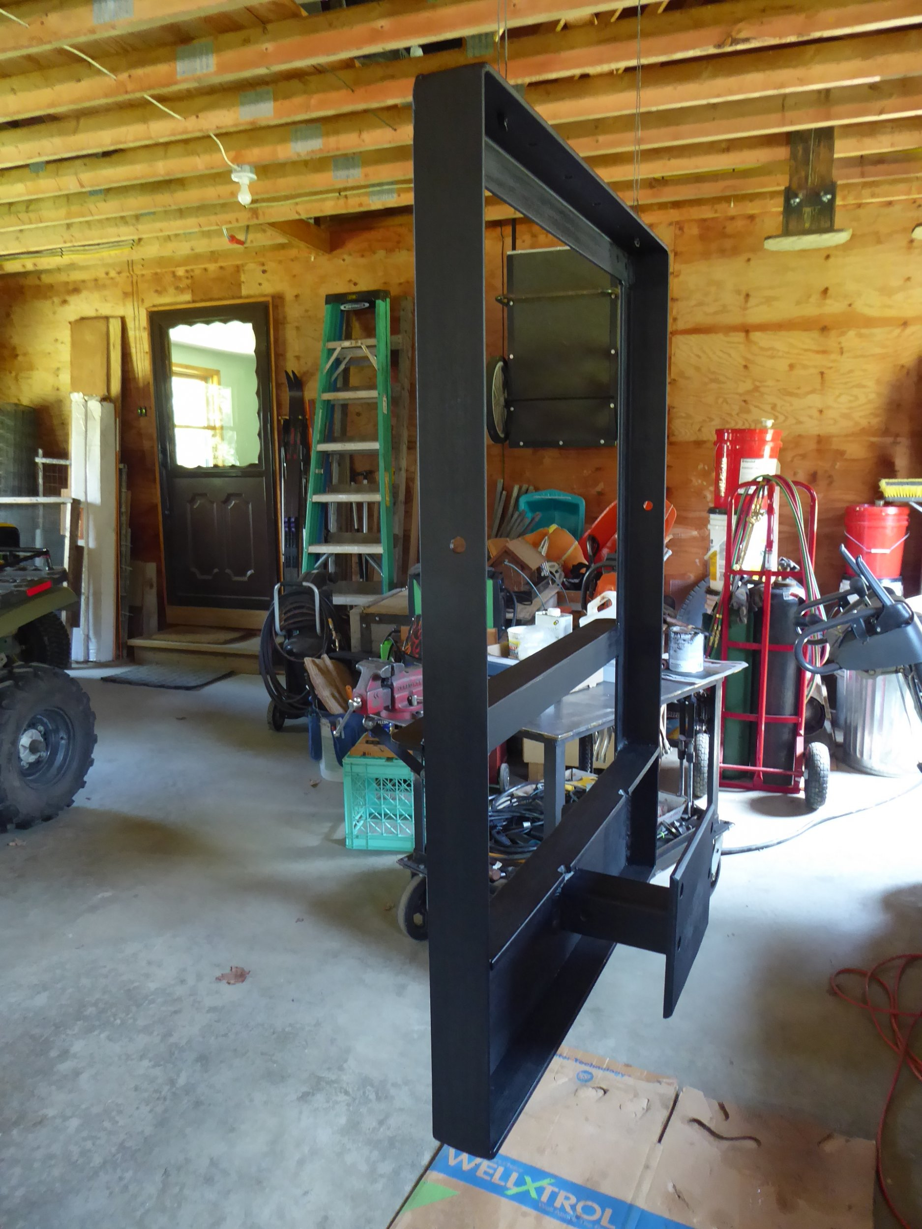

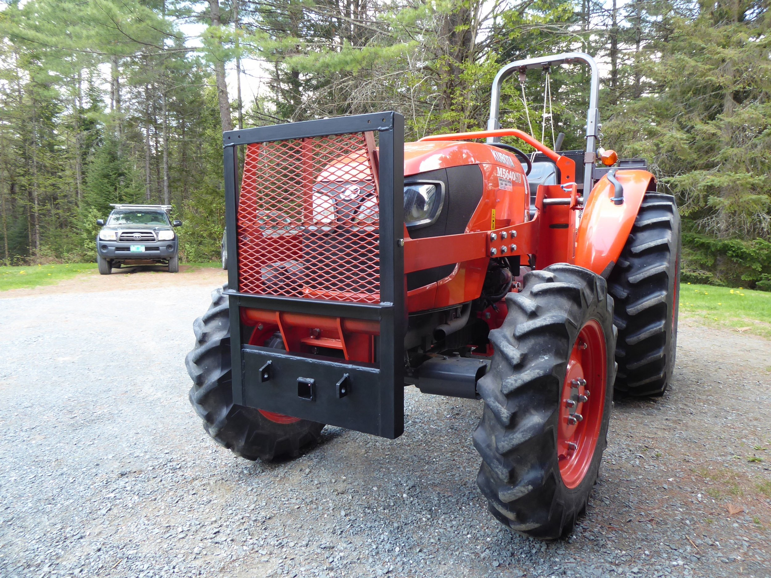

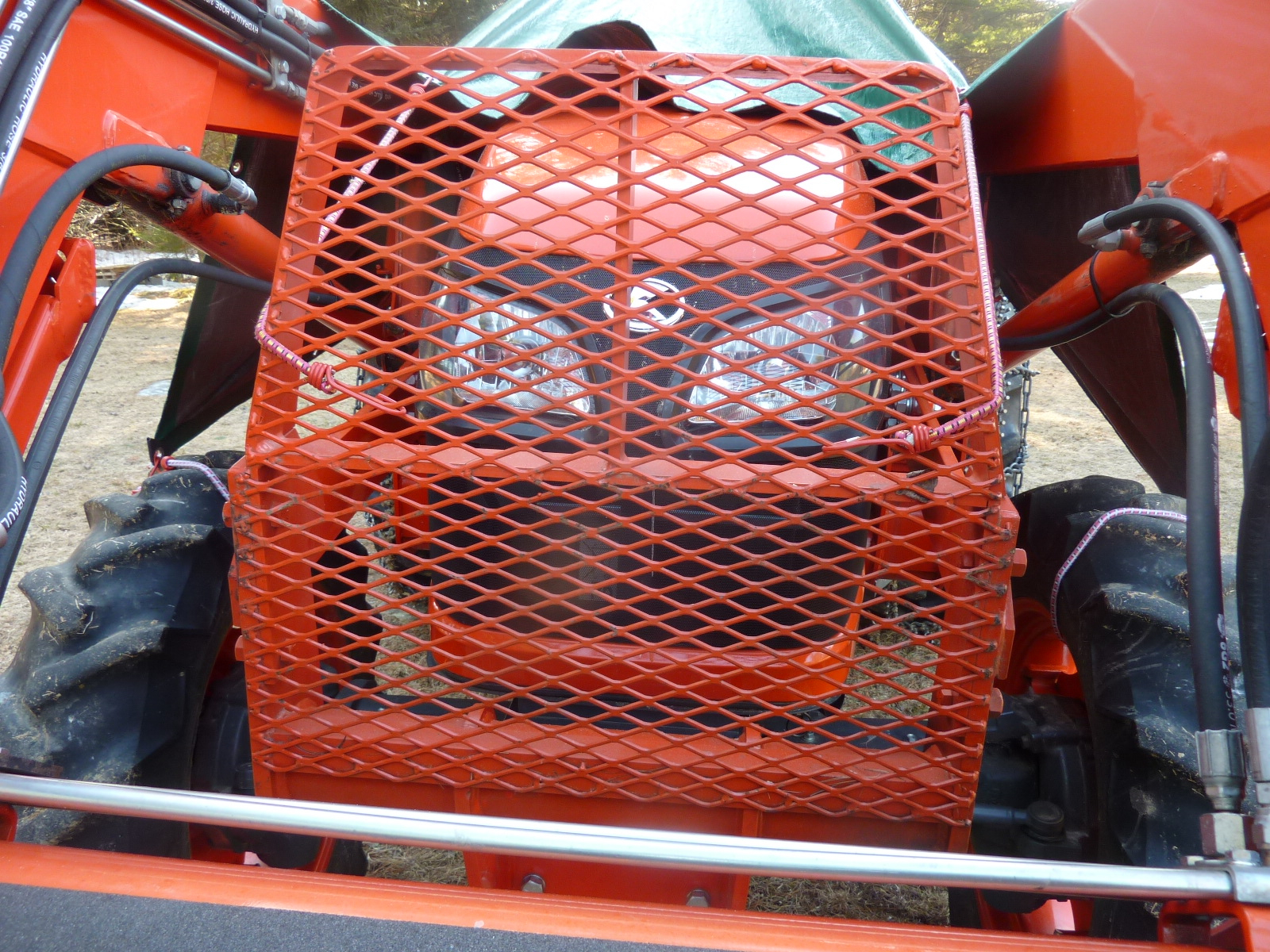

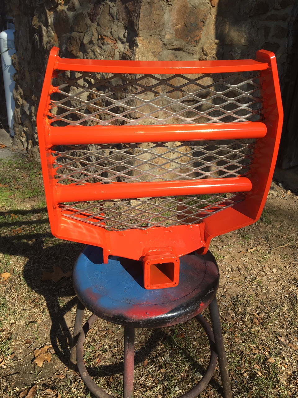

I did like oosik and put an expanded metal screen on the OEM guard that was part of the FEL frame.
Then last year I improved the lower protection and added a 2" receiver. This also gave me a mounting spot for some limb sweeps.
Made a bumper out of a chunk of log

That guard looks great! The bottom looks as if it will protect the bottom of the tractor (bush hogging a an overgrown pasture it would be helpful)

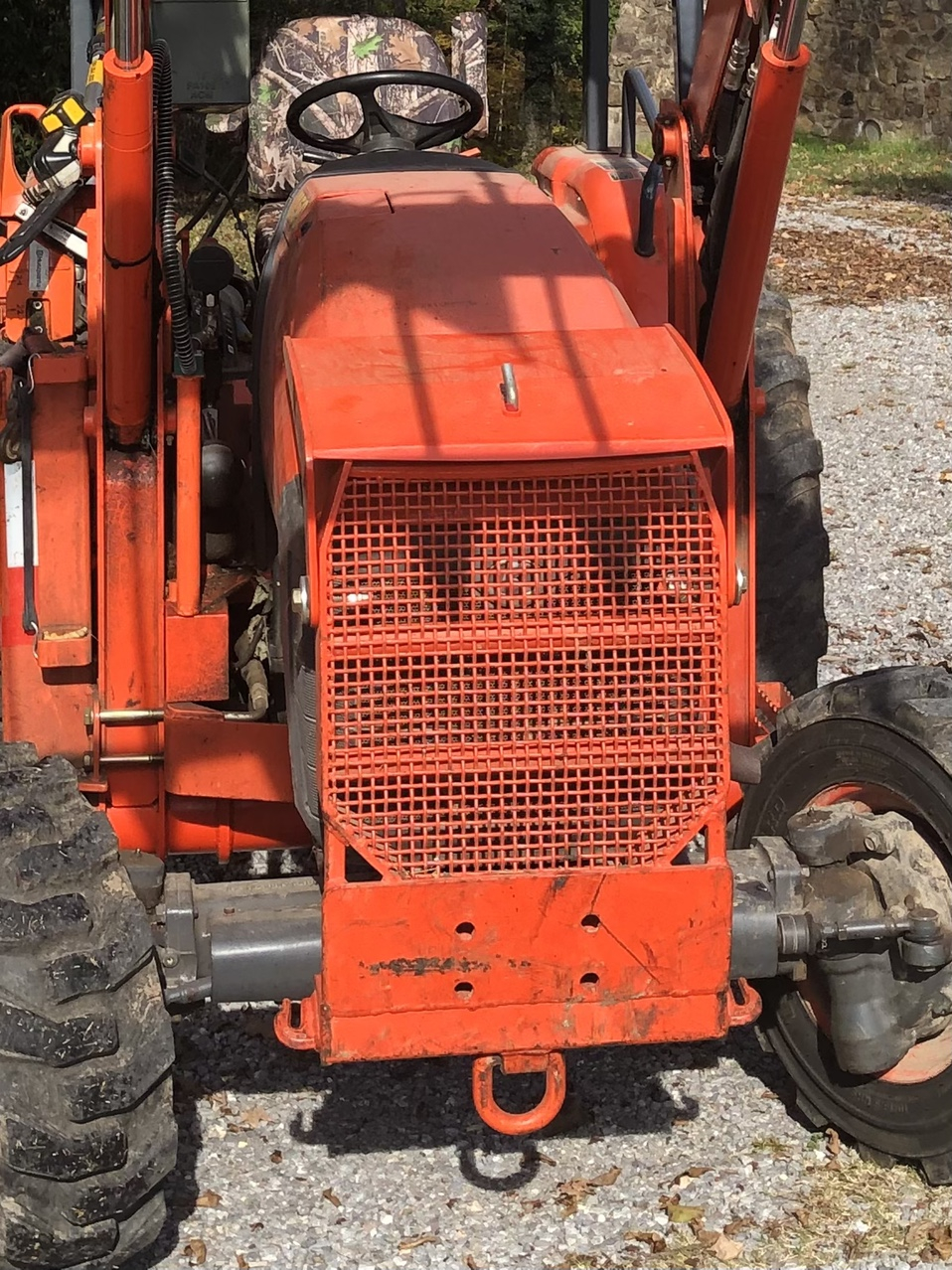

3x6” rectangle tubing and 7” x1/2” plate give lower grill and axle protection. Also a good time to add hooks or rings. Good tie-down points.
Got the 1” ring for $6.80 from Amazon because the bag was damaged and dirty.

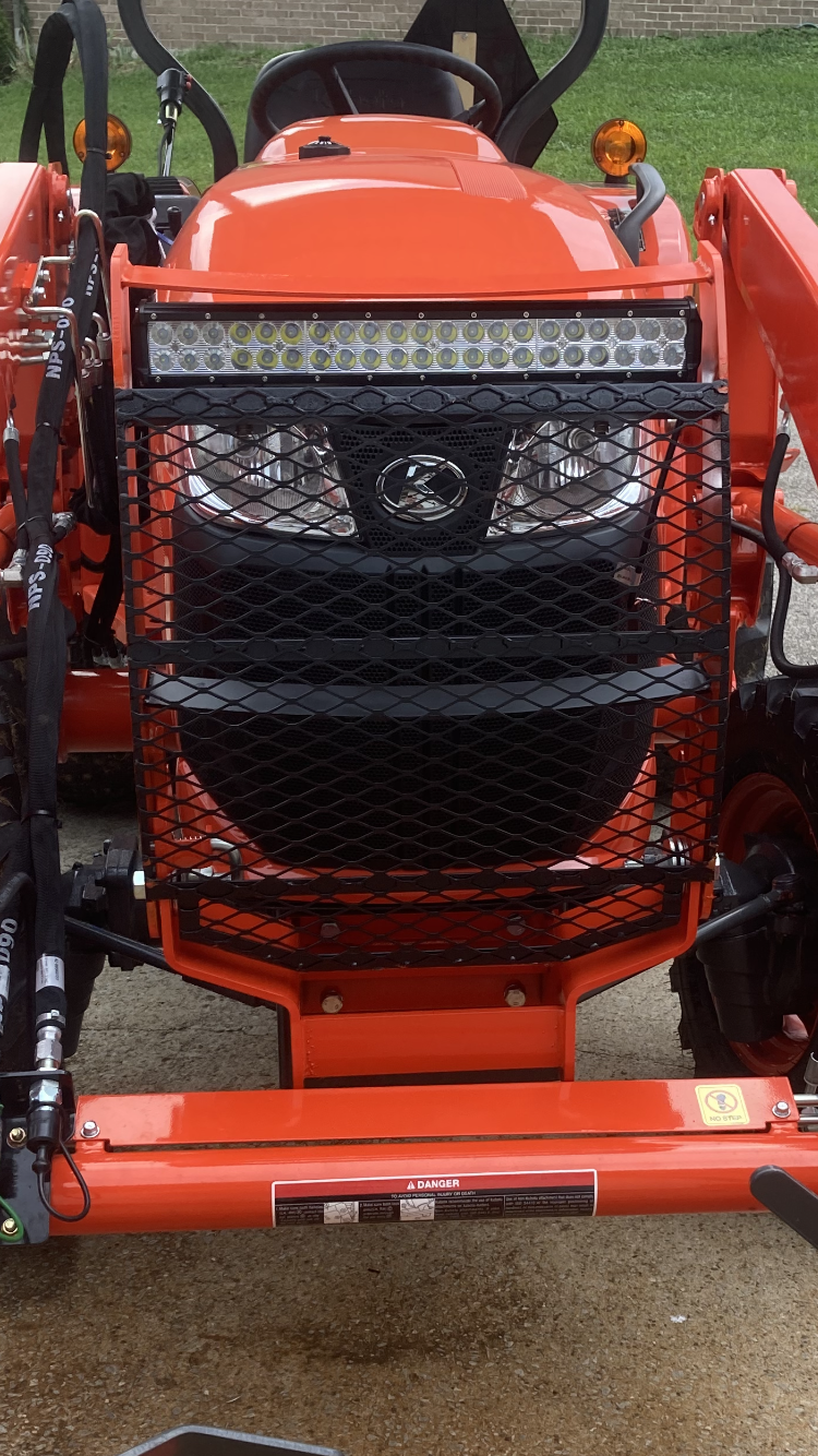

SS expanded metal drop ($4) from scrapyard required little cutting. 3x5” angle at bottom keeps stuff from coming up to grill. So far the receiver hitch wasn’t worth the effort.

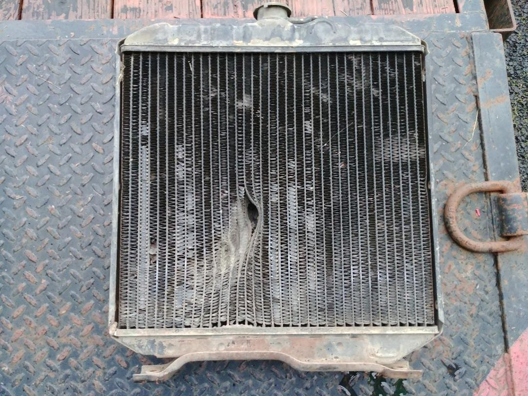

Local fac shop made this for me when I had my tractor in for some other repairs. I asked him to come up with a grill guard, and that's what he built. I think it has a sort of Mad Max vibe. I had it added after a branch on a log I was picking up with my forestry grapple pushed in the grill, stopping just short of punching into the battery or radiator.
