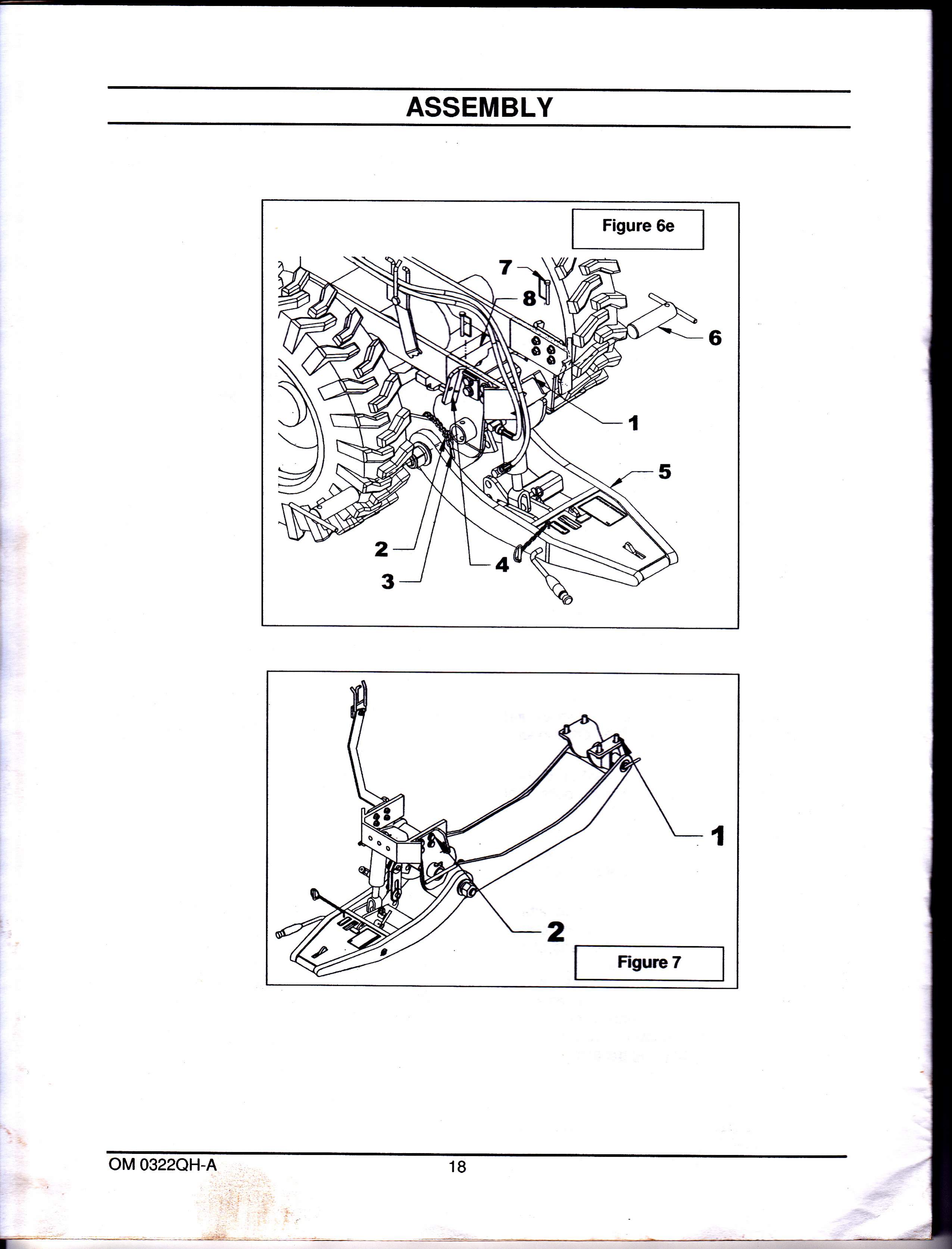

dsmiley. This is the link I wanted,Thanks. They may make different sizes of subframes for large and small hp.I'm going to try and enter a lineart drawing of the subframe and plow from my manual.lt190b

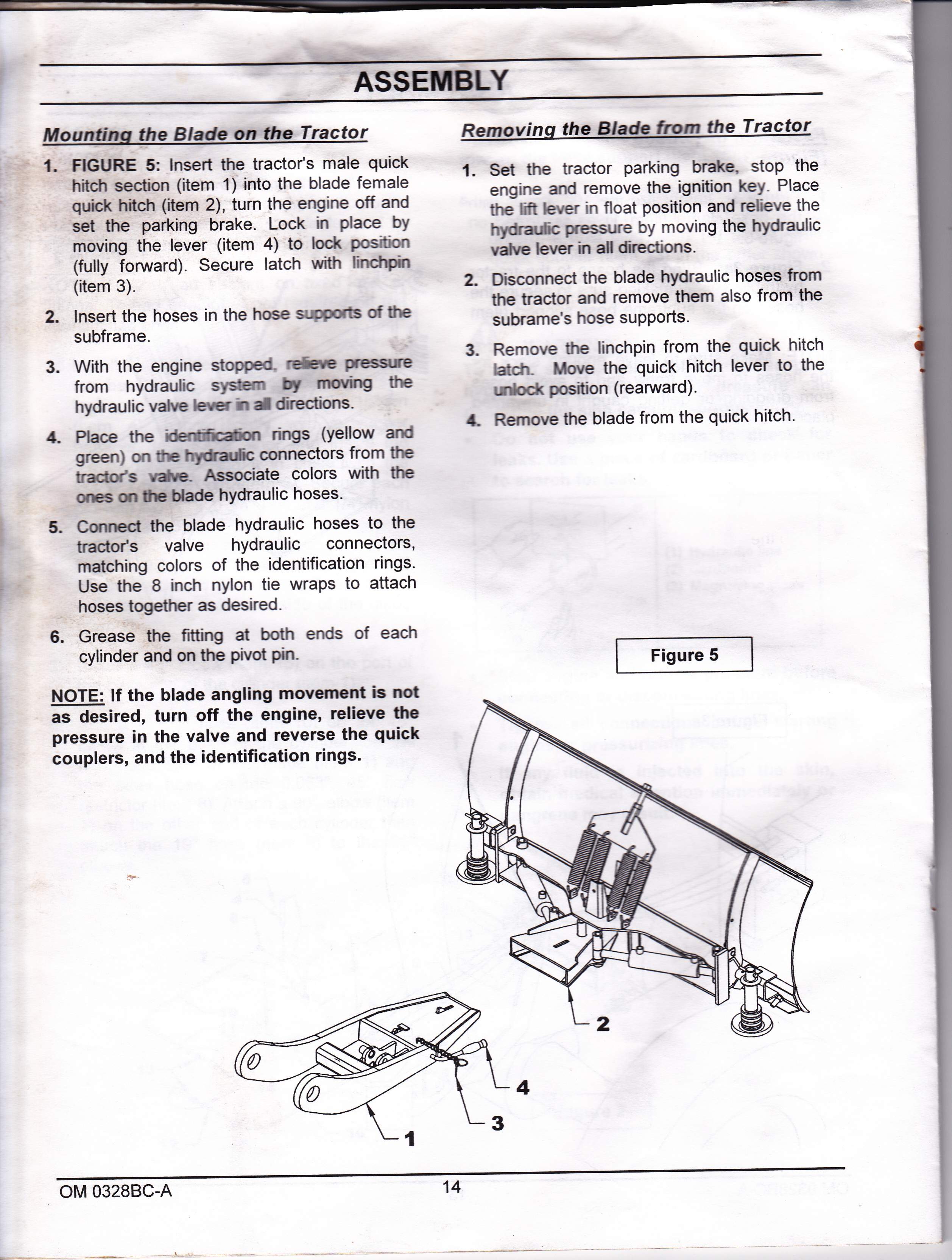

This is a line drawing from my subframe quick hitch manual and a rule measurement I took across the female opening of my mounted snow blower. It was from outside to outside and is probably within 1/8".
Hope this helps.
Dean

dsmiley Where/how did you find the Rad Tec link? I meased the opening on the blade, 11 3/4 x 2 1/2. The reason for my search is I want to be able to use my blade on a different tractor. Knowing that and wheather a subframe is built for a particular tractor will help in my shopping. lt190b

Well, I was looking for a used front blade for my tractor and I figured that there might be one supplier of blades for a number of manufacturers so I wanted to know what color other blades might be. Then I noticed the similarities in snow blowers between some different makes and went searching for the manufacturer of my snow blower, a BX2750D. That's how a found RAD.
I agree with your thought that the size of the male and female parts probably change with tractor size. Mine is a scut, yours is larger.
Good luck.
