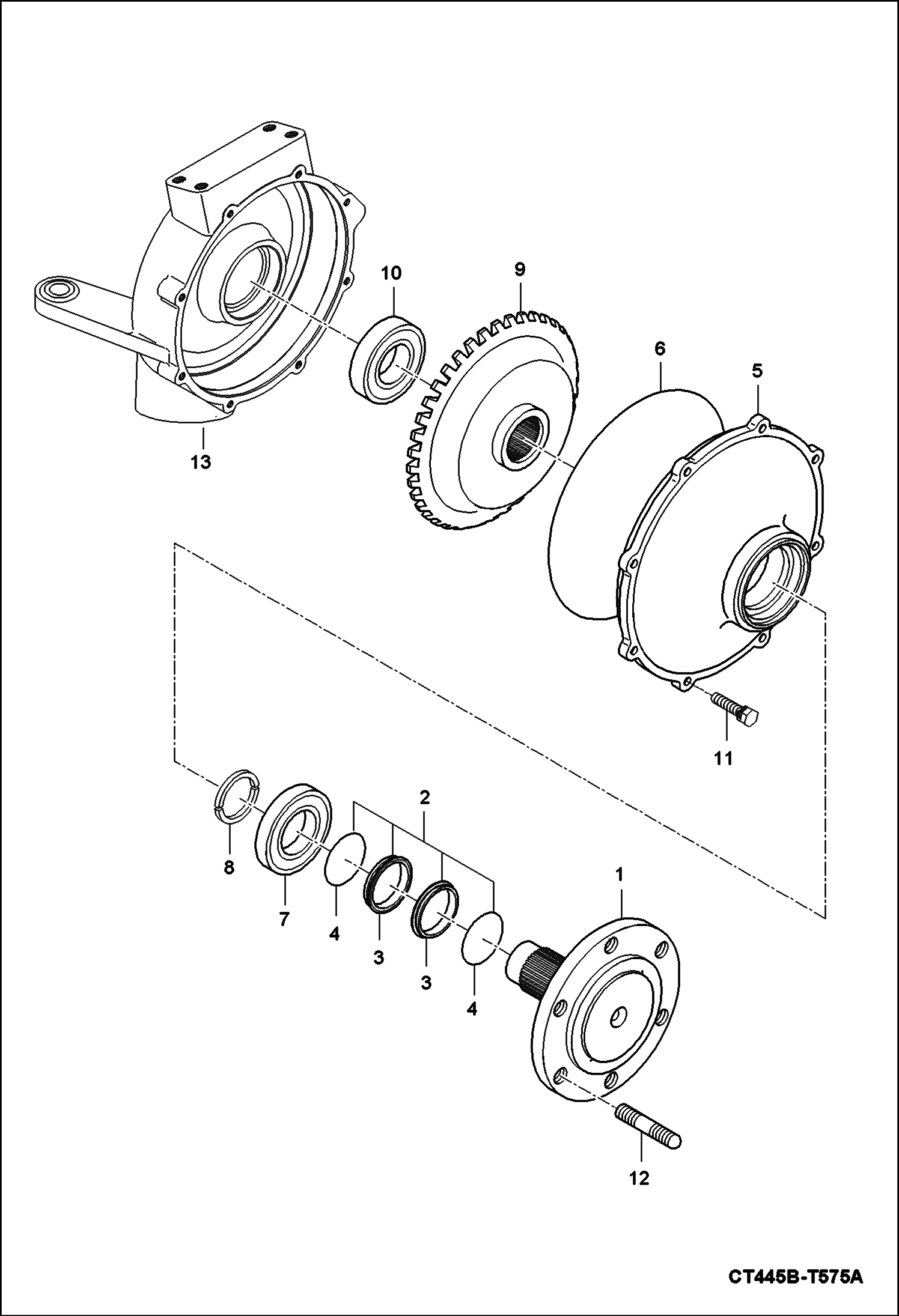

As the subject says, think I blew a seal (haven't looked well yet, oil all over inner tire) wondering has anyone replaced one and difficulty level? Done it on cars many times never a tractor though. Hate to have dealer do something that could be done at home. CT335 2010 FYI.
/ Front Axle Seal Replacement #2
Are you thinking it is the knuckle seal? Reference numbers 13 & 14 here. At home is very possible, sorta depends on your mechanical abiility.

OK, so after some more investigating (still haven't taken anything apart as I'd like to get the parts ordered so I can fix it at once), in any event....it looks like #16 is what I need, but they also don't show the bottom/end cap that you pry off....In another video of a Kubota I think, that cap looked like a seal as well, whereas 16 says a plug and not a seal. So the question is, does anyone know where that bottom cap is in the drawings or a part #?
/ Front Axle Seal Replacement #8
It is #16. #1 in figure 40-80-18 on this drawing out of a CT235 manual, I expect yours very similar.

OK folks...think the problem just got more expensive....turns out the issue is in the following: Front Axle.gif
#7 Bearing was shredded, that in turn caused group #2 to shred and then the real issue....#1 on the base of the axle shaft there is a small (1/16 maybe 1/8 nick) and (it gets worse) #5 where it seats against #1 is all eaten up and chunks missing.
I could grasp pictures if needed but I think the diagram and my explanation should suffice....the question is #5, that's all integrated as one piece, correct? I can't press out the damaged pieces and replace just them? Regarding the nick on #1, does that nick require replacement of that as well, or can I sand it relatively smooth (ie, take away the edges) or would that ruin the seal for the #2 group.
I think I know these answers, just hoping that someone else has some real word experience.
Thanks
/ Front Axle Seal Replacement #12
Without being there and seeing the parts I couldn't make a helpful comment. Not sure I am understanding #5 integrated as one piece? All those pieces are individual other than the seal.

Thanks...I ended up bringing the axle and cover to bobcat...the axle is good with a touch of sanding to remove the burs, however the cover needed replacement. Essentially after the seals a bearings are removed there is the bearing race and then machined parts that are machined into the cover itself, that's what was trashed, so new cover on order. Downside is a backorder....2 weeks, 10 weeks, no idea. Not good for a guy who uses it to mow his yard every week....
