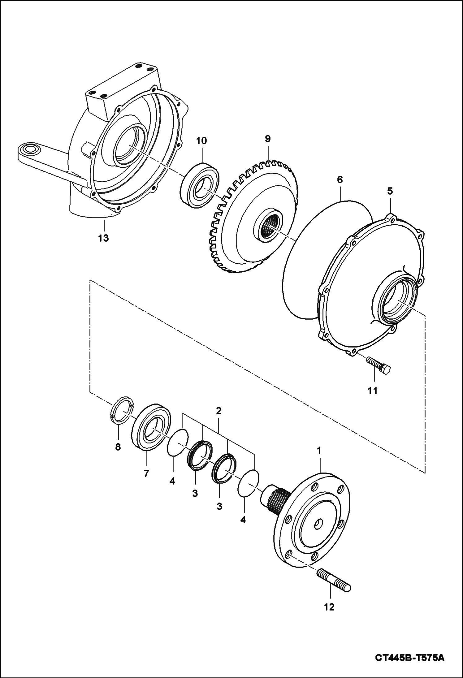

Are you thinking it is the knuckle seal? Reference numbers 13 & 14 here. At home is very possible, sorta depends on your mechanical abiility.

Alright, so here is a question...since I'm leaking out of the bottom side of the bevel gear/knuckle, it appears to have a "cap" that can be pried off and then I assume reveal the seal and o-ring. Everyone I've seen do this is replacing the top seal and therefore has to remove the whole hub from the axle....I'm wondering if I can just go in from the bottom and replace just the seal, thoughts?

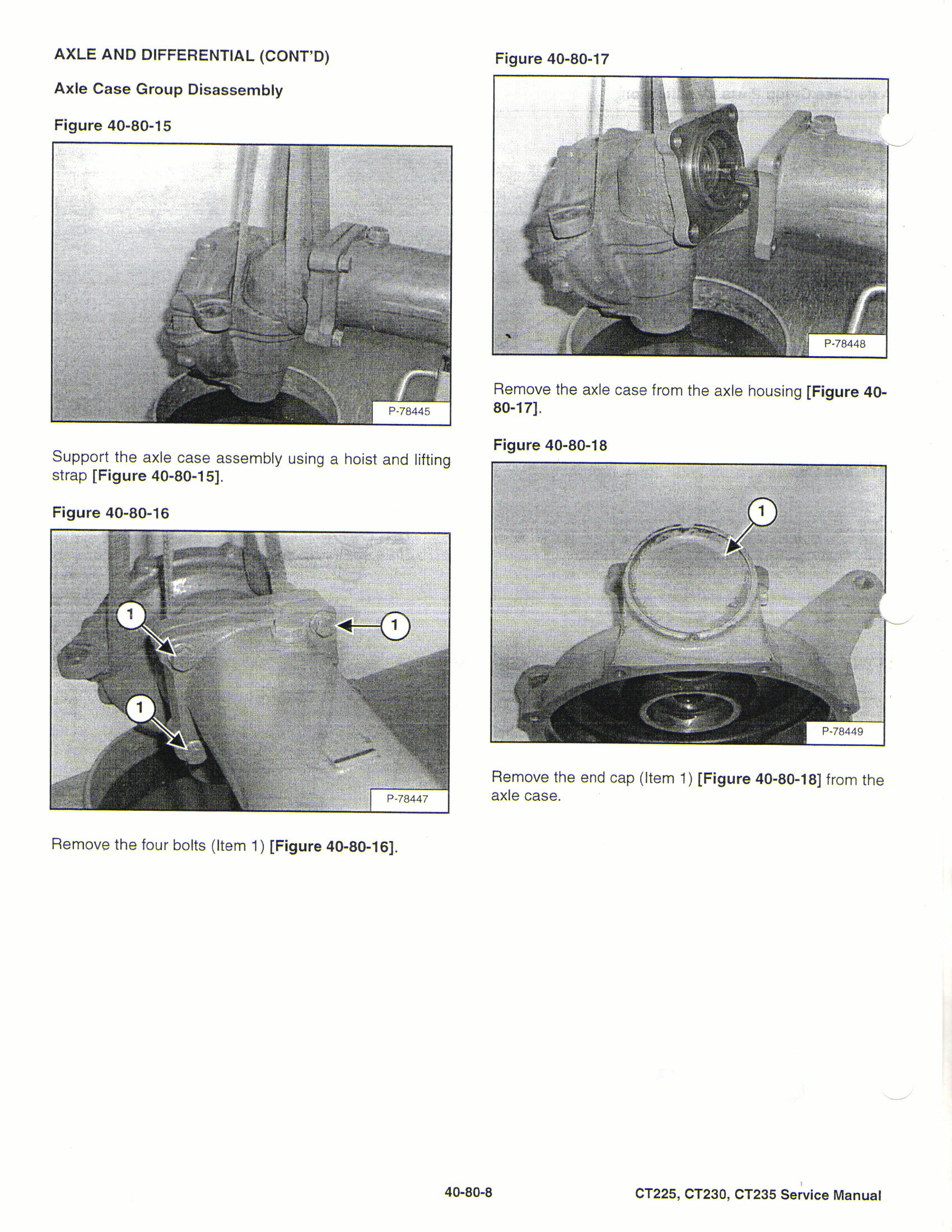

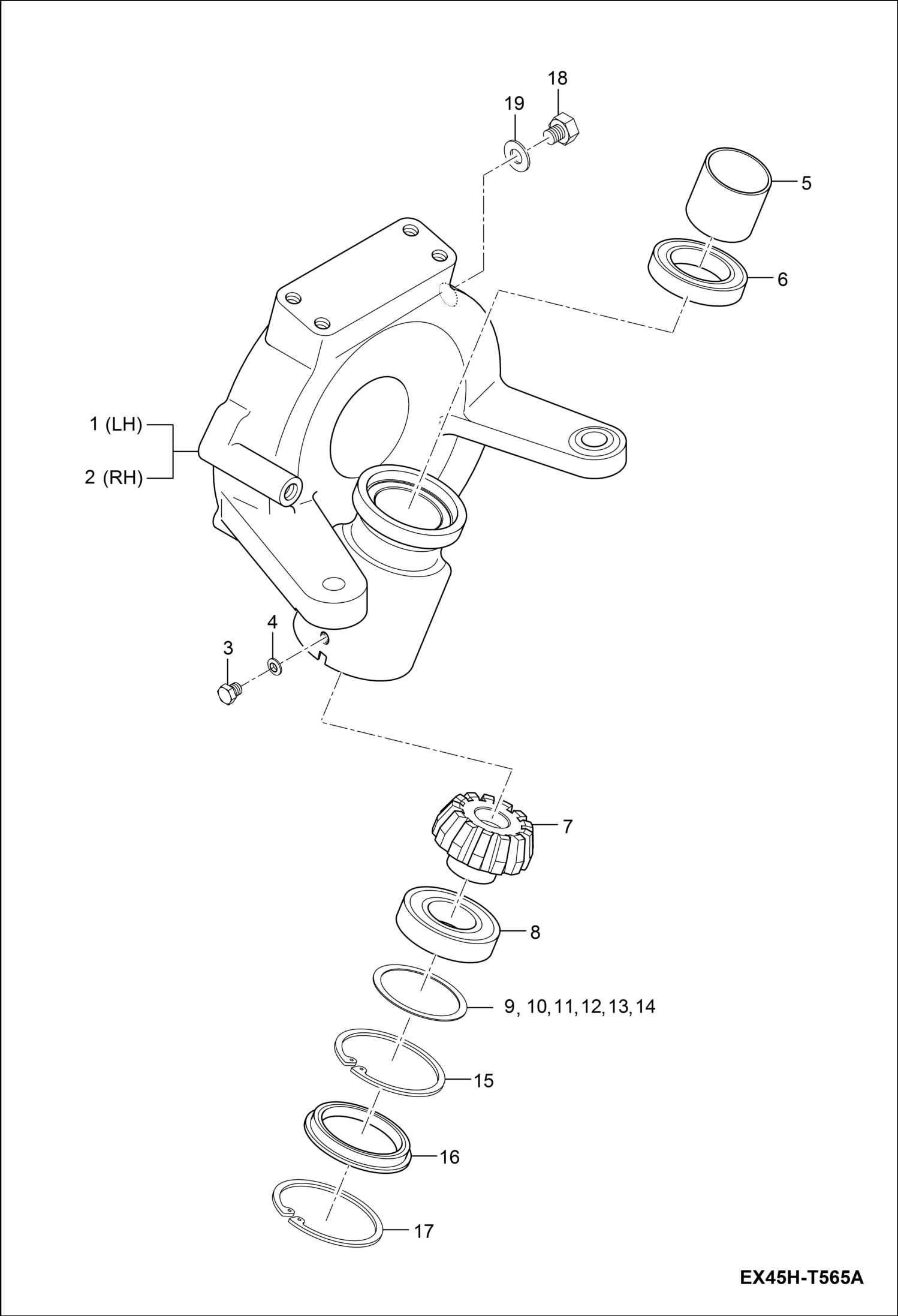

OK, so after some more investigating (still haven't taken anything apart as I'd like to get the parts ordered so I can fix it at once), in any event....it looks like #16 is what I need, but they also don't show the bottom/end cap that you pry off....In another video of a Kubota I think, that cap looked like a seal as well, whereas 16 says a plug and not a seal. So the question is, does anyone know where that bottom cap is in the drawings or a part #?
   / Front Axle Seal Replacement #8
It is #16. #1 in figure 40-80-18 on this drawing out of a CT235 manual, I expect yours very similar.
