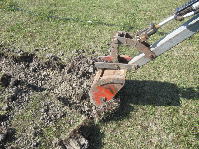

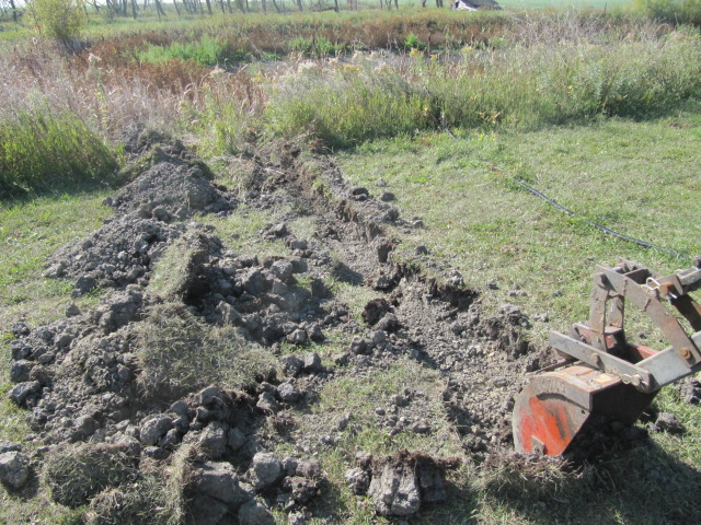

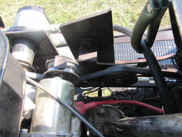

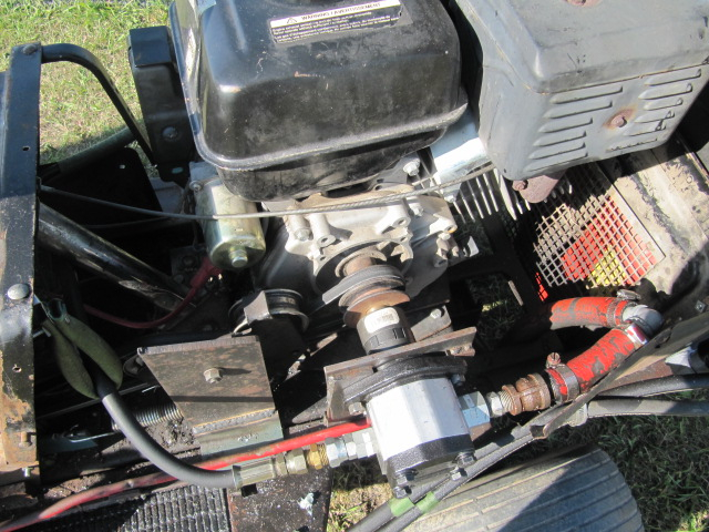

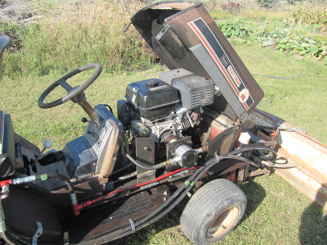

Here are some pix of the trenching I've done so far. Note the lumpy chunks of clay and sod. No sign of moisture anywhere in the trench. The tractor pix show some of the mods I made to get it all working. I was able to move the drive belt and all the clutch hardware above the engine platform from where it had been under it before with the vertical shaft engine.

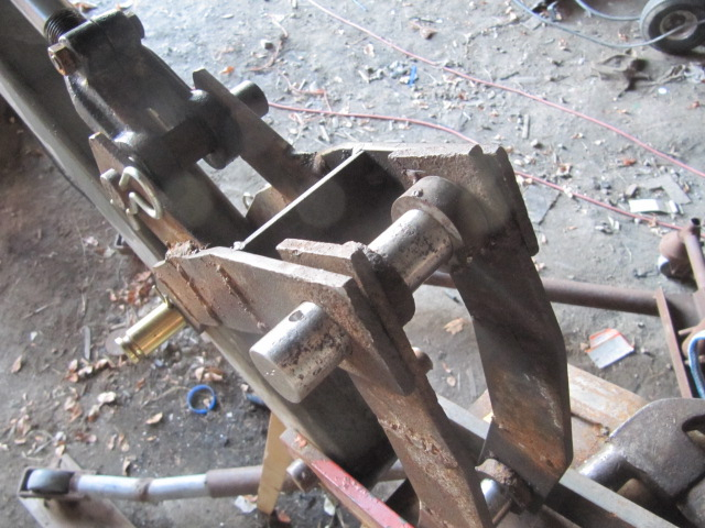

I put in maybe an hour of digging this afternoon. I jokingly told my wife I would dig till I broke something. I should """NEVER""" say that out loud. I had just finished fixing something I broke for the second time. A street elbow on the cylinder for the boom was jamming up against the back wall where it is mounted and finally broke again. Easy fix and back to work. Till the hinge mechanism for the bucket (you can see it in the second pic of the above post), broke open - I think because I had neglected to properly weld the bracing between the sides of the arcing arms of the mechanism. Actually, I'm surprised it took this long for the weakness to show. I'll do that bracing better this time and give it more than a light tack weld. And no more joking about stuff like that! Those "jinx demons" have sharp ears!!

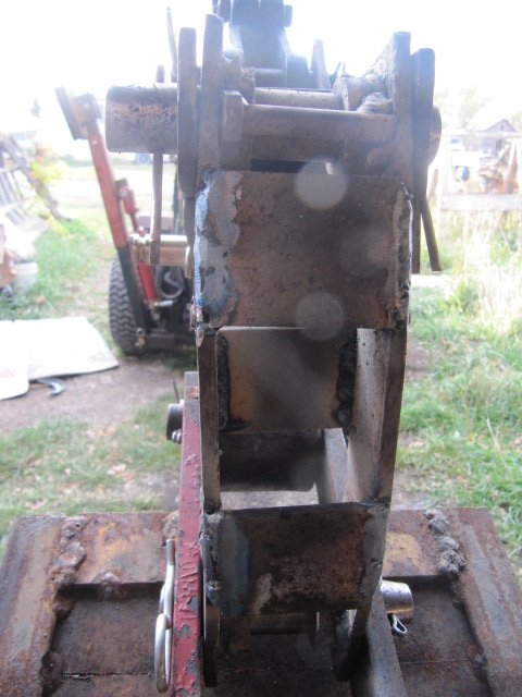

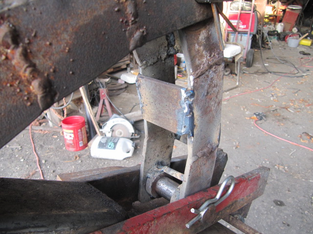

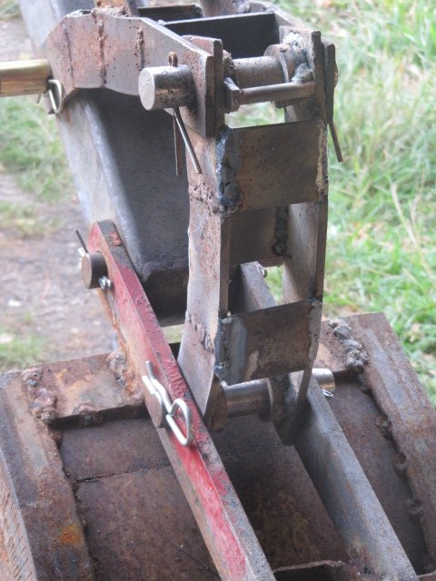

Here are pix of the repairs I made to the bucket swiveler. Sorry, I neglected to take any pix of the damage before I straightened things out but it took a fair bit of beating on it to bring things back in line. The first one shows what it looked like before welding in the bracing. The rest show what I hope will prevent a recurrence.

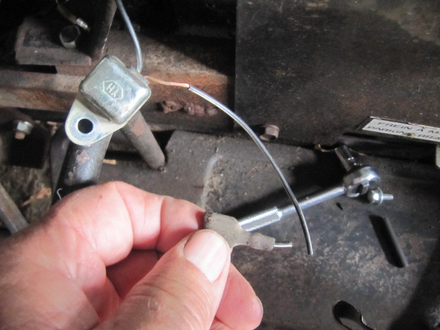

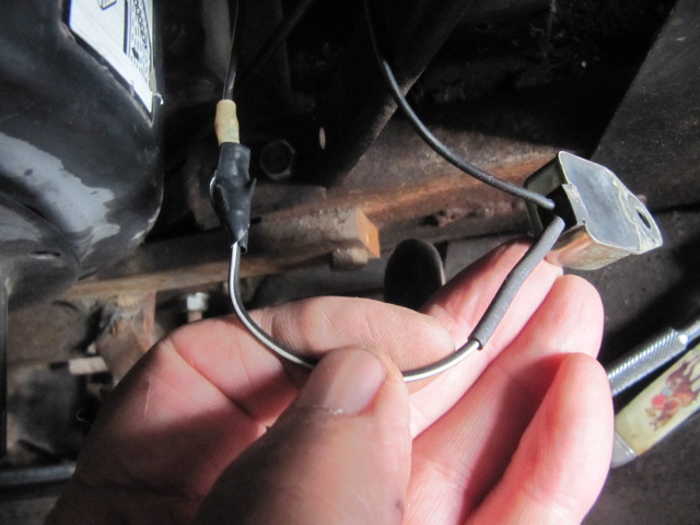

Thanks, I'm hoping to get back digging once the rain we got overnight dries a little. I believe it does have the oil level shut - off and checked for that. The oil level is right up where it could run out if the tractor was tilted a little. If I knew where to find that sensor I could check the circuitry for a possible failure. Another thought I had was could the ignition switch circuit to the ignition module be failing and if so, what to do to test for that and remedy?

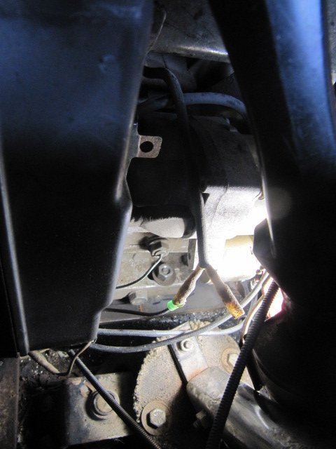

Richard001, thanks for that tip. I decided to start with that and immediately found a loose wire. It came out of a small metal cube shaped device and another loose wire matching the code stripe of the first wire lead to the ignition switch box. Score!!! There was a second wire leading from the small metal cube which lead to the engine block and into what looks like the low oil sensor. There was about 3/4" of bare wire coming out of the metal cube leading to the ignition box (shrinkage due to heat?) but since it was not shorting against anything, I fixed it with good oldfashioned shrink tube. That and a new crimp on end and done. Proof that it was the cause will be once I've done some more diggin'! Here are some pix. The last one shows what I take to be the sensor.

BTW, repairing that broken wire seems to have rectified the stalling issue!:cool:
