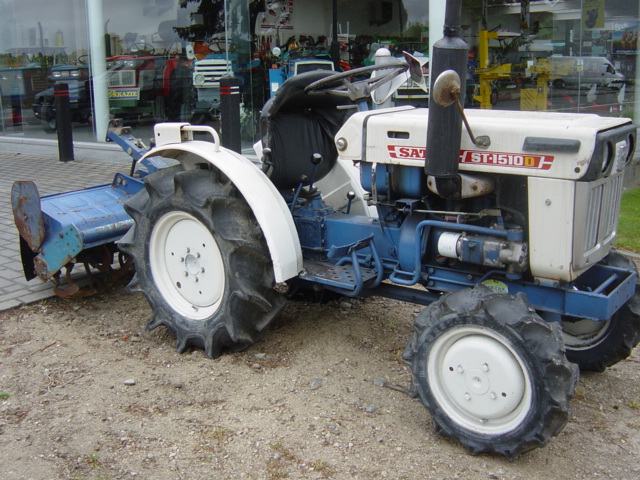

A few pictures to show how the small Satoh tractors for the Japanese markets, much alike the US 'Beaver' models, became Mitsubishi models after 1980.
These pics come from adverts on the Net (apart those showing my own St 1510D), I hope their authors won't complain about my using them.
Please react in order to complete this attempt.
PHIL24
Satoh ST1510D as imported from Japan

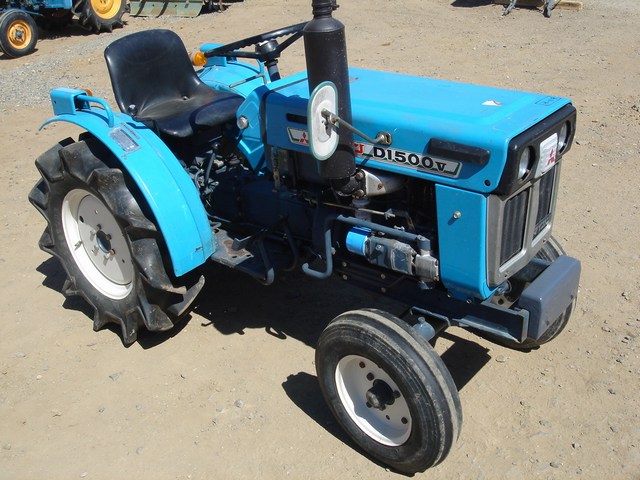

Mitsubishi D1500V: apparently totally similar, rebadged

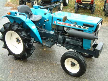

Mitsubishi D1500V: new wheel rims & fenders

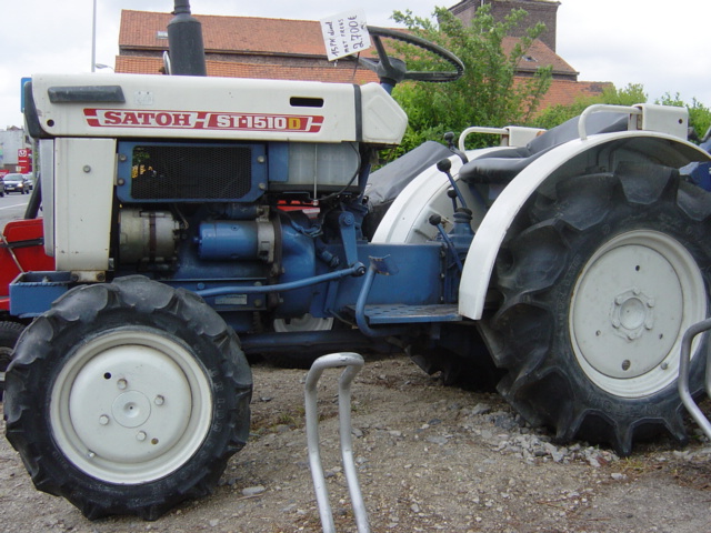

Satoh ST1510D

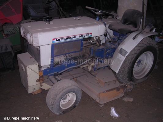

Mitsubishi MT372: openings in hood, hour meter on dash, modified grille+headlights surround+hood end
