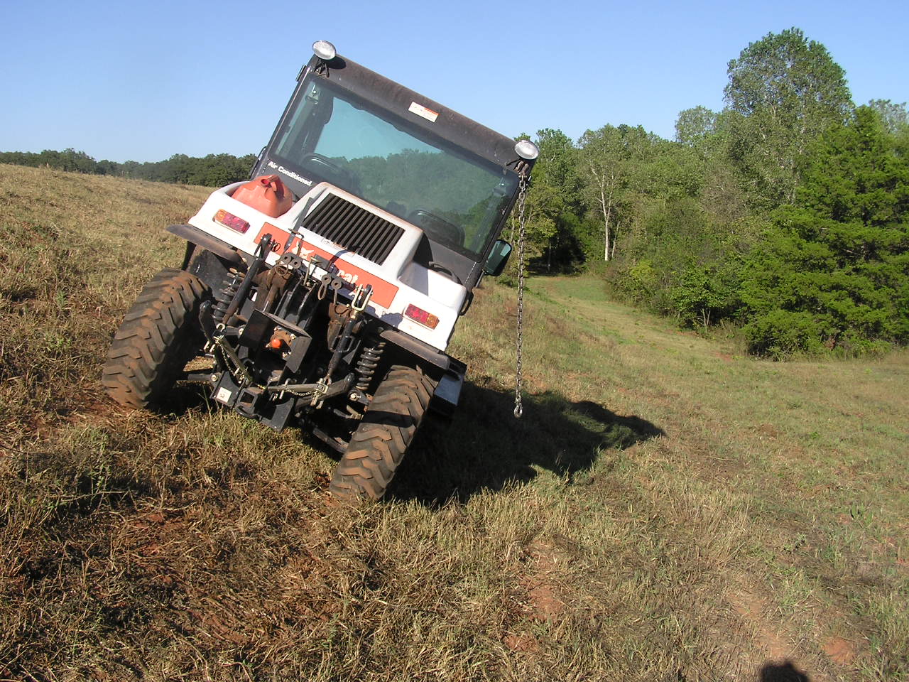

I got busy with honeydos and didn't get on the hill or jack up the tractor. Maybe next weekend or one eve this week I'll try to tip it over, just for you guys.
Thanks. :laughing:

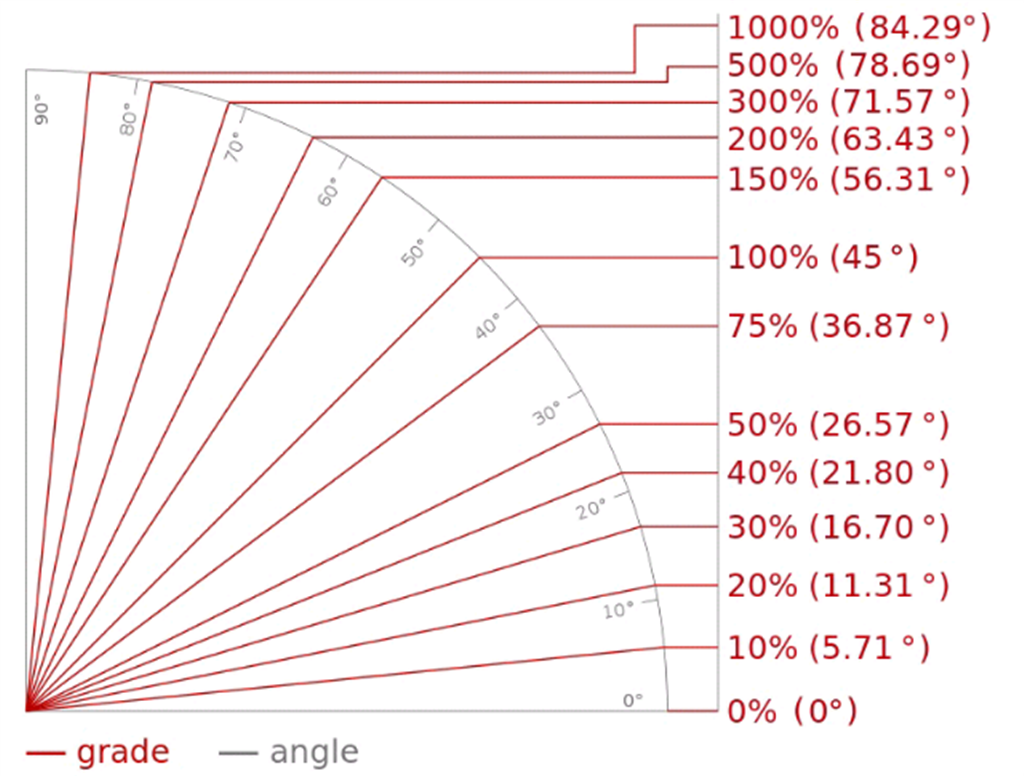

This is a 50% grade.
