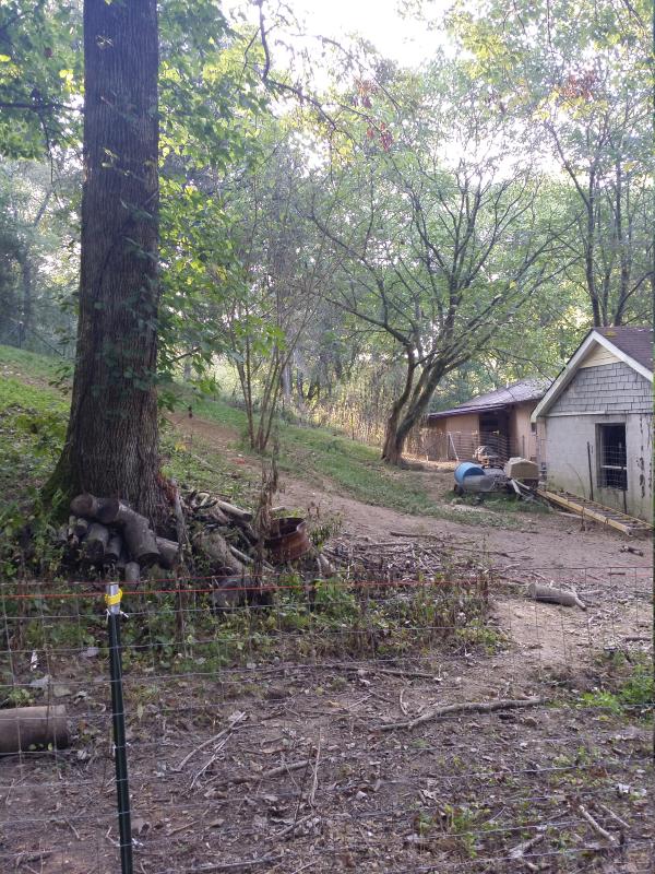

I think I understand what you mean. I'll get some pictures this weekend and make some scribbles in paint to illustrate. I think the high point you mention is the top of my Chevron. Be it a terrace, drain, ditch, the goal is to give the water someplace to go besides straight down.
Sounds right.
40 deg. for 40', that's steep. :) That 40 deg. angle may be more than you would want to run your tractor at for very long, could get oil starvation maybe? I can't picture how the chevron would be cut in without operating at a steep angle. Maybe it's not a concern.
Do you have any decent size rocks to work with? You could cut a terrace starting at the top, down maybe 1/3 of the total vertical height, with the terrace wall sloped enough for rocks to lean well into, and put a layer of geotextile fabric on the terrace wall first to keep the soil from washing through the rocks. Repeat that two more times to the bottom.
The tendency is probably to make the terraces too narrow in width. You want enough width to safely access each terrace with the tractor for mowing and maintenance.

Reality check. The Swanson Angle finder says average 20 degrees, feels like 40 though.
I hope this illustrates the Chevron idea.

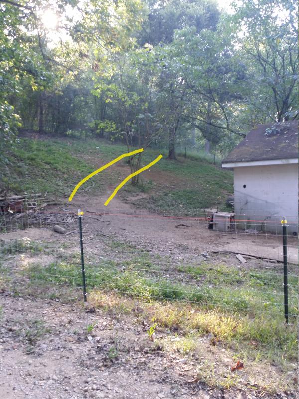

I would get a box blade without the ends and run a single drain about 8"/12" deep diagonally down the hill above the tree between the 2 yellow lines. Unless you get 1"/hour rain fall I don't think you need more.
I have a steep track (measured at 29 degrees) and over the years I have found this is adequate. The drain has stood the test of time and only gets an annual pre winter clean out.The steep slope on the high side can collect a lot off water, but due to rapid runoff the drain surprisingly effective.

I agree. Angled terraces will handle the surface water nicely if you can get a deep rooted grass to grow to hold them in place. They are easy to create and will look like part of the landscape - not something you have to mow around.
   / French type drains on a steep side hill #19
When I was working landscaping we did a few swales like this, Make sure you over engineer it. Larger pipe or more pipe, make sure its slopes the way you want it to and pay attention to where you are diverting the water to, you dont want to make a bigger problem by channeling all that water someplace else.
   / French type drains on a steep side hill #20
Forgeblast makes a good point, if you channel the water from the slope, make sure that you have a prepared area where the water drains to a flat area so it can spread out without washing a gully. You may have to put in a large rock covered area to slow the water to an acceptable velocity so it will drain and spread out slowly.
