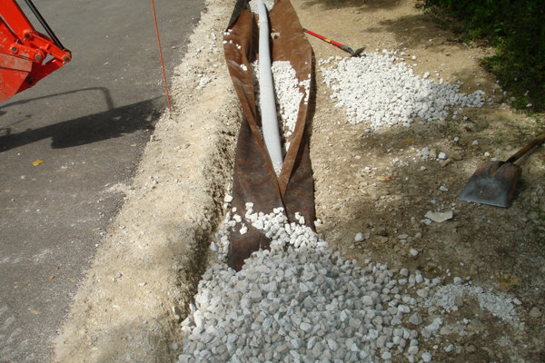

This was part of a large drain project I did which might show what some others on have described. This was a high end job and worked out very well to protect this really long asphalt drive from future washout. The pipe is 4 inch smooth bore (about 220 feet installed in this part) which is semi flexible and also used schedule 40 to the catch basin, under the concrete trench drains across asphalt drive and across concrete pad up top of the one photo. About one foot of #2 limestone was used on top of the four inch wrap. #57 limestone was used inside the wrap.

Nice-and it looks like that the drain system you used across the road was one of the precast polymer types? what brand?
