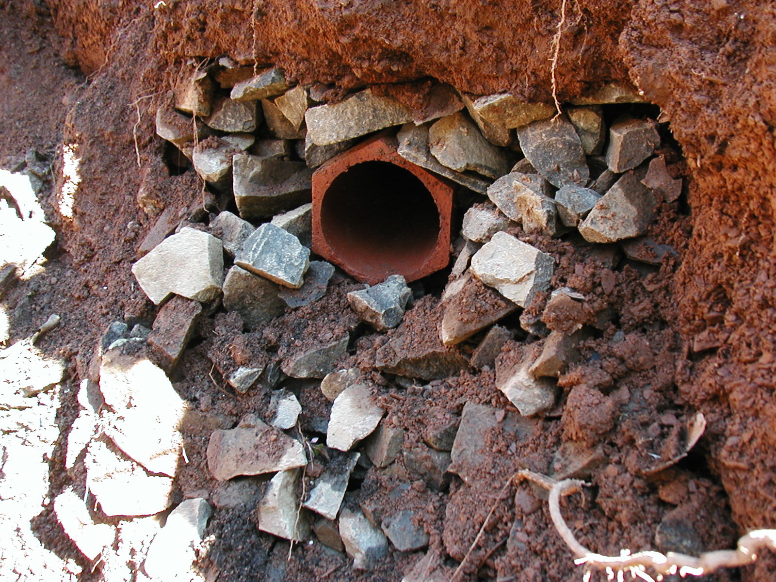

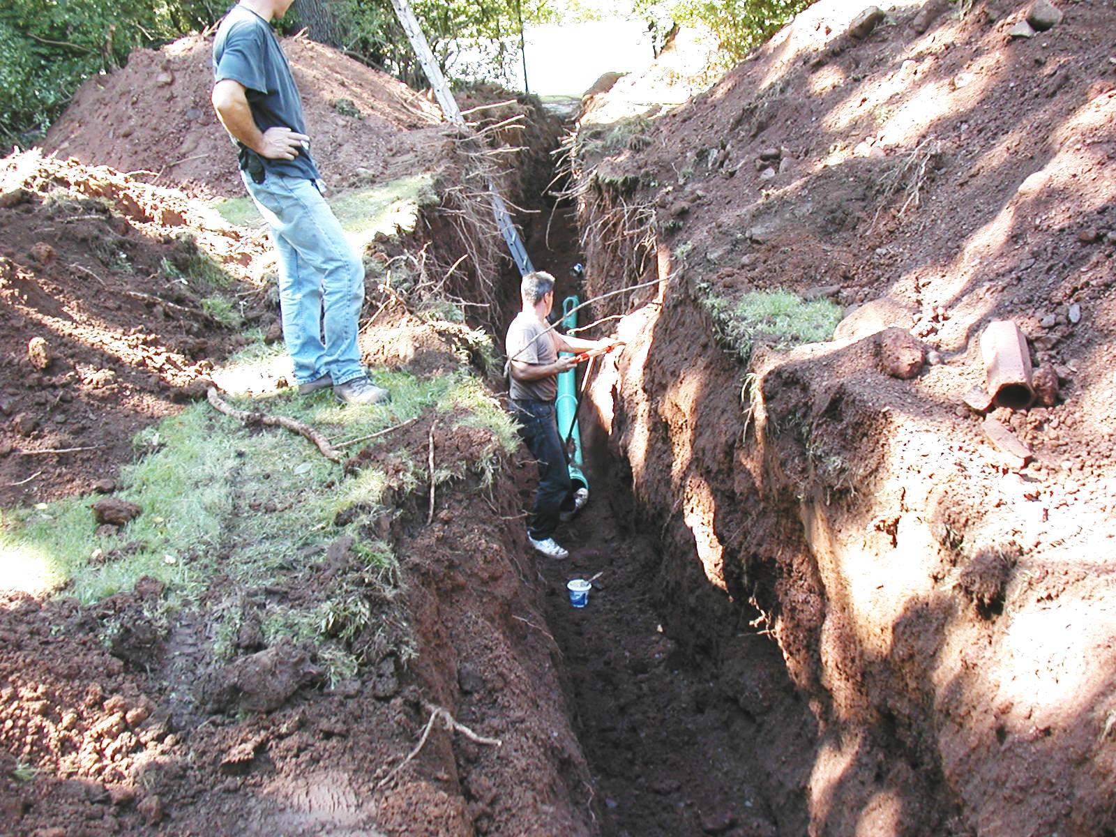

The 70 year old house I bought with 2 full and 2 half baths was still using septic system even though the elderly guy I bought the house from didn't know it, He had lived here 20 years and assumed the house was connected to city sewer. He never did anything with the septic tank, he lived by himself but had many visitors that lived with him for extended periods of time, and the original family lived 50 years here, don't know if they had any problems.
I wasn't gonna trust the septic system with family of 5 so I connected to the sewer, when excavating across the front yard we crossed a leach pipe about 100 ft from the tank and found a dry well at the end of the pipe, water had never even made it that far down the pipe, it was unstained and perfectly clean. I was shocked how well that system must have been constructed.
I pumped the tank which was only 4'x4' and use the system for storm water management now.
It's amazing how efficient a well designed septic system can be, not true with the house I grew up in on a postage stamp size lot, had an overloaded undersized system for family of 7, had to have that thing pumped every year. Just before it failed completely I remember the dark green foot tall grass growing on top of it in the middle of the winter!
