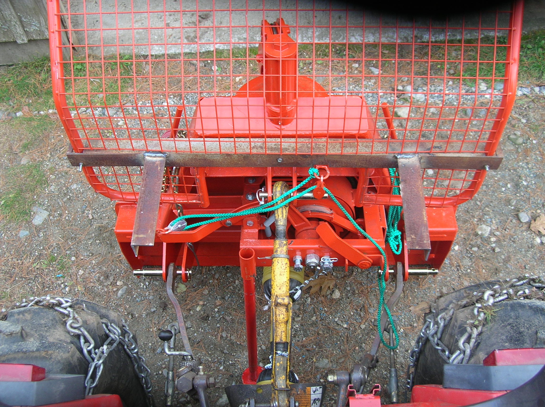

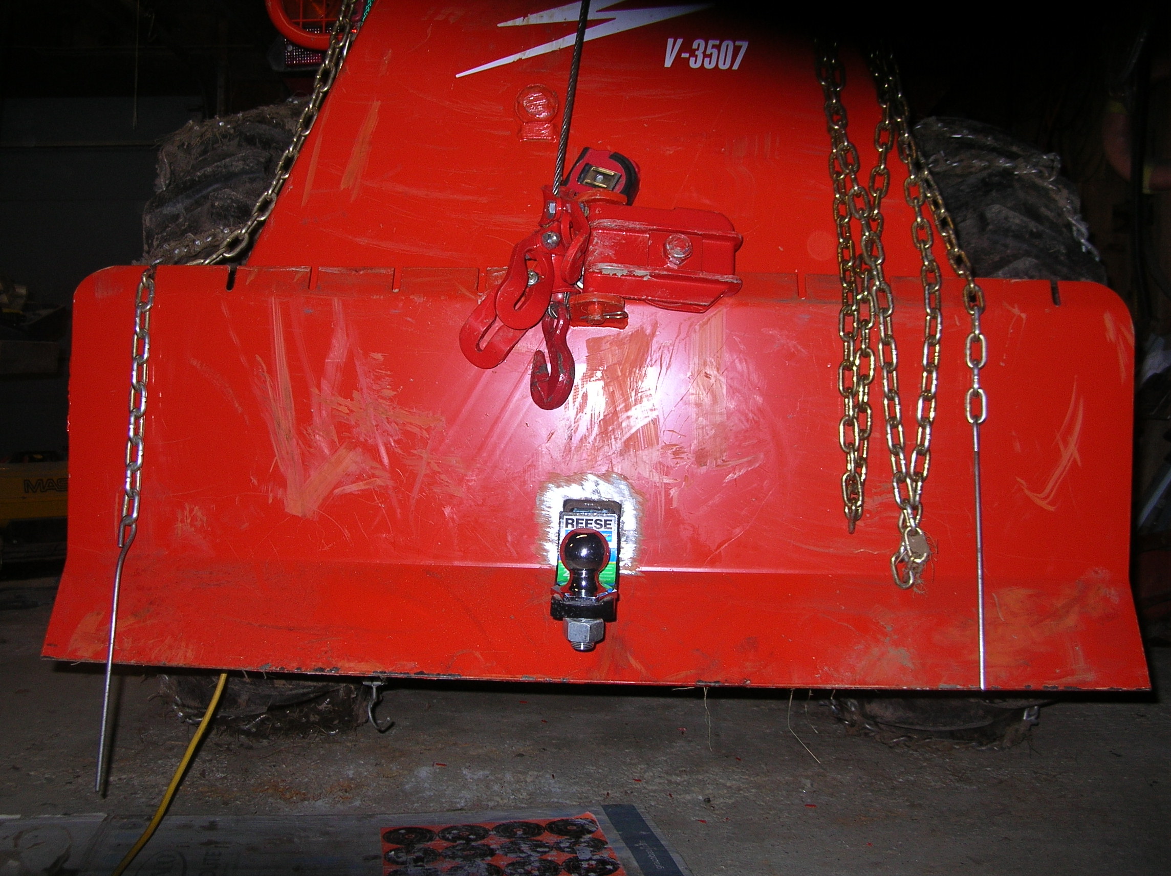

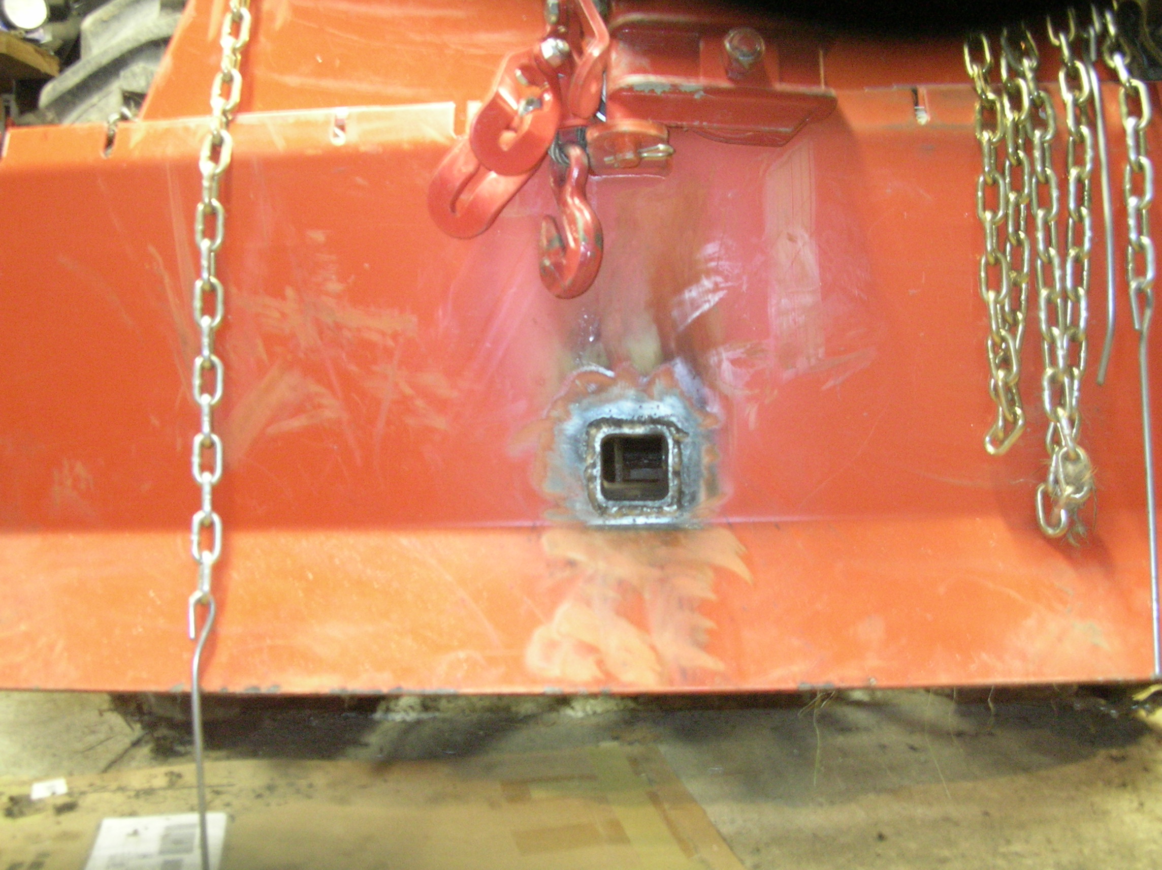

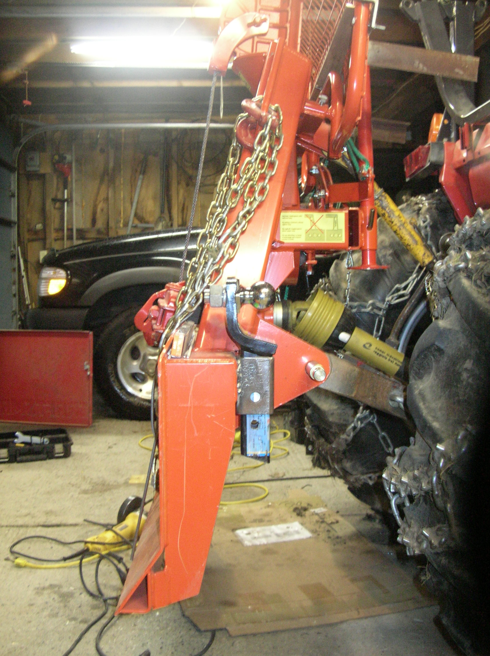

i got the hitch and storage rack made. i have the rack for the box made. i'm looking for metal to make the box. i'm going to keep it light. some pic[/ATTACH][/ATTACH][/ATTACH]

Very nice! Like the receiver and bracket fabrications. You'll get a lot done with that.

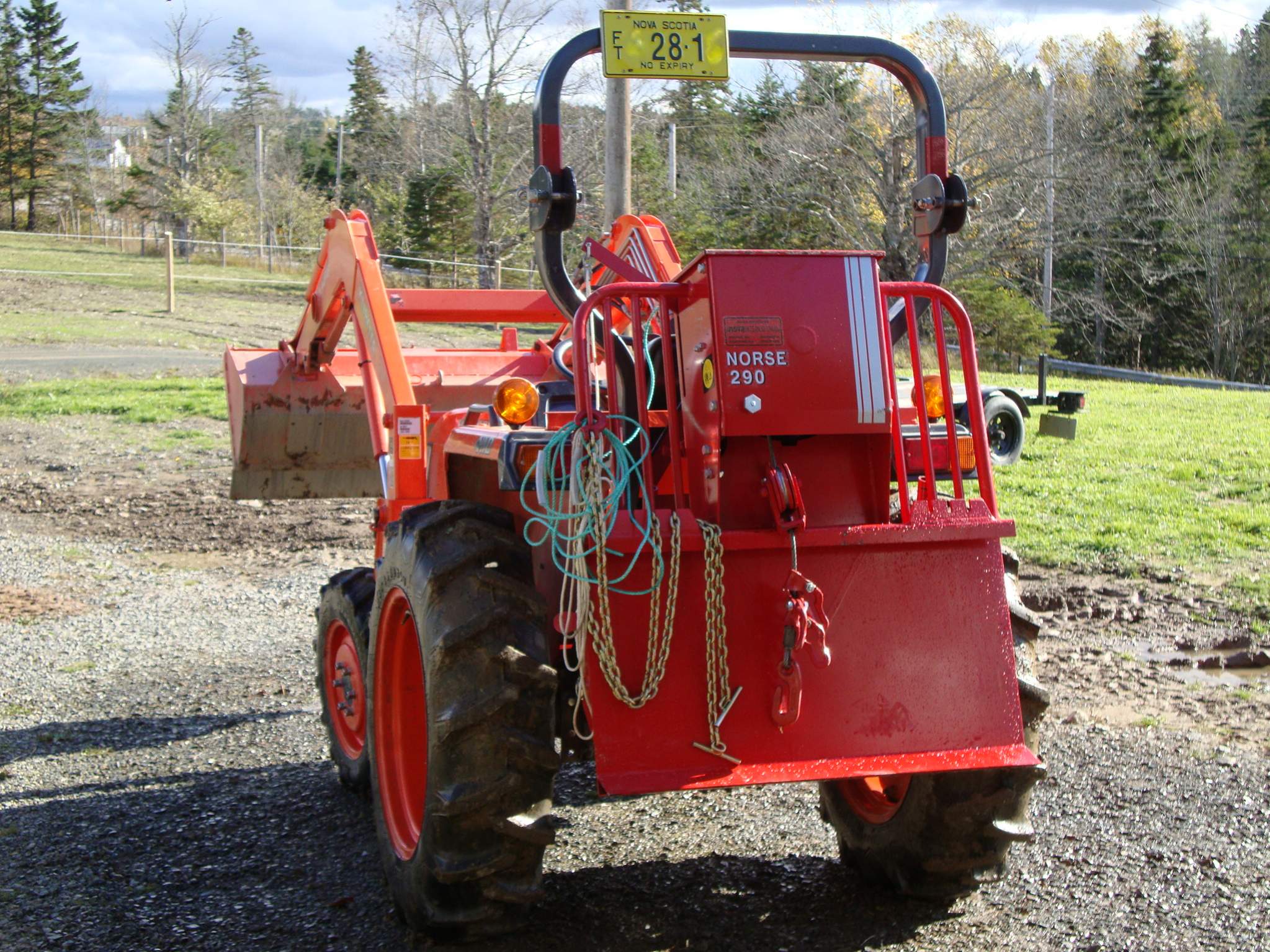

Congrats on the new winch, I picked up this new-to-me Norse 290 this fall also. I've not seen any Fransgaard dealers here at all.

How do you like that Norse? I have often wondered how they stand up to the higher priced Farmi, Fransguard ect. in performance.

I've only used it for a couple of trees so far, I'll know more by the end of winter. They're made by Igland, possibly as an export brand? I was looking to get a Farmi, but the 290 is possibly about to be discontinued according to one dealer. I'm trying to avoid buying an "orphan" if possible.

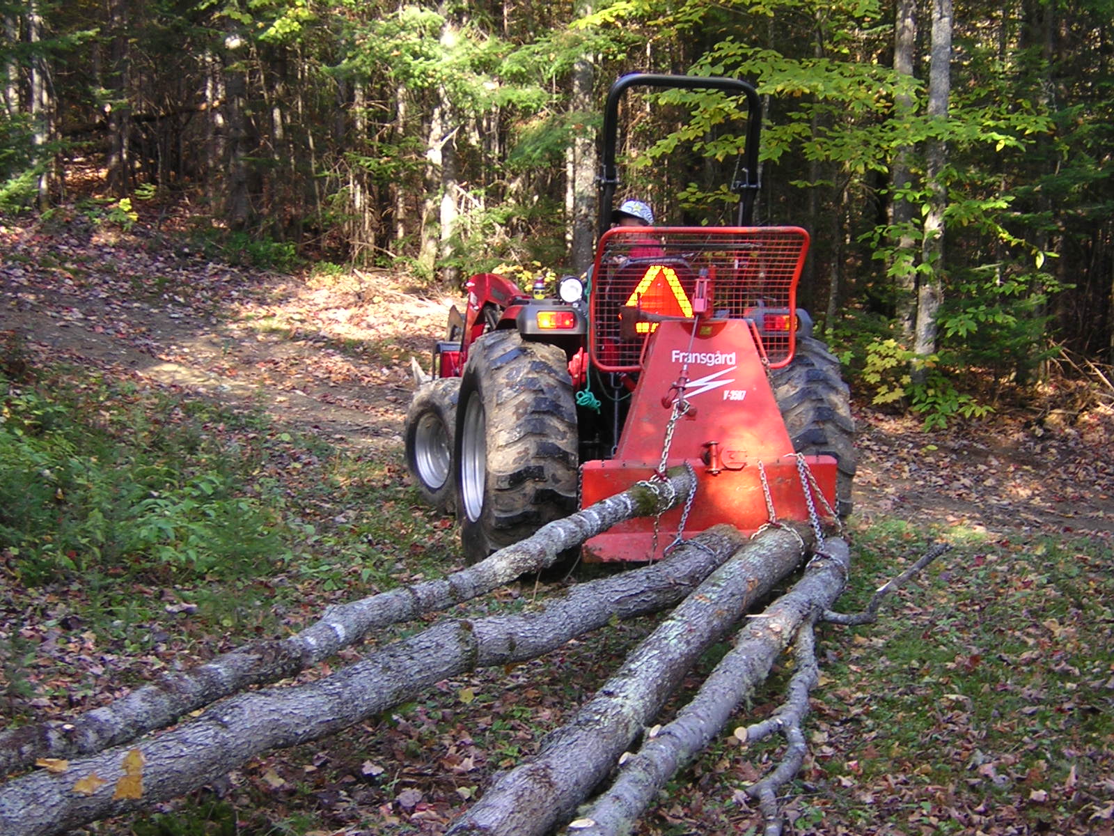

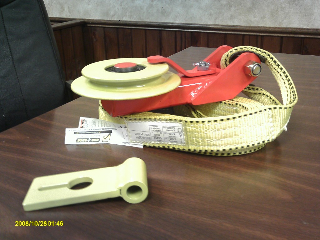

I paid about $280 for mine 3 or 4 years ago and prices had just jumped up then. I work a lot from the top of a ridge and not having to to make that extra trip down and up is a life saver. I have a 10 and 12 year old that help me and it is a BIG help but I never regret what I paid for the block.
Had I priced both I would have been on the fence too but having used it, if I lost it tomorrow, I'd have to get another one.
