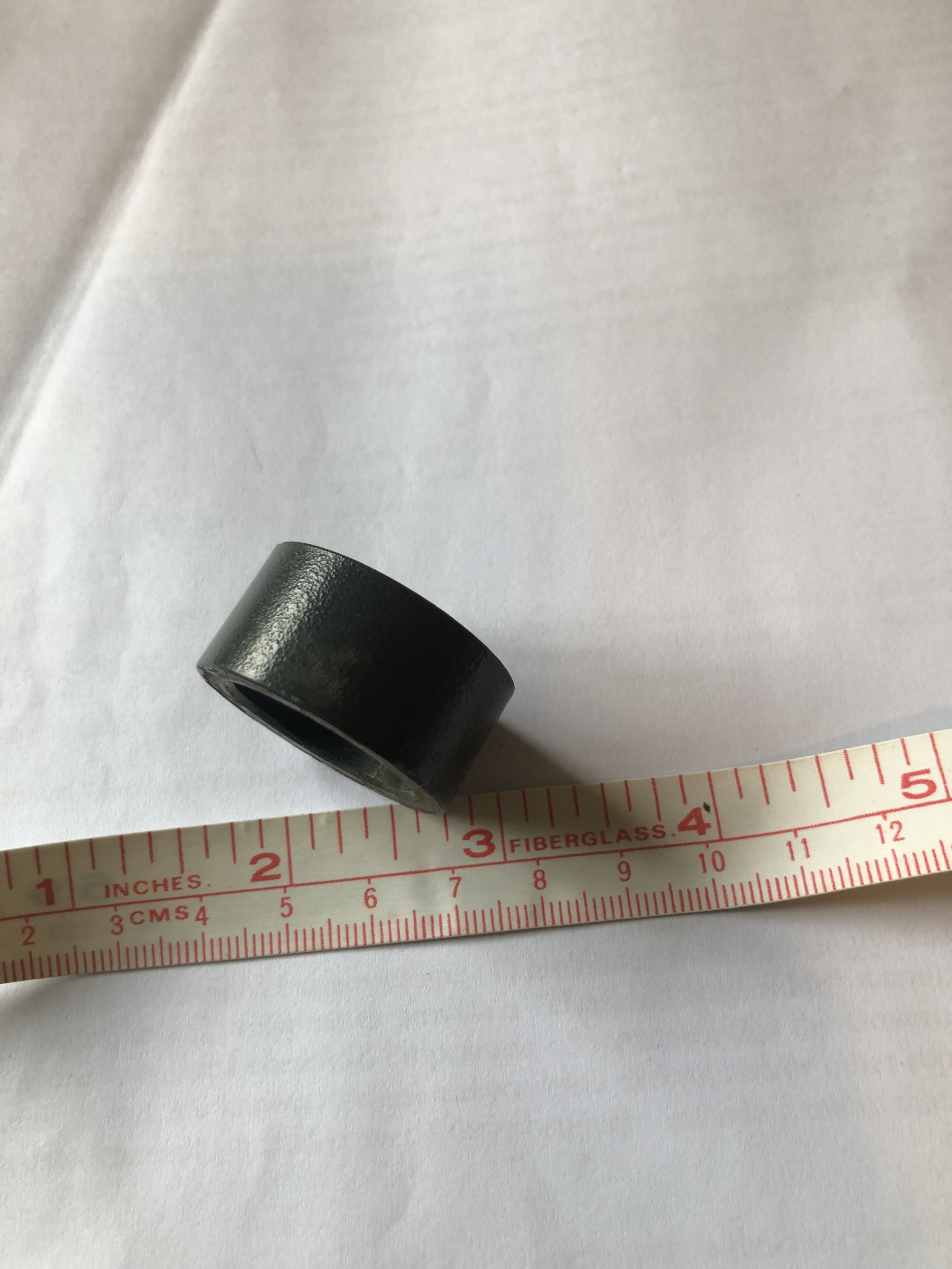

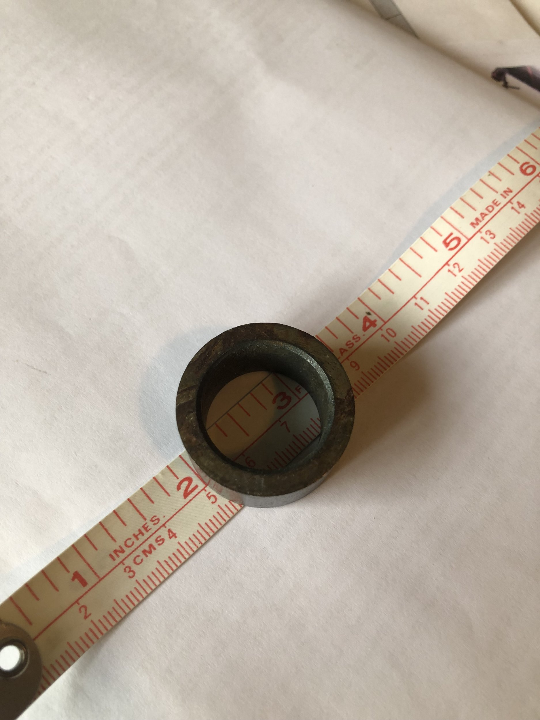

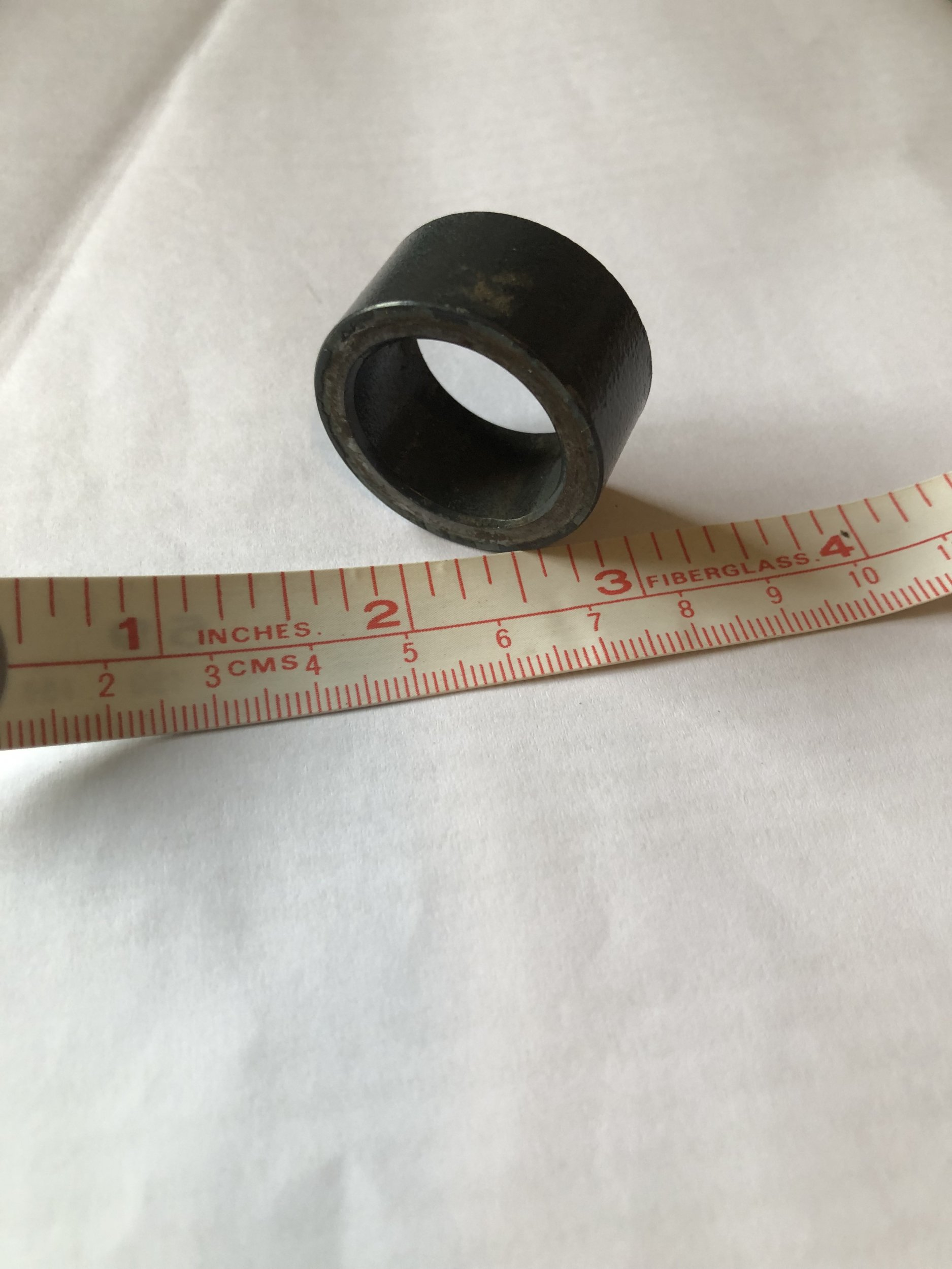

Long time lurker first time posting. First off thankyou to everyone this is one of the greatest sites/forums out there. Anyway, walked into the garage the other day and found this on the floor where I park my B21.Ive looked around and can't seem to see anything out of place, but I know it came off the machine unmistakable Kubota grey. Looks like a spacer or bushing with most of the wear on the sides and a little on the inside. Didn't notice anything odd last time I use it just moving snow. Iam hesitant to use it now as I don't want to lose more parts or cause damage. Anyway, I guess my question is any thoughts on where this might have come from? Iam trying to narrow down my searching area and I don't really want to start taking things apart if I don't have too. I know this is pretty vague butt I also know you all are pretty smart well most of you, Haha. Anyways thankyou again there really is a lot of cool sh-t stuff on this site, and its all because of you all.

Looks similar to a CAT 1 to CAT 2 bushing....?
/ Found this on the garage floor #3
Off the shelf Cat1 to 2 bushings are a lot longer than that (longer along the shaft hole dimension.) It looks to be 3/4" inside diameter which would fit typical top link pins. But being that narrow is puzzling. Showing wear adds to the puzzle. And being Kubota grey means it probably has some host tractor function, not implement-related.

Maybe look at the control levers going into the transaxle like PTO and gear selection levers.
/ Found this on the garage floor #5
When you found it, was it on it's side or flat?
On side if you remember exactly where it was maybe it fell & rolled (floor may not be perfectly level). That would help.
Otherwise maybe wiggle things. If dealer isn't far maybe service department they would recognize it right off.
/ Found this on the garage floor #6

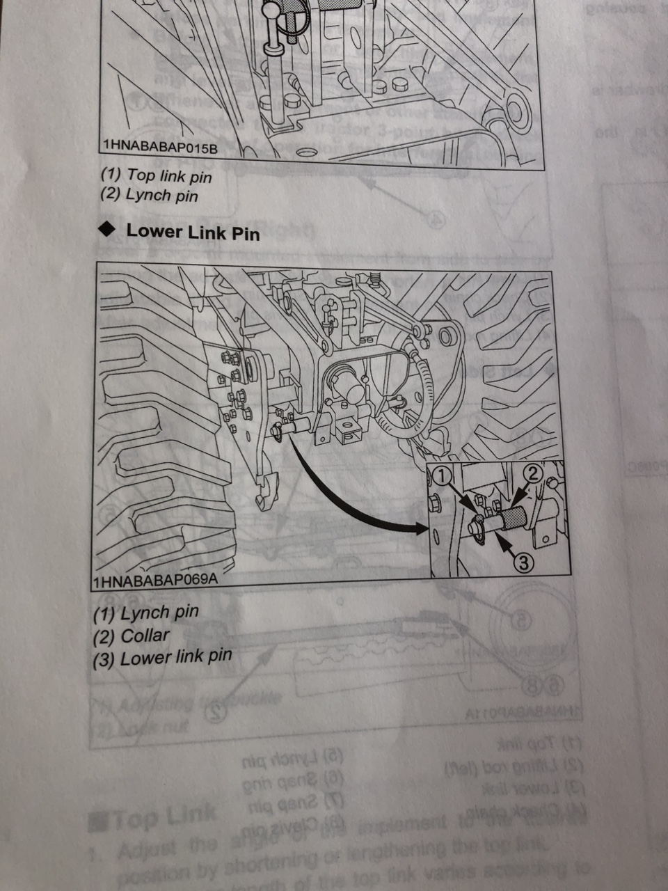

When you take the 3pt arms on/off the most forward pins for the arms have such a spacer. Did a lynch pin get knocked off while in backhoe mode allow the spacer to fall off? Painted might not be obvious those pins had spacers. Check the 3pt arm attachment points on the tractor.
I’ve cut a cat1/cat2 bushing to make a lost spacer. I’ve also use black, high strength lynch pin springs on those attach points to resist brush from grabbing them off underneath.
/ Found this on the garage floor #8
Good find Smokey Dog. These sleeves are very likely to be those (OR something just like them ) associated with the backhoe aspects of the tractor. That is why they would be "Kubota grey" and why the rest of us using other BX machines would not think where they came from.
