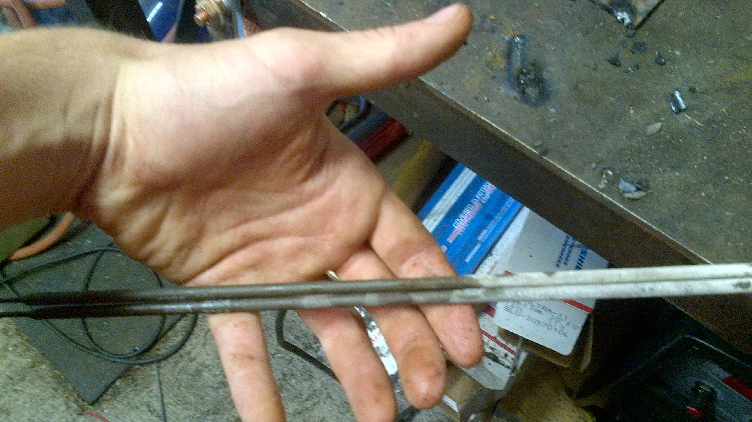

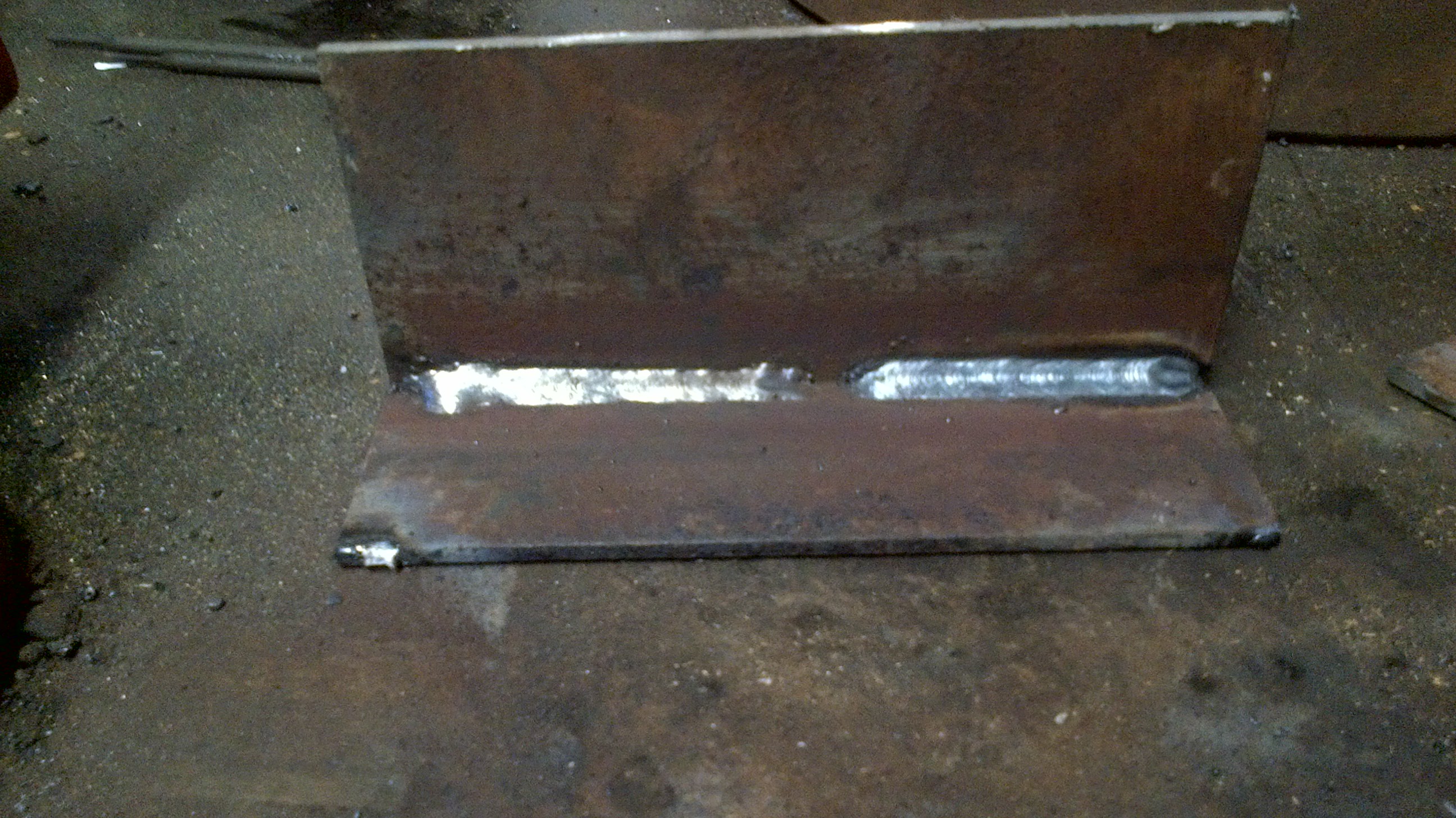

Well, I have wanted to try 7024 for a long time, but I couldn't make myself spend the cash for a can of blueshield rods...
Anyways, under the rod cabinet at the museum I work at, is a few hundred pounds of very old and possibly scrap welding rods. In that pile was a very old box of liquid air 3/32 7024. Just that brand should tell you how old they are... LOL They are starting to get some white dust on the flux, but there is no rust. The best welder there looked at them and said that they are not the best, but should still run alright. Anyways, I grabbed half a dozen of them, and I am planning on doing some testing with them tomorrow morning. It's about half a box there, and they will never use them. If they run alright, I might offer a few bucks for the box.
Stay tuned for pictures. Any idea what amperage I should run for them?

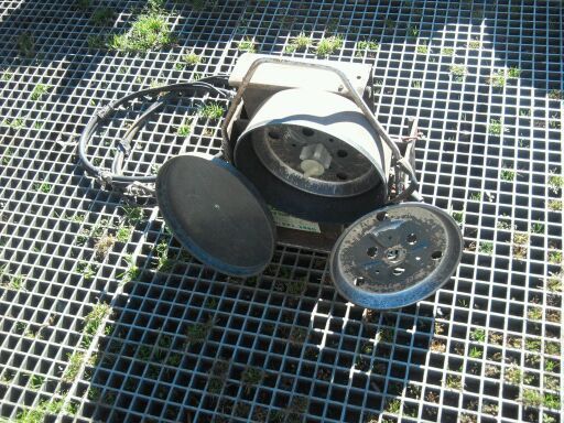

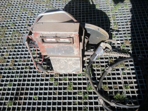

I think the last time I ran any 7024 was in the early 1980's. In my line of work Lincoln's LN-22s and Innershield wire eliminated the need for 7024.

Just keep moving...and keep the flux behind you if you can with the rod buried.
/ Found some 7024 to play with #4
Very interesting, I sold some 3/32" 7024 last week. I didn't even think they made it that small. I've burned a lot of 3/16" and 1/4" 7024 but like Shield Arc said, its pretty much been taken over by flux-core. 7024 was the production rod for years, that's why Lincoln calls theirs there's Jet rod but pretty much everyone calls 7024 Jet rod now. You can basically rest it on the plate and it will almost burn by itself. Run it hot but not so hot you get blisters in the weld bead. I like to hold the arc length just high enough so it isn't dragging the slag. On a couple occasions I had the slag cause problems with the puddle. It might have just been that I didn't have enough angle on the rod to force the slag back. Slag should curl up by itself in most situations except deep groove welds. Then it can be a real pain to remove but 7024 isn't normally used for groove welds. Welds are very smooth and it's an easy rod to use. All 7024 pretty much burns the same and it can be used on all polarities. It works best however on straight polarity(electrode negative). Experiment with it and see what happens.
/ Found some 7024 to play with #5
Use extra travel angle to keep the slag from getting under the bead. Like 45* .

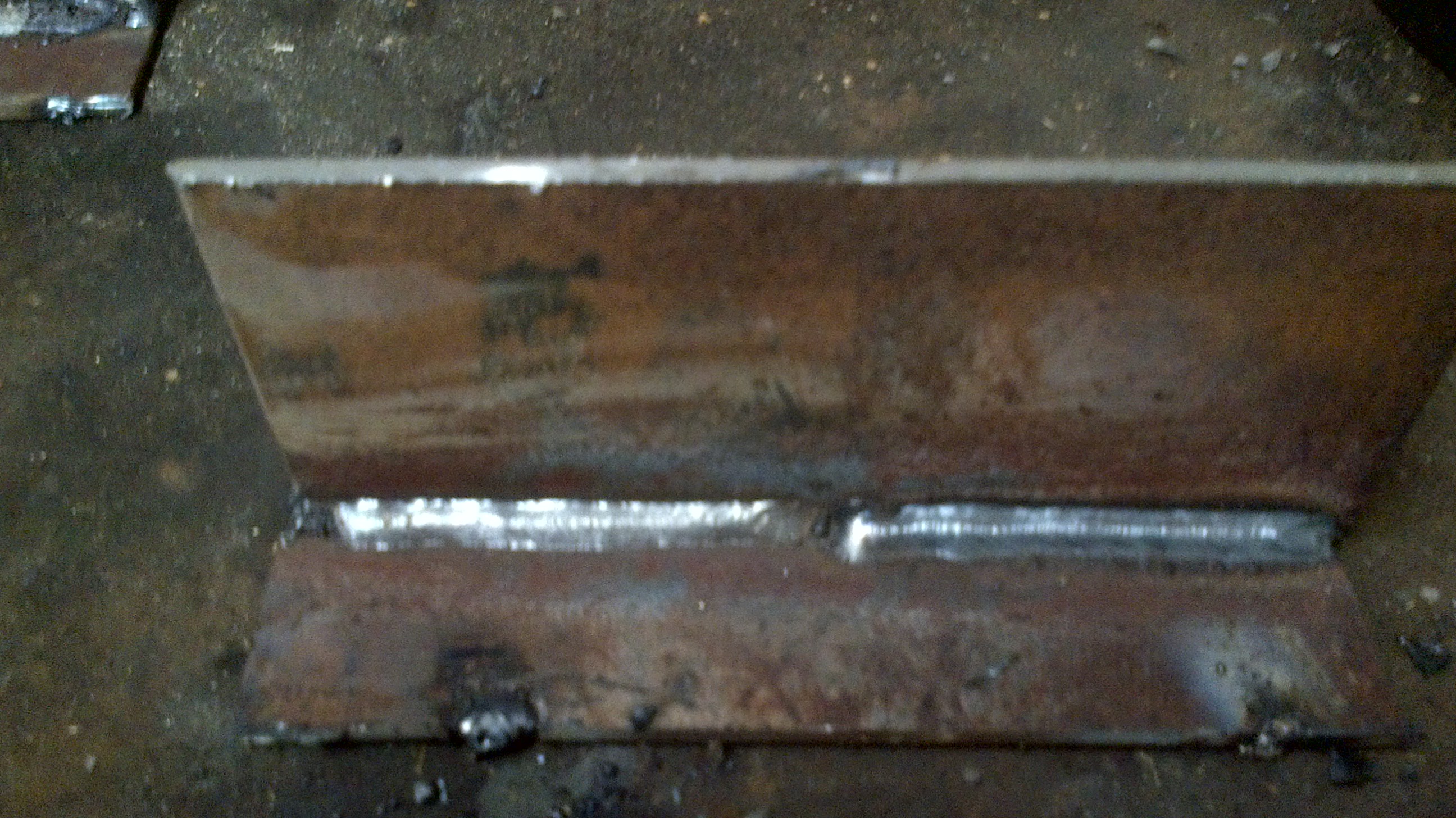

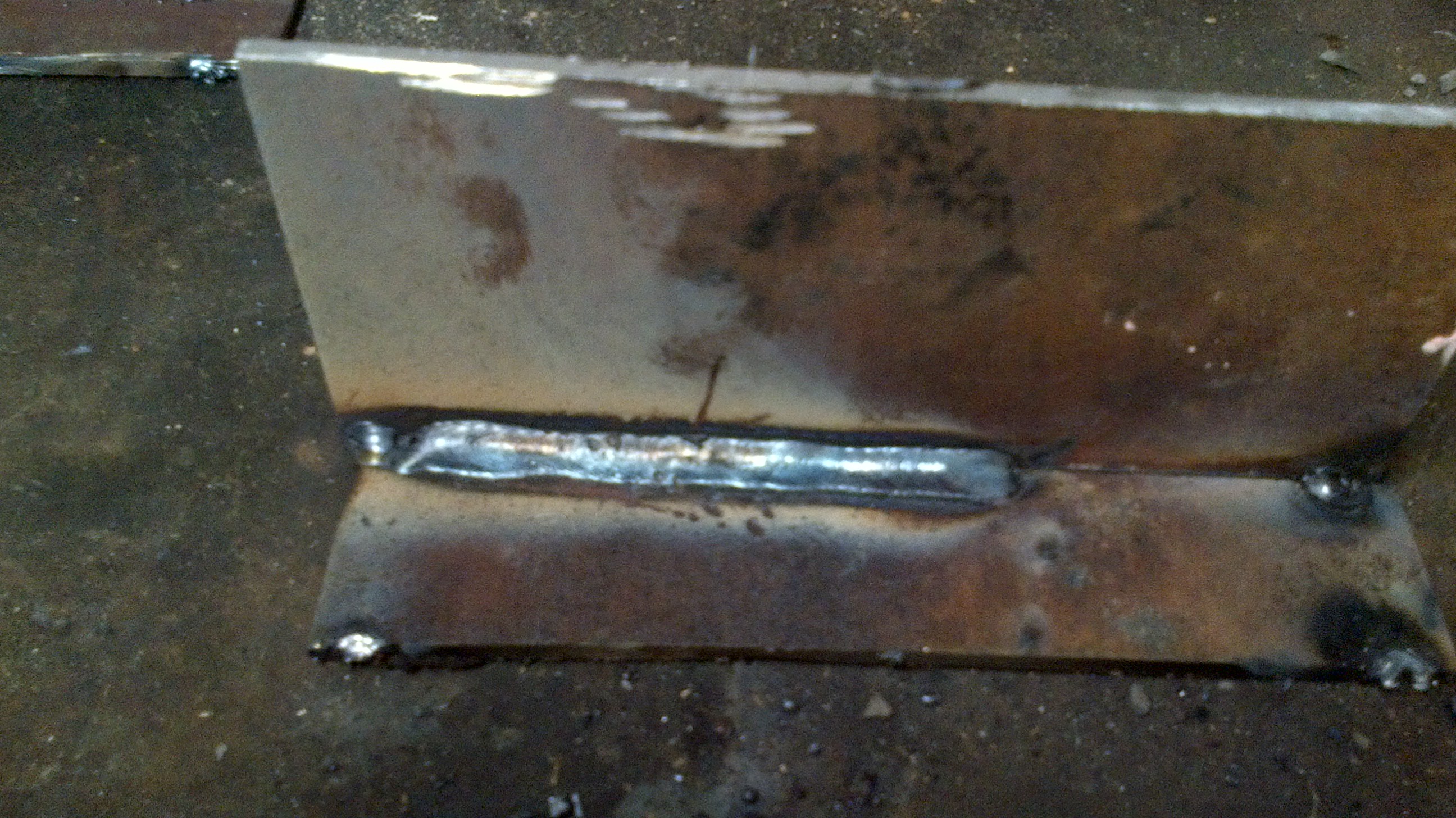

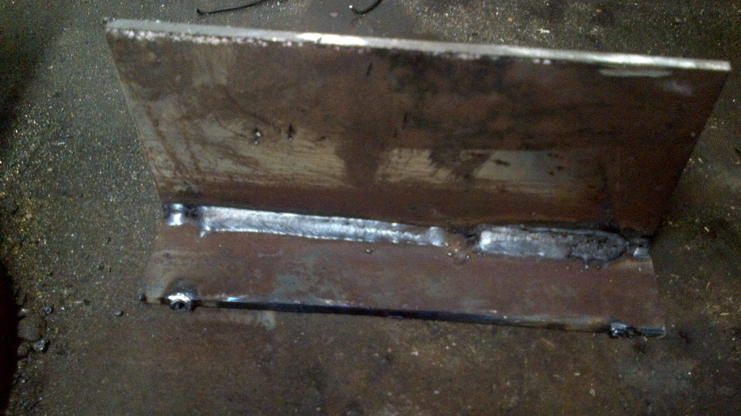

Oh man. That stickweld 250 loves these liquid air (15 year old blueshield) rods! The rods were a lot damper than I thought... Where they sat on my hot bench, there was a puddle of water... And they were still the nicest running rods I have ever seen. 106 amps DCEN, 1/8 plate 3/32 liquid air 7024, and the amazingly good stickweld 250. That thing seriously runs nicer than the industrial 400 amp hobart at the museum... LOL
Anyways, here are some pictures. The one short bead with a really bad end, the flux fell off the rod, and it bent like a pretzel. The rest of them ran like a dream. I didn't even have to do anything! Just held a 50* rod angle, and they literally ran themselves! I didn't even have to move my hands!
Not too bad for old, soaking wet rods!
Here are some pictures.
If you have of these stickweld 250s, or even any similar inverter, you have to try some 7024! If the lead to my stinger was a bit stiffer, I wouldn't even need to hold it to weld with these things!
/ Found some 7024 to play with #9
Those are some nice welds!:thumbsup: If your mom isn't home! Turn the kitchen oven on to about 150 to 200-degrees, and dry those rods out.
Years ago there was a thread on the AWS forum, guys in Texas were building the base to a large tank in an oil refinery. They were running very large 7024, they had better luck running the large rods on AC. I would have never thought about trying AC with 7024 myself, so I thought it was very interesting.

Thanks man! If I had more than two rods left, I would bake them. I will see about making an offer on the rest of the box.
Only possible issue is we have a gas oven.... Might not be able to dry them with the moisture produced.
I think I will try and get a toaster oven from the thrift shop, to prevent a major war if she finds I have baked welding rods in the oven.... LOL
I dont have the tombstone anymore, it is at my uncles ranch for fixing his haying equipment. No way to run ac any more.
I sure do like that longevity though! It likes these rods more than any others I have tried!
