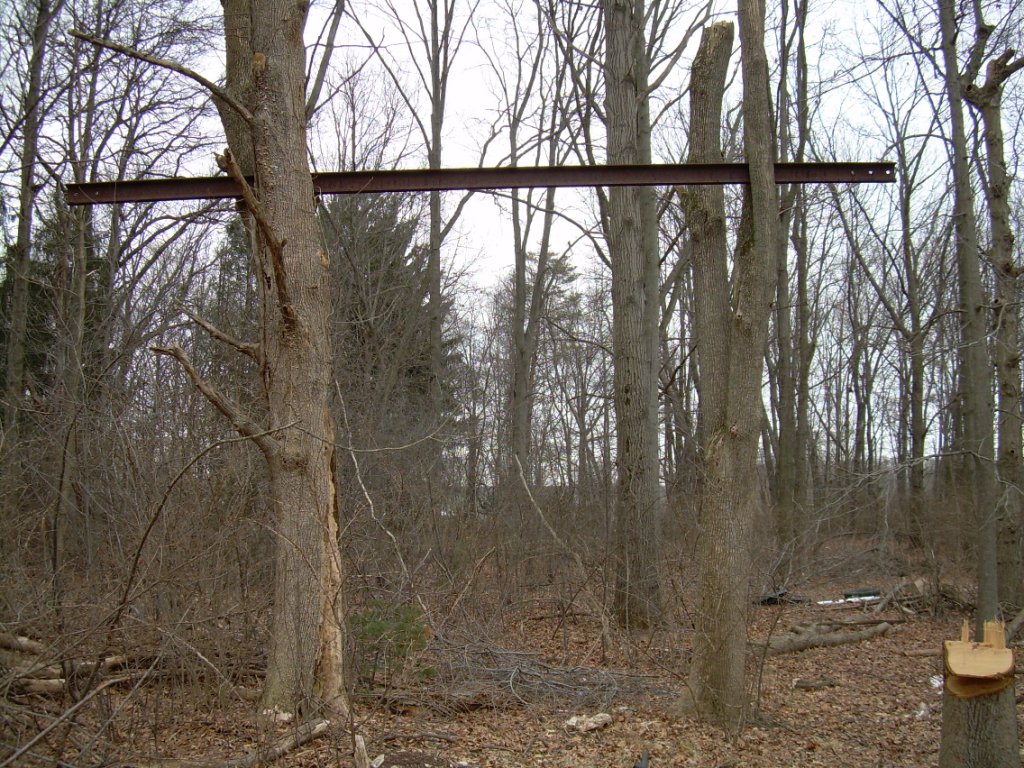

Always wondered, does anyone know is the rolling surface hardened or not? or is it just the mass of steel that makes hardening unnecessary.
the band saw would be the cleanest and easiest of all, but not practical for out in a field.
a couple of pics of mine I got from a neighbor, is the heavy version for sure, never read the side.

Just curious how the R/R track got up in the trees? Little overkill for a dear cleaning station :confused::D
Best guess is they used it to hoist a camper off a pickup, just wonder how they got it up there! Was a little tricky getting it down, cut one tree and it got all twisted but wouldn't come out of the other.
