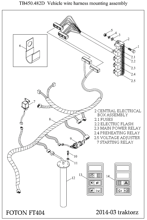

As the next step to remove the instrument cover, we first need to remove the steering wheel, in order to track down the electrical wiring. As a starter the FEL is now taken off the tractor.
- Where is the voltage regulator on this tractor?
Is it on the relay socket panel, and marked 2.5 VOLTAGE ADJUSTER in this diagram?
Also what function does the "2.3 MAIN POWER RELAY" have?
Is it the "7 STARTING RELAY" that is connected to the solenoid at the diesel injector pump for start/stop maneuvering?

I'm not sure about 2.5, I expect the VR to be under the bonnet: typically on an engine bracket or firewall, or physically integral to the alternator. start the engine and observe the voltmeter reading. Then pull the 2.5 device and see if there's a voltage change on the meter. If yes, then it may in fact be the VR
Main power relay 2.3 may in fact be an upgrade to the "major system fuse(s)" I mentioned earlier. It may be failing in its job to protect those fuses

It looks like your Foton uses the same fusebox as my Jinma, in which case the voltage regulator is on the fusebox, on mine it's silver in color.
I think your symptoms are consistent with too high voltage. One of the things you wrote is that the starter motor was stuck in the engaged position with the flywheel, which gave me an odd idea. When a DC motor is spun it acts like a generator, so I'm wondering if what was happening was that your starter motor was being spun by the flywheel, which was causing it to generate electricity and was overpowering the electrical system. The voltage regulator wouldn't come into play because all it does is regulate the output of the alternator.
Now, in order for that to happen the starter solenoid has to be engaged, otherwise the starter would be electrically isolated from the rest of the electrical system. The other thought I had is that you said that the glow plug fuse was blown. Both the starter and the glow plugs run through the key switch. Is it possible your key switch has failed?
So here's the summary of my hypothesis: key switch fails and energizes starter solenoid and glow plugs. Energized starter solenoid causes starter to engage, and it acts like a generator because the engine is running. System voltage increases, causing anything that is on to draw more current than normal, leading to a bunch of blown fuses.

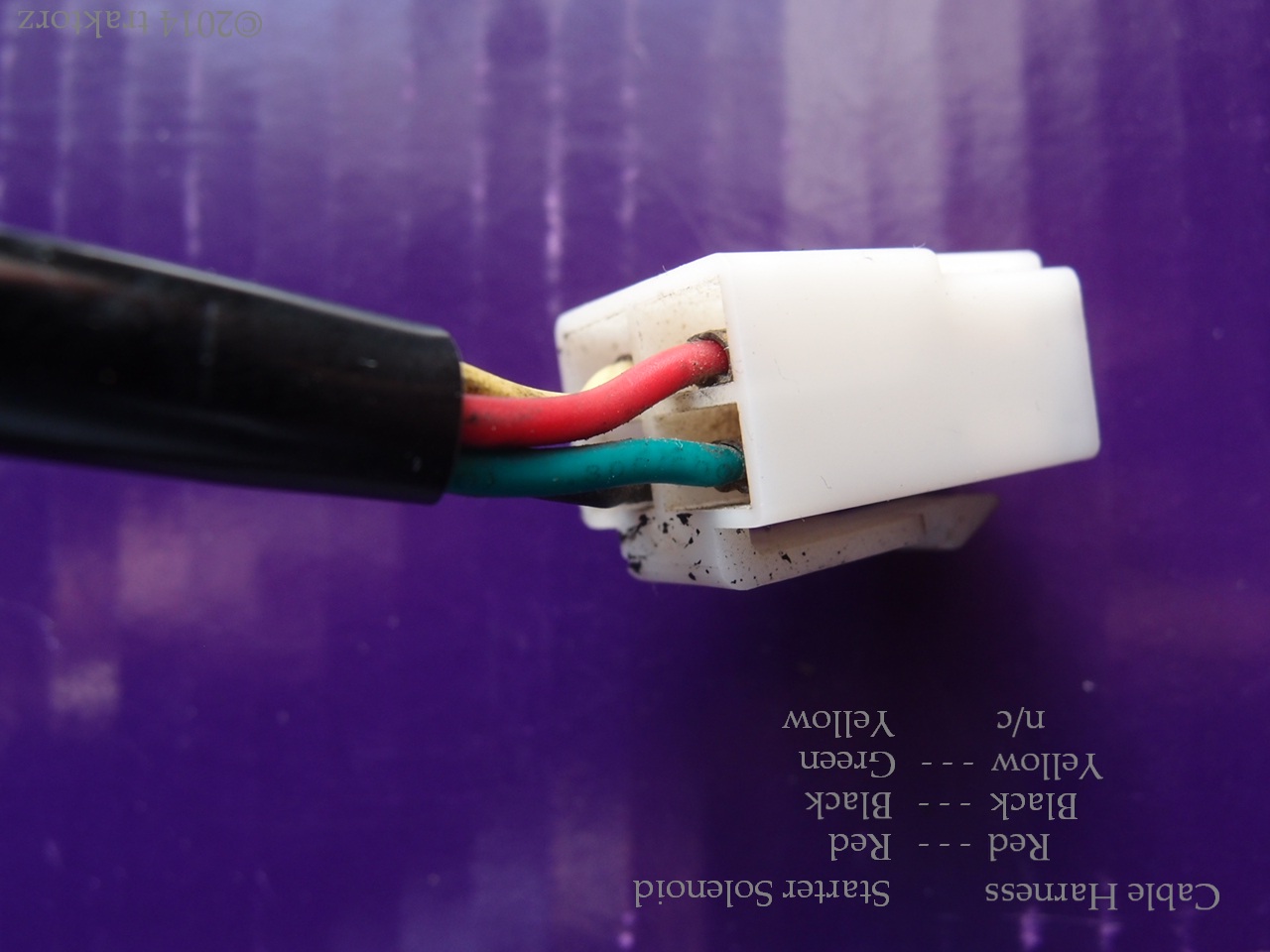

Another problem is that the starter solenoid doesn't respond, althoug there is an additional voltage appearing when moving the ignition key to the "ON" position.
At this warm weather currently in Sweden, using the preheat isn't necessary, so with the corresponding fuse blown and removed, we decided to try starting the tractor. With the starter solenoid removed, we had to rig the fuel pump valve into the running position by a piece of wire.
- The tractor started instantly, it sounded OK, but to stop it, we had to release the rigged wire at the diesel injection pump. The conclusion is that we can run the tractor, but there are some remaining questions, in addition to await the spare part cable harenss from China...
Question 1:
How can I function test a glow plug? What is the nominal DC resistance? Does it need to be replaced with an exact Foton part or is this a commodity item, easily available at other places?
Question 2:
How can I function test the starting solenoid? It has a connector with four wires, although the cable harness only utilizes three wires. What are the wiring schematic for it?

1. 30 amps (presumed) across 4 glow plugs at a nominal 12.2 volts. Although we already know Chinese wiring doesn't reliably deliver actual battery voltage. But sticking with basic math and Ohm's Law (I=V/R) one can extrapolate that the four GPs represent a total of 0,4067 ohms resistance Plugging that into the equation for parallel resistance reveals that each plug "should" present a nominal 1.6265 ohms. Given the specificity of the resistance, I recommend a matching set of four original equipment plugs. They may not be branded Foton, but that's less important than getting the right diameter/thread count/resistance in four identical plugs.
2. Get a digital multi-meter and a helper. Set the meter to measure DC voltage, on a scale appropriate to detecting 12 volts. At the solenoid, put the (+) lead on the connector to which the clutch bypass wire is attached. Connect the (-) lead to the closest good earthing point (bare metal or battery post/cable). Have helper crank starter, observe voltage while cranking.

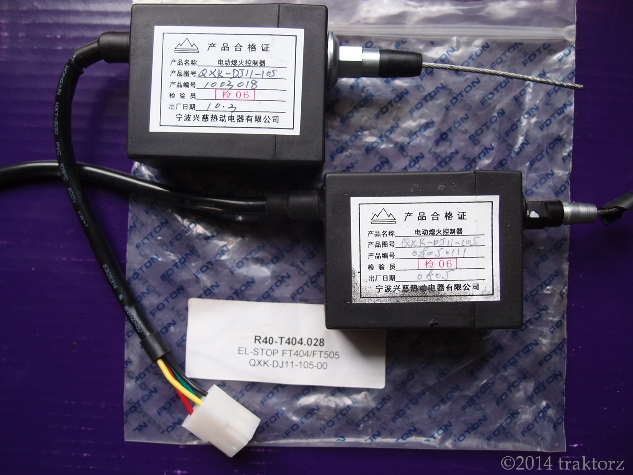

My phrasing "starter solenoid" is maybe wrong. It's more of a linear motor pushing or pulling a wire to stop the diesel injection pump.
R40-T404-028 EL-STOP
Found out that the electrical stop (mounted on the diesel injection pump) box was broken, since it didn't respond to the voltage from the ignition key. Ordered it through the country distributor, and had it the next day in the post. Happy to tell, the tractor seems to coming back to it's normal electric conditions again.

The SOL you are talking about it the fuel cutoff sol, it actually SHOULD pull in turning the fuel ON to the injector pump when the KEY is turned ON. When the key goes OFF a spring should pull the lever the opposite direction and kill fuel stopping the eng.
