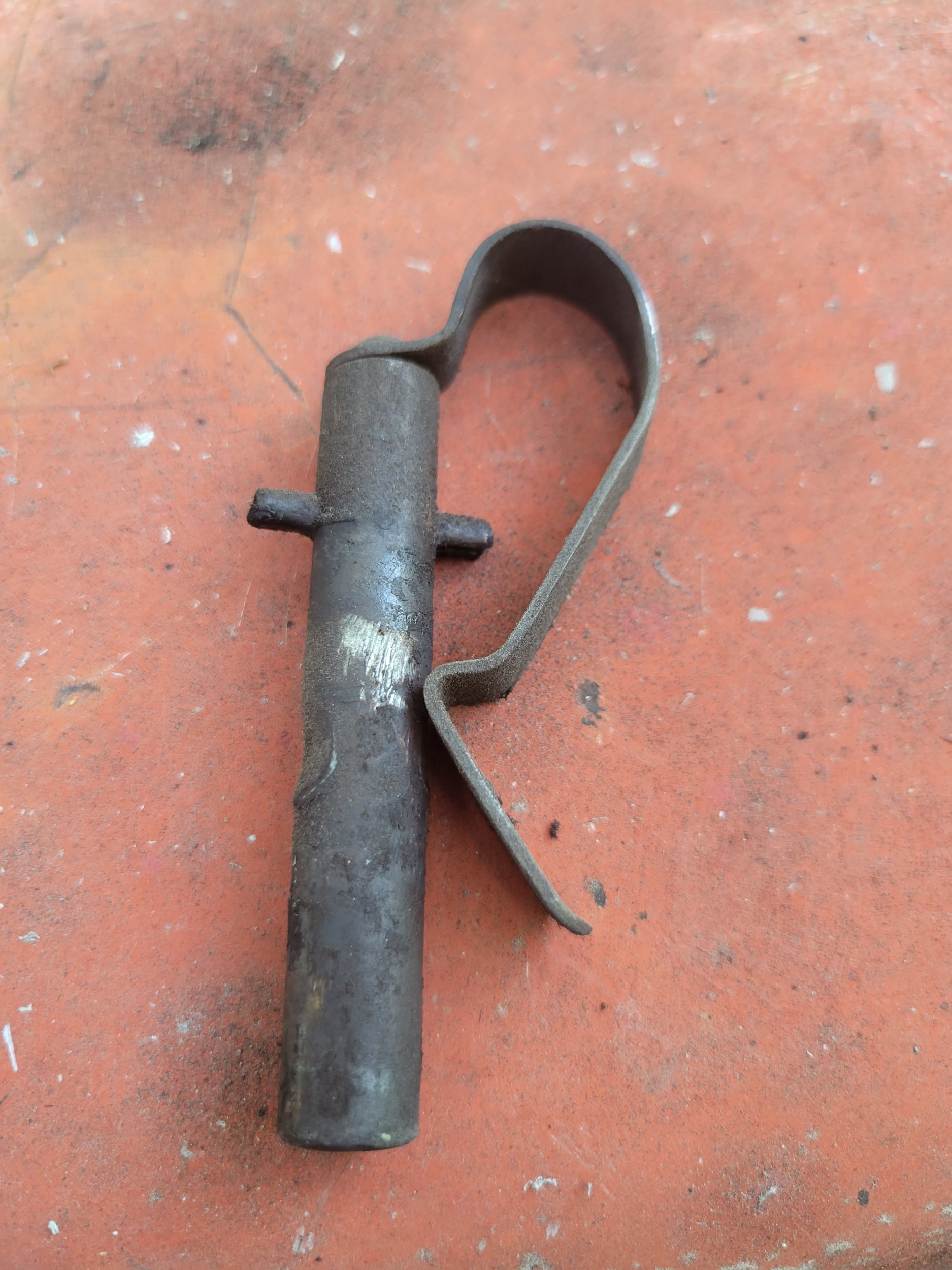

Also, I need a pin for my bucket and can't find anything like it anywhere. Gonna send a picture.

OK... never seen one of those :) ! I assume the curved piece is a keeper of sorts. I would probably take a measurement and try to match a hitch pin to it and provided the end is able to pass completely through, retain it with a lynch pin or clip. It would also be fairy simple to fabricate a new one using off the shelf metal stock.

Yes I have already done that. I am a machinest, so I have access to all types of machinery and metal. The problem with putting a pin in it is it will constantly be in the dirt and most likely come out a lot. I don't have a way to bend and mold the spring steel without taking the temper out of it.

It looks like the spring steel on the old pin is riveted on. Can you simply grind the rivet head off and either; rivet it back on, drill and tap the pin and bolt it on or plug weld it to the new pin using the rivet hole?

Problem solved. Works better that original.
