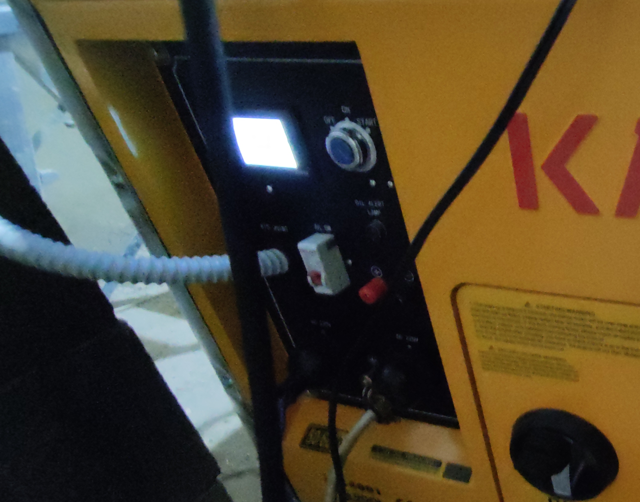

To add there are two relays for the oil pressure sensor, one that toggles the 2nd relay with battery power preventing the engine from starting again unless the key is toggled.

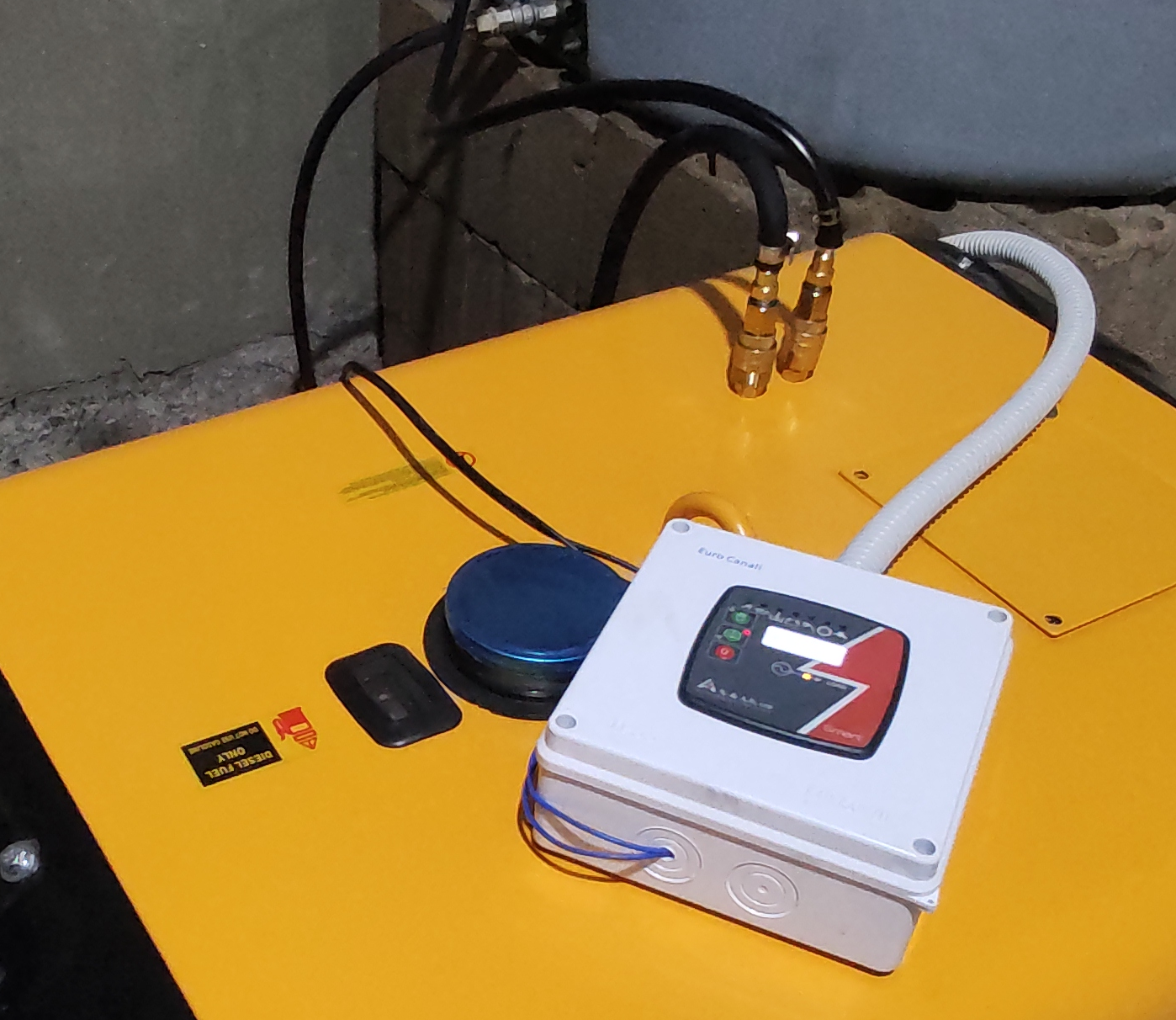

Installed a generator controller in an external box with magnet mount and flexible trunk so I can view it around in any assembly positions (the blue wires are remote start, using wires for swapping different gensets easily)
3 minutes warm up, and 5 minutes cool down period, added contactor inside for output switching and a bypass power socket in case the controller is down for manual use.

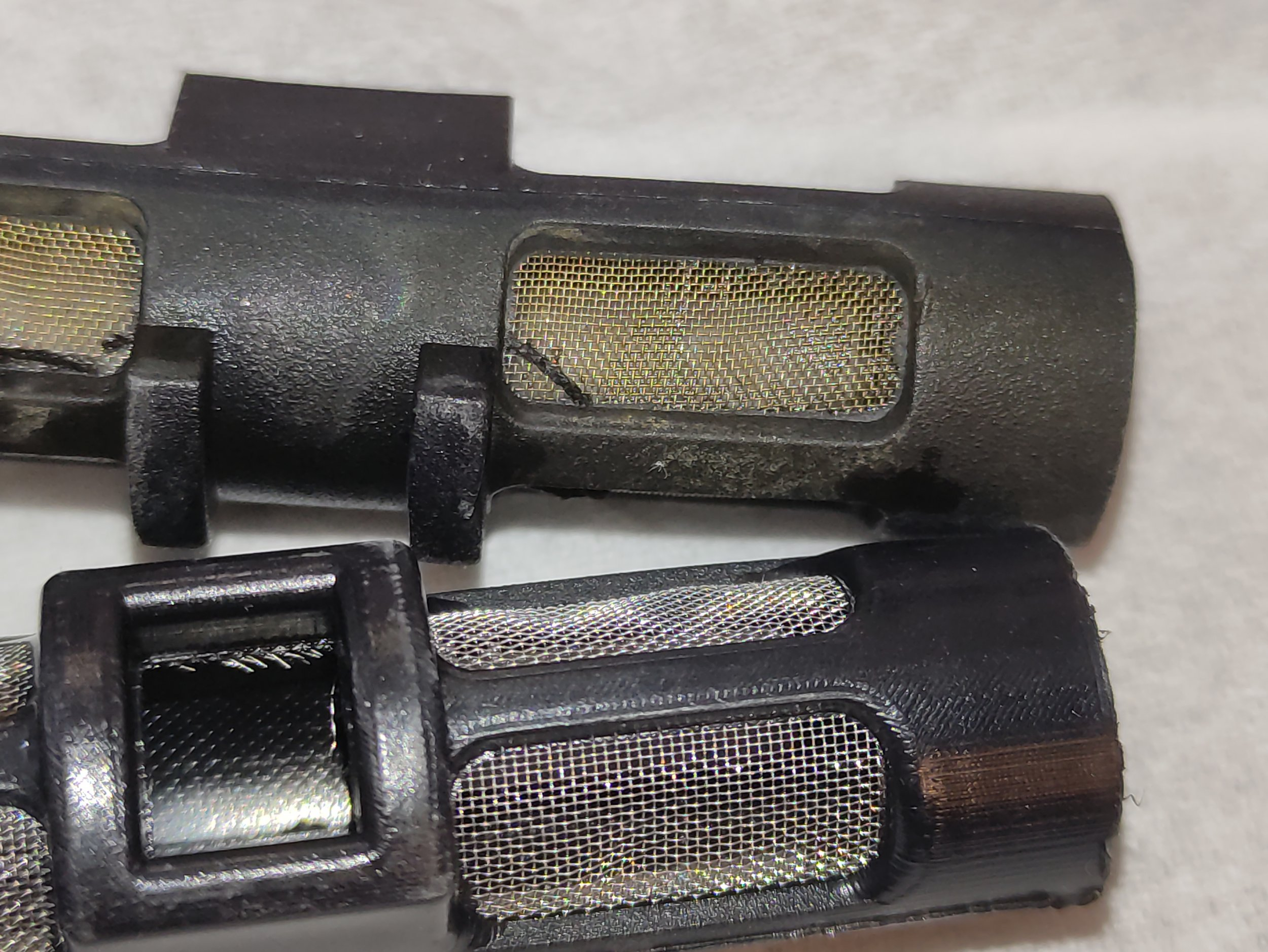

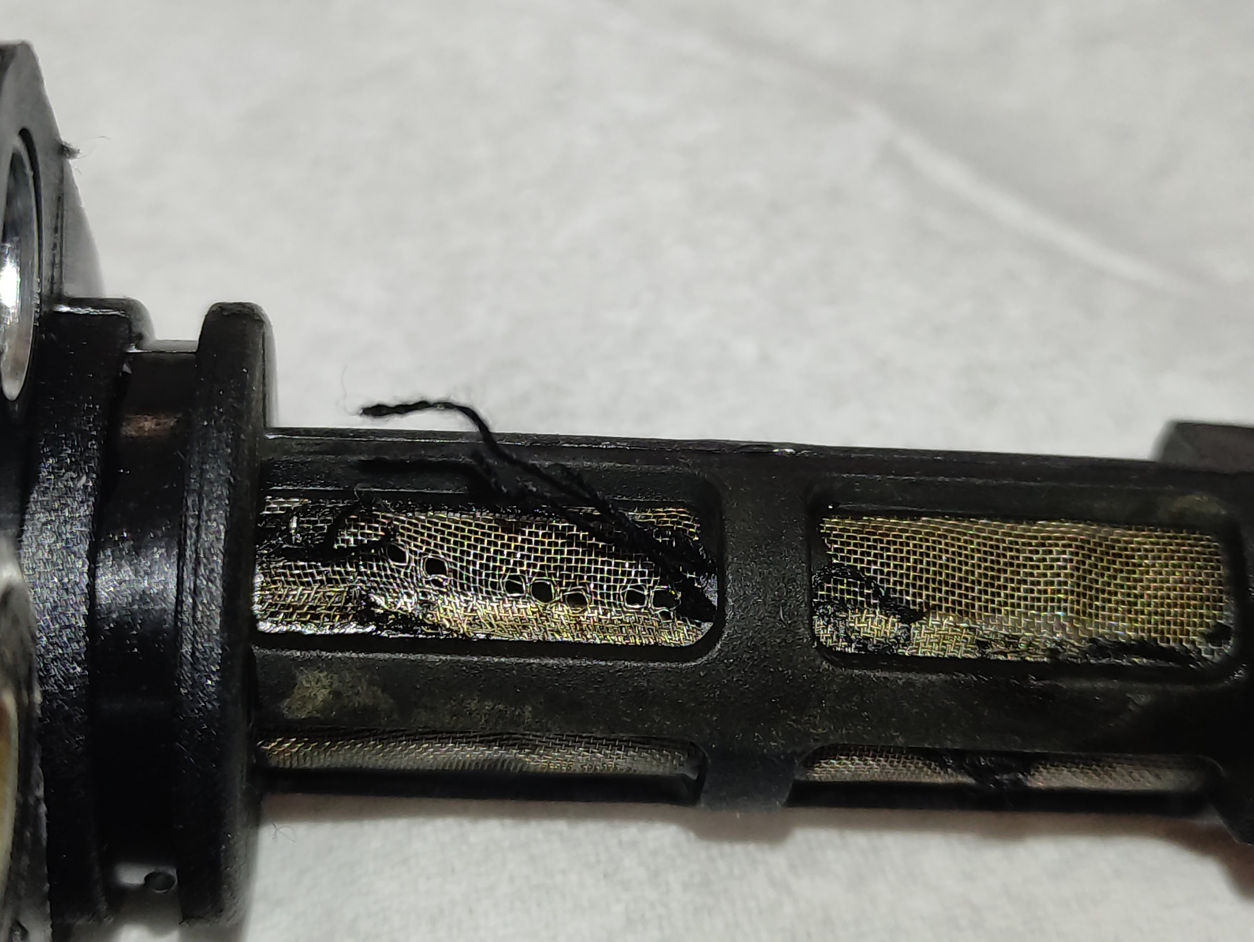

I replaced the oil filter with a new one before first run, I'm glad I did as the original had defect upon cleaning 😖
Kama filter (top) vs a filter from no name china, seems to be finer and much harder to bend:
Looks like someone's clothes got caught, glad I looked at almost everything.
