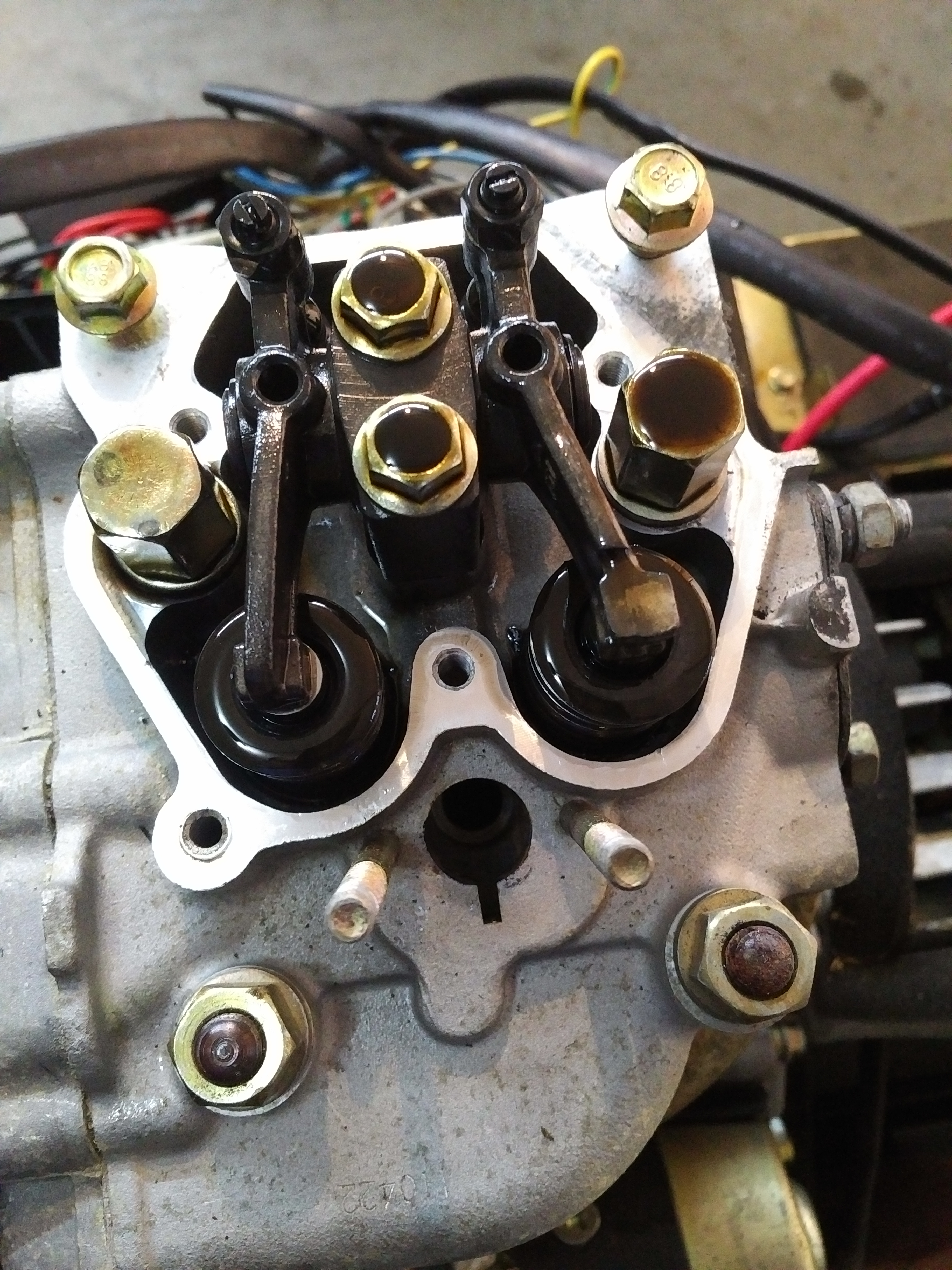

Howdy fellas
I finally made it up to my parents place and spent a few hours looking over the generator.
I pulled the oil filter (I didn't know there was one there) there were a few flakes and shavings on it, but it was not clogged or anything like that.
I pulled the injector, it has some carbon build up on it, see the picture below, I guess it is a good indicator of what the rest of the cylinder looks like, and maybe even the problem, but I'm no expert and I'm not even sure how it's supposed to work.
I took off the valve cover also, I didn't check the valve clearance yet, but things look pretty good, no obvious signs of anything going wrong.
As I was taking things apart, I took note of some really crappy electrical connections, the oil pressure sending unit and the connection made to the fuel pump.
I'm not sure what it is for, but all these connections are starting corrode, even though I keep this guy under a roof, so it must be just moisture seeping in.
I'm wondering if perhaps vibrations could affect one of these safeties which would cause behavior like this. Once I'm finished looking everything over, I will put it all back together and
try each of the kill switches and see exactly what happens when I wiggle it, disconnect, reconnect, maybe they just need a cleaning.
Any advice on what I should be looking for would be appreciated.
I'm hoping to get up there next weekend and continue looking for issues.
