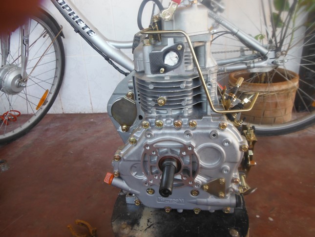

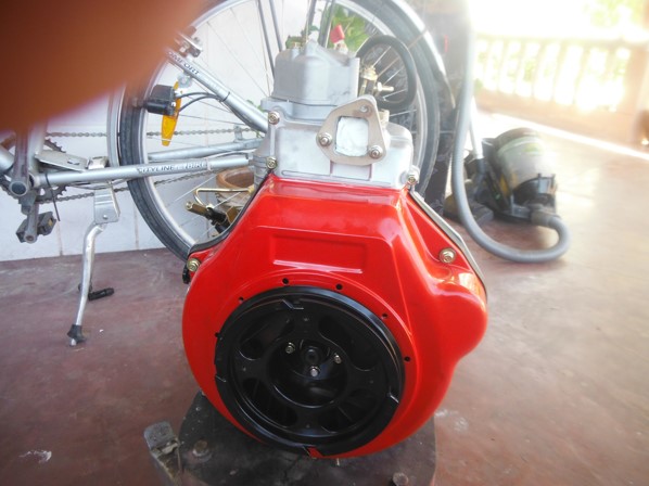

I Have a M.C. KAWASAKI 16 HP and 558 cc. It looks like a yanmar clone, but in the housing is cast in "made in Japan". I bought it in the Philippines, and here they print labels of all kind. Up to now it ran fine for 10 hours. kawa3.jpgkawa4.jpgkawa6.jpg
Did anybody see an engine like it?
And I could use a lttle bit more power and think to put a turbo charger and intercooler on it. anybody has experance with this?
Alex

No. Engine is not engine. Some are light and some are heavy. And this one is the most powerfull of the light single cylinder air cooled diesel engines. And I do have a turbocharger and an intercooler, I donエt have to buy them.
But I bought an head gasket today for this engine, and the gasket is for a bore of 86. And a bore of 86 is for the typ 186, which has only 10 HP and 406 cc with 70 stroke. 556 cc with a bore of 86 would mean a stroke of 96!

I could not wait, I took out the injector and checked the stroke with a welding wire. I measured 75, could be +/- 2. I am disappionted. So it cant be true
what is written on the sticker.
Alex

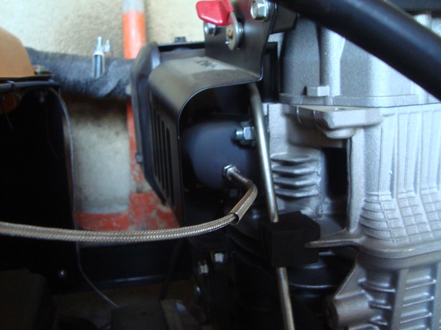

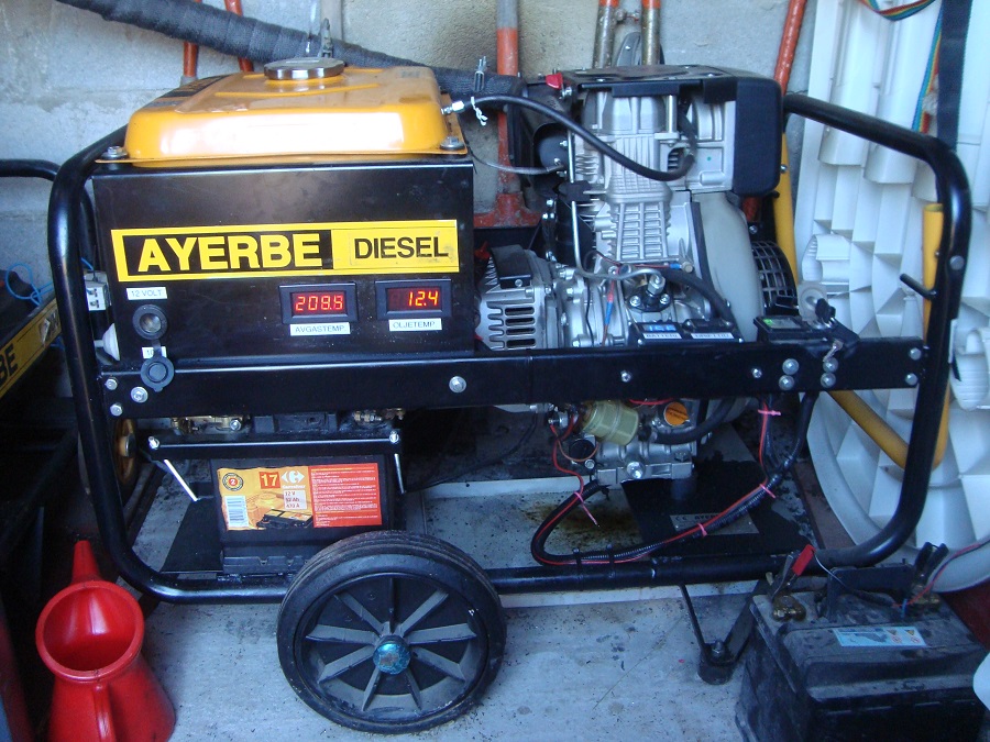

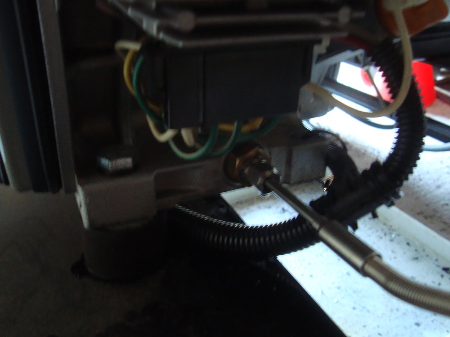

I have now added two more meters on my generator as you can se in the picture below.
The right one gives the oil temperature measured at the bottom of the Yanmar engine. I replaced the rear drain plug with a new one holding a temperature sensor.
The left one gives the exchaust temperatur. I drilled and tapered a M5 hole in the exchust collector on the engine.
The exchaust temperature follows the load closely. Around 180 Centigrades at idle and about 460 degrees at full load.
I am not shure of the optimal temperature to avoid wet stacking. :confused: The knowledge must be somewhere on this forum! :biggrin:

Nice work. I'm not sure of the "optimal" temperature either, but at least you're above the condensation temp of water so that's good. The other problem is even if the optimal temperature is, say 300°C, it won't necessarily be easy or make sense to maintain that temperature. Like burning wood in a wood stove, there is an optimal range of 300-550°F to prevent creosote formation but I found that you'd need to be fiddling with the stove air/wood supply to maintain those values which isn't something I'd want to spend doing all the time. Letting a fire die out guarantees you won't be at the minimum 300 temp for a while. I would think as long as you're hitting decent loads over 50% capacity for 10-15 minute periods wet stacking shouldn't be an issue. I've ran tractors at pretty low loads (<20%) for a couple hours here and there and never noticed a wet stacking issue.
