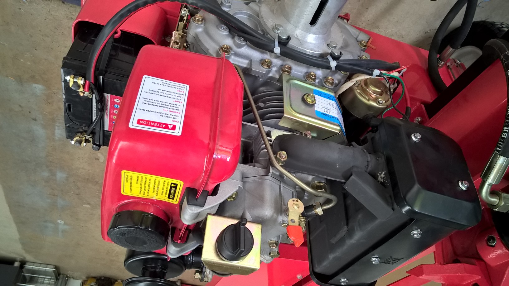

I bought a wood splitter a while ago and it has the 186F diesel on it too, seems to run OK and can split redgum at basically idle. WP_20160409_13_05_09_Pro.jpg

Yeah, diesels shine at low RPM. That was another noticeable difference on the mower. I usually engage mower deck clutches at low RPM to minimize the wear-and-tear on them. Gas mowers can stall out doing this. The diesel just puffs a small cloud of black smoke and the blades come up to speed (albeit low) almost instantly.
Was the log-splitter a retro-fit, or a factory (China?) build?
   / Forum for air cooled diesel engines and clones #253
Yeah Chinese thing. For the extra $150 I went with the diesel over a gasser. Uses way less fuel and powers along at low RPM which means a little less noise plus I'm a diesel nut... :laughing:
