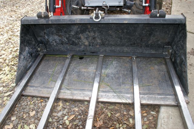

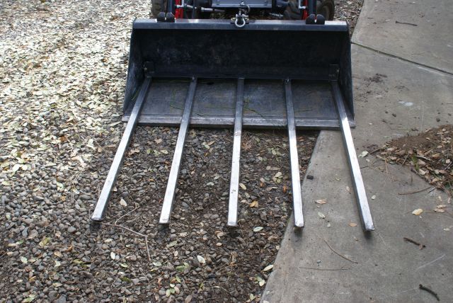

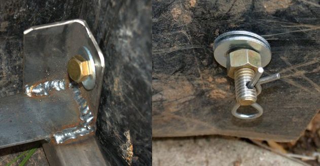

Finally have something to show....
And though you can not see it there is a lip under forks that captures front edge of FEL to keep forks locked into position...
Next step is brush guard to protect front of tractor....

That should do the trick!

My DIY'd forks are clamp on style about 40 ins apart made from 3 inch channel.
Clamping action is 5/8" bolts finished with a 'T' for tight clamping.
I slightly tapered the clamp screw ends to create a tighter grip.
