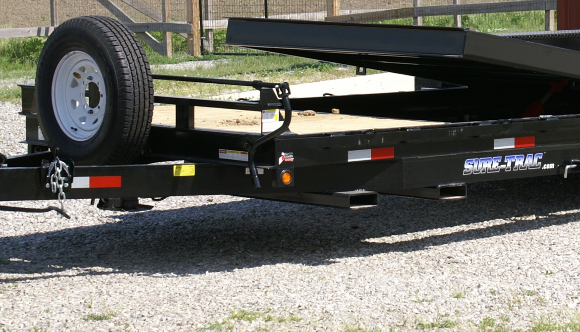

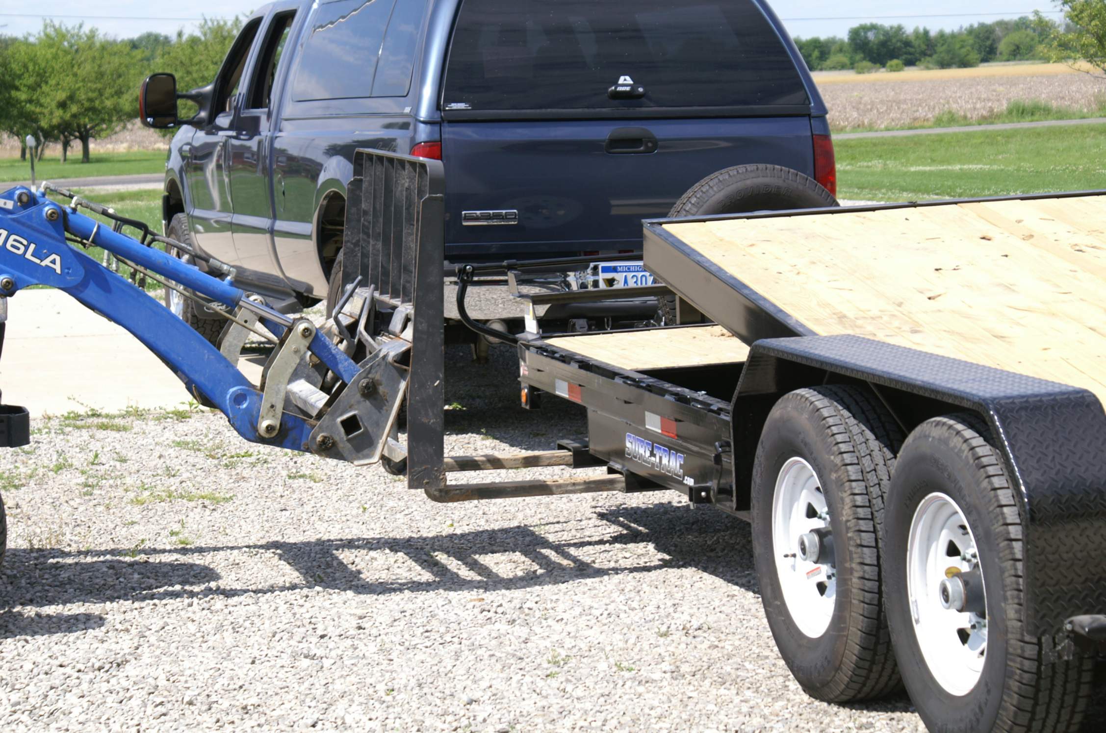

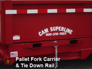

I am thinking of adding a fork pocket under the deck of my trailer to hold my QA forks. Does anyone have any pics or links to how these are generally done? I'm thinking some kind of U-channel (channel, bent plate, or angles welded together) plus a couple of chains to keep it from popping out. How beefy does the steel need to be? I'm guessing that 3/16" thick is plenty for durability and way overkill for strength.

Try about 6 pieces of U channel under the trailer and strap it down.

Edit: The more I think about it - ya know what I'm really looking for? Dimensions. Forks are about 4" wide x 1 3/8" thick, according to the spec page (buried under 2' of snow so I cannot verify right now). So would a 5"x2"x 3/16" wall rect tube be about right for the channel? Spaced on the widest fork center which looks to be ~41" OC that should do it???

/ Fork Pockets? #8
This is how they were done on my trailer.

Thanks for the pics. Looks pretty simple. You have dimensions on the tubes by any chance? W x H x wall thickness

I just went out to the barn and measured the tubes on mine. They are 8" x 3" OD with a 1/4" wall.
