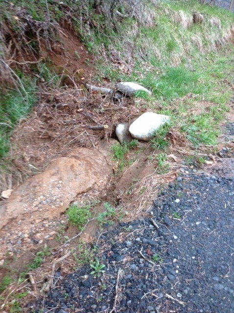

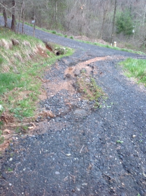

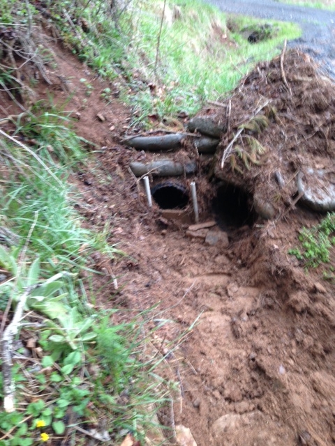

Just for comparison - the gravel road up to my property in north west NC is about 2100 feet and rises about the same as the original poster's from top to bottom - 250'. Going just from my memory we have at least 7 culverts along the course of the road that divert water under the road and out the downhill side. Most are 15" a couple are 12". The idea of more culverts is simply to reduce the volume of water the ditches are carrying as it all makes its way downhill.
We clean all the ditches out in the fall - usually at Thanksgiving when all the leaves have fallen and we have a little more time. Even with this things don't always work perfectly. This year we had a nasty ice storm in February that brought down a lot of debris - sticks, twigs, branches, etc. A torrential rain last week caused all this debris to clog a couple culverts and left the resulting washout.
