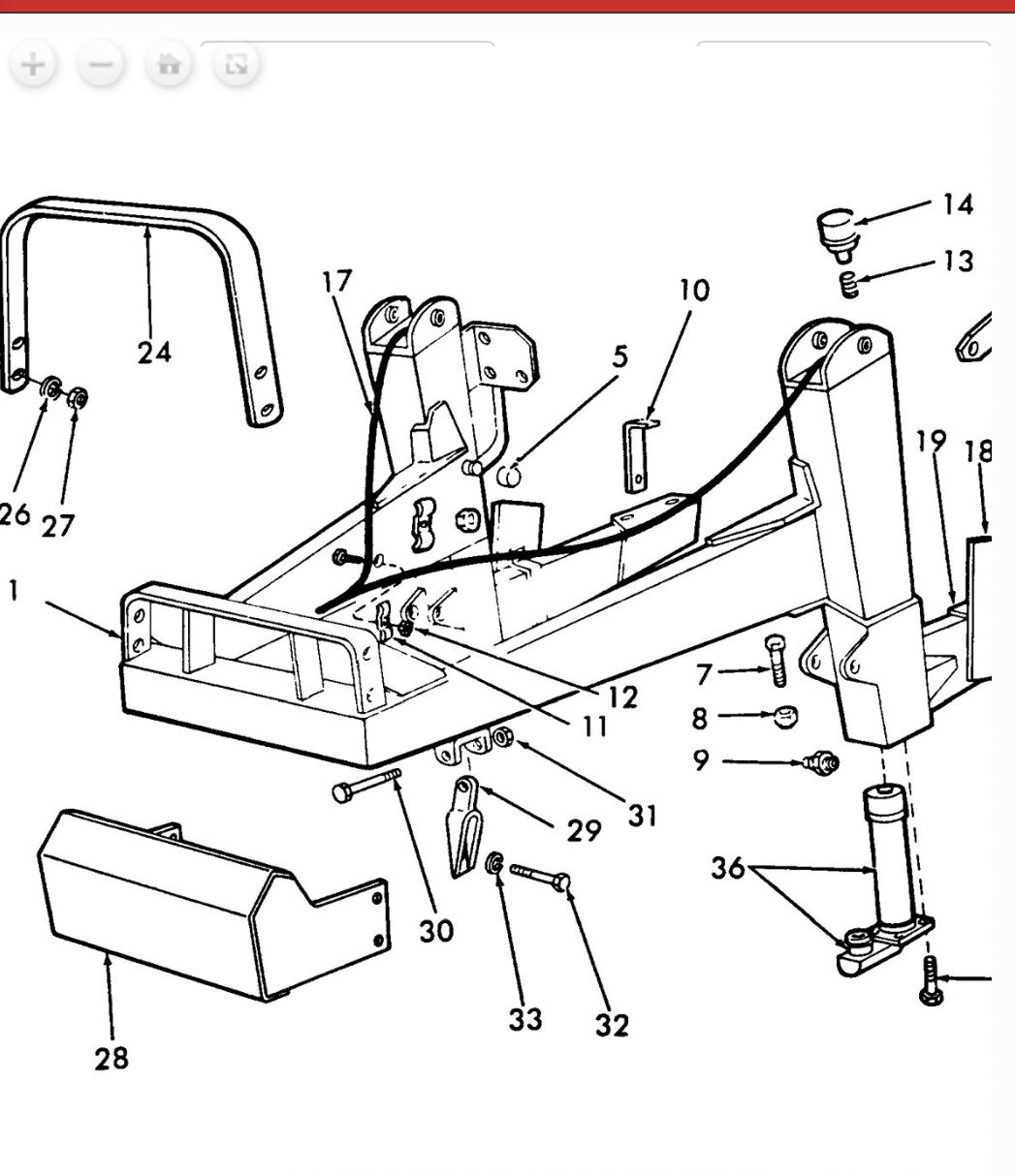

It looks like a 3550 since it has wet brakes. Does it have a single power assist steering cylinder on the lh side?
Also, looks like a 735 loader
It has single steering rod that goes from the steering box to the front end on the left side. I think it has a cylinder in the front that the rod activates to move the front tie rod.
The steering appears to be set up is a lot like the 4500 but I think a bit smaller. And the 4500 has a square front axle. This one has a round front axle.
I cant find any numbers on the loader.

   / Ford tractor identification #14
It is a 4400 with the inverted U axle and it would have the power assist cylinder and linkage up front.
From you picture of the LH side, you can see a hanger on the loader frame indicating a 735 loader.
#15
Thanks for the info :)
   / Ford tractor identification #16
#29 is the hanger I am talking about.
