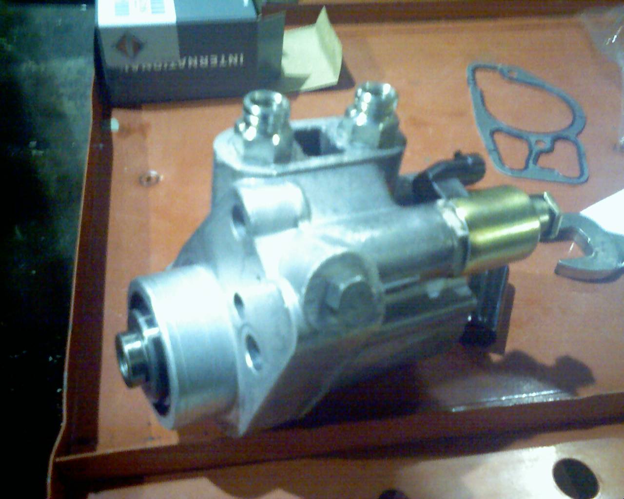

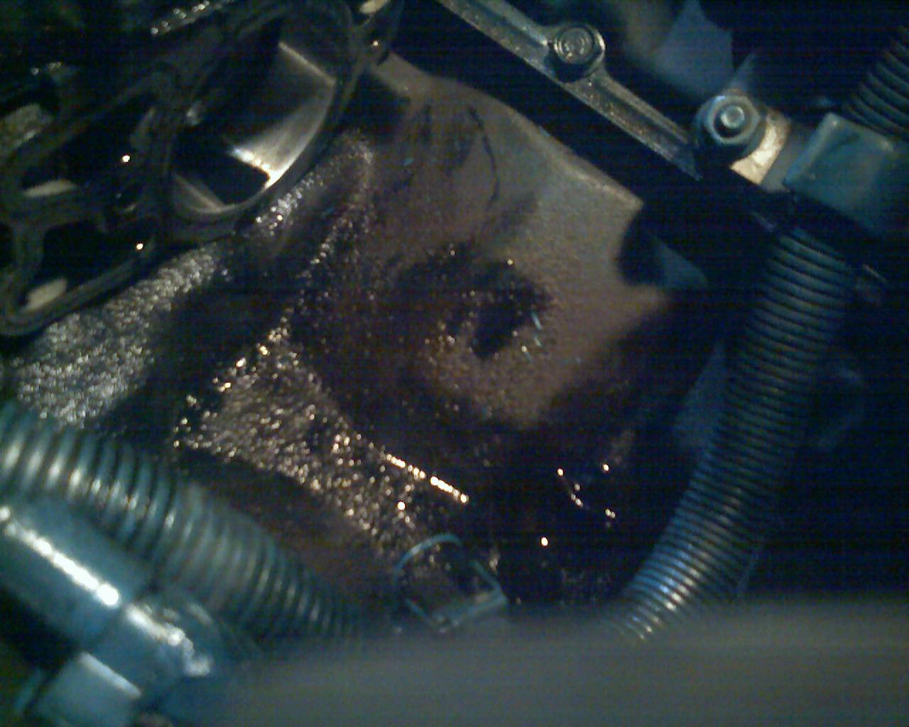

Since 7.3 oil leaks were mentioned, I snapped a couple pics with my phone of a 7.3psd high pressure pump and high pressure line replacement I did today. This job was on a 7.3 in a IH 4700 low pro chassis. The only difference is the low pro power steering pump mounts above the high pressure pump and drives off of the high pressure pump drive gear in the front cover, where a pickup does not have this power steering pump provision and the fuel filter housing resides here instead.
The first pic is the valley after the old high pressure pump was removed. you can see all the oil in the engine valley due to the old pump leaking.
The second pic is the reman high pressure pump on the bench after I already installed the IPR and IPR coil, which are the gold anodized items on the pump.
