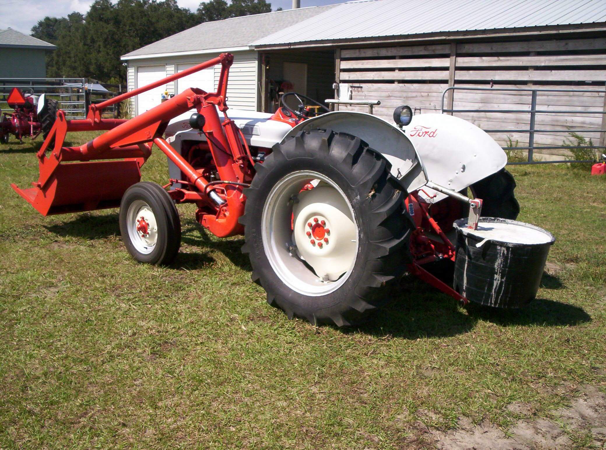

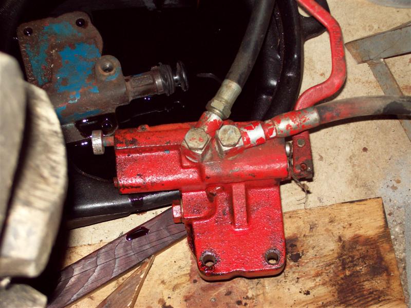

Looking to change the one lever valve to a two lever to oparate the hydraulic dump bucket. I would like to use what I have and add to it. Any ideas are welcome.
Thanks, Kirk

that blue valve in the second pic looks like a selectrol valve.. can't see it well enough though..

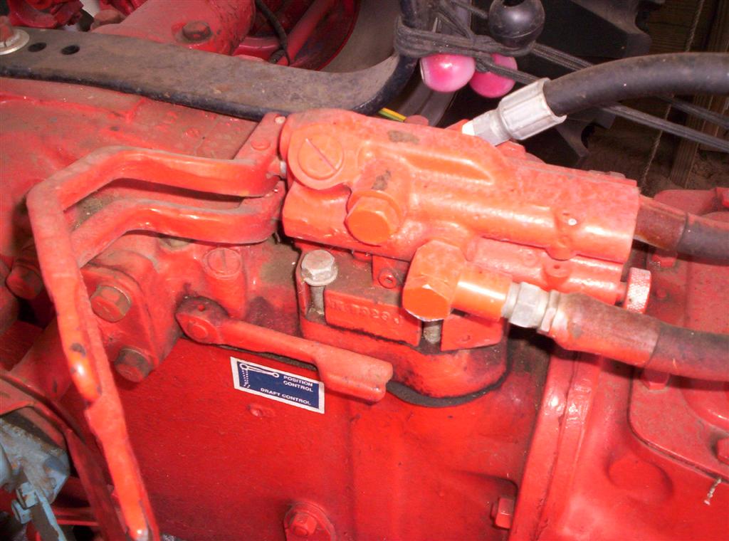

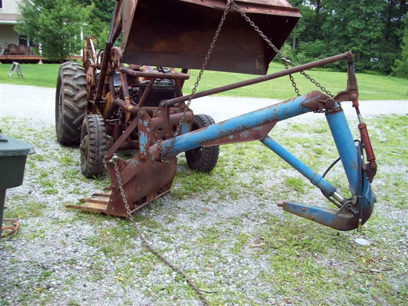

other hos(s) may just be obscured. SA on a bucket would make for a difficult setup between having to have a trip mechanism AND a loader control.. etc.
here's a pic of the dual valve on my 660.. one side is setup as sa ( small knob adjustment ).. and only has one line on that side.. this si the lift side.. the other side is 2 hose and is the da for the bucket.
here's a pic of my da bucket cyl.. real close looking cyl as to the OP's..
Yes the other valve is a ford (fomoco)selectrol valve.
