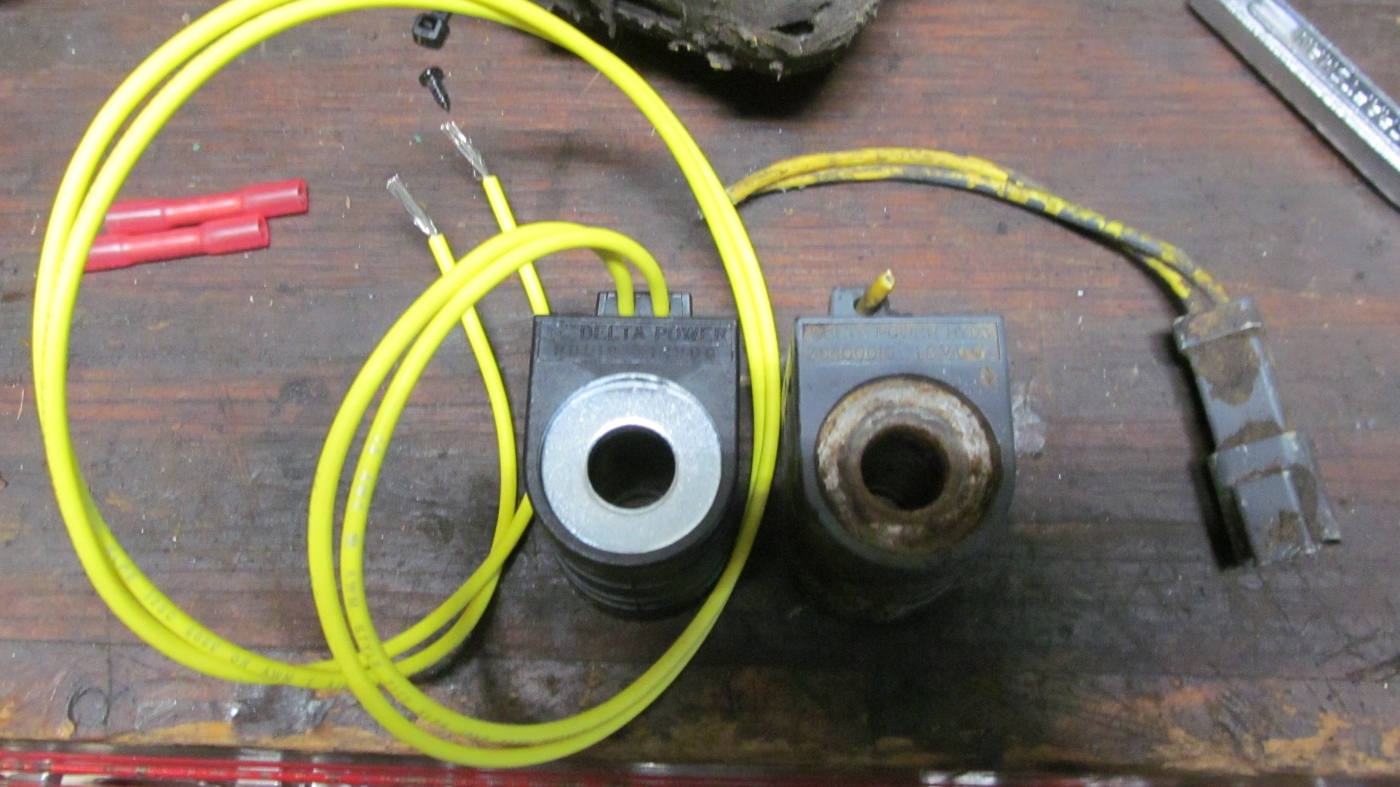

Clean everything off and remove the solenoid coils to see if they have legible numbers on them. Do an internet search or if they are Delta look at their site to get the specs and match them with a coil that just has leads. You can probably call Delta and get some help on a match for the solenoid coils.
On my 4WD coil I found a direct replacement with the wire leads and no plug for under $20. It was part number PDL12. New Holland no longer supplied the coil separate and wanted $500 for a solenoid. Delta had the actual coil with the New Holland plug but it would have cost $120. I found the PDL12 at a dealer somewhere other than Delta direct.

This is the company I bought the PDL12 solenoid coil from. Their current illustration photo is incorrect so I would contact them the make sure it is the coils with the two leads as it says in the description. The forward and reverse coils have a slightly different appearance but it wouldn't surprise me if the same coil wouldn't work on all 3 solenoids. At $11.50 apiece what do you have to lose?
