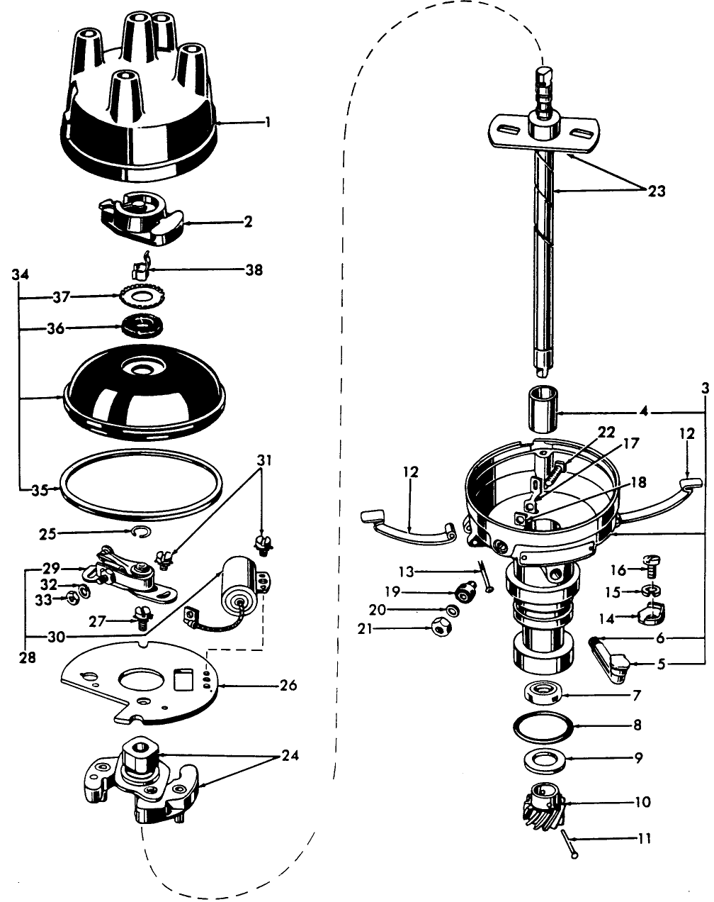

The NAA has run good this summer, with the exception that the water pump went south.
As I was brush hogging, I noticed quite a few hayseeds stuck on oil on the right side of the engine. I haven't examined it carefully, but I believe, oil may be coming from the distributor to block connection. I thought maybe, there should be a gasket between the dist. and block, but I don't see any such part or application.
Like I said, I didn't examine it carefully, but the oil was pretty far forward and spread toward the back of the engine.
Anybody had this problem or know anything about it and it's cure? Would a gasket under the dist. mounting be any problem?
/ Ford NAA Distributor/Oil pressure problem #11
clean it up and take a look as to where it is coming from.
134372 O-RING O-Ring, 1.109" ID x .139" Thk, Base to Block
#12
Is that a Ford number or standard stock number? Have you done this, with results? Thanks.
/ Ford NAA Distributor/Oil pressure problem #13
that's from the ford master parts catalog.
yep it's pulling yer distrib if that's what you are asking..
if it was a small seep.. i might clean up with a spray cleaner / carb cleaner and see what a lil bead of rtv might do..
#14
I'll clean it up and go with the O-ring install or replacement. I still have the old dist., so can check that first. I don't remember seeing one, when I dropped the new dist. in .. it could be there or not. :confused:
Thanks! :thumbsup:
/ Ford NAA Distributor/Oil pressure problem #15
Thanks! :thumbsup:
here's the exploded parts diagram and parts list... part #8 is the oring I posted
#16
How come, you didn't have an "add to cart" button with the breakdown and parts list? :laughing:
Thanks again.
/ Ford NAA Distributor/Oil pressure problem #17
gotta leave soemthing for you to do.. :)
