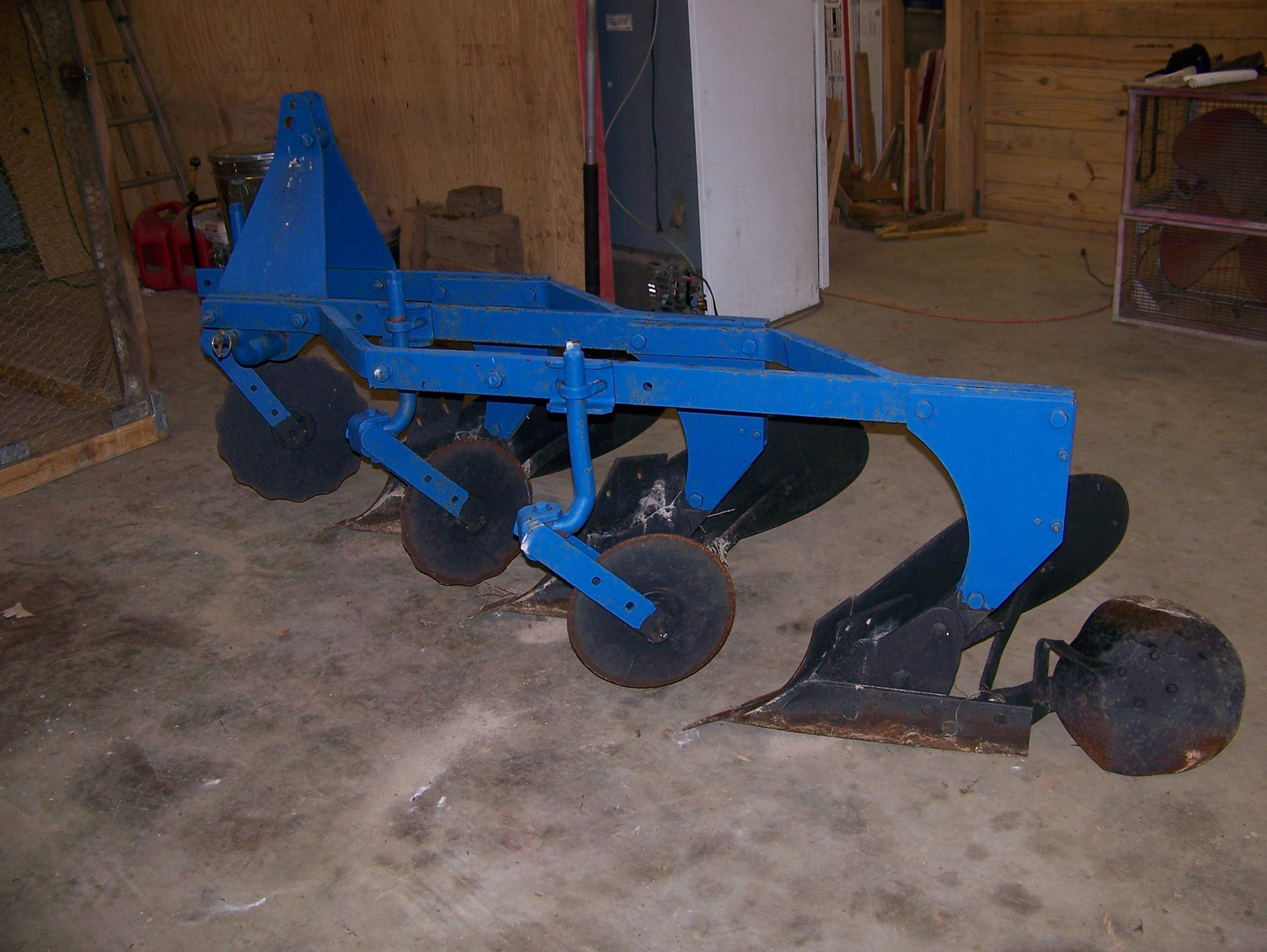

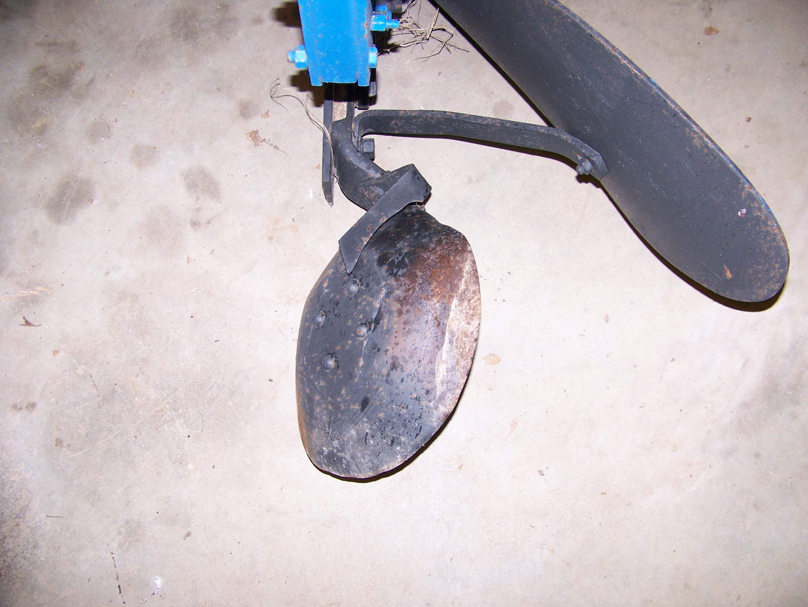

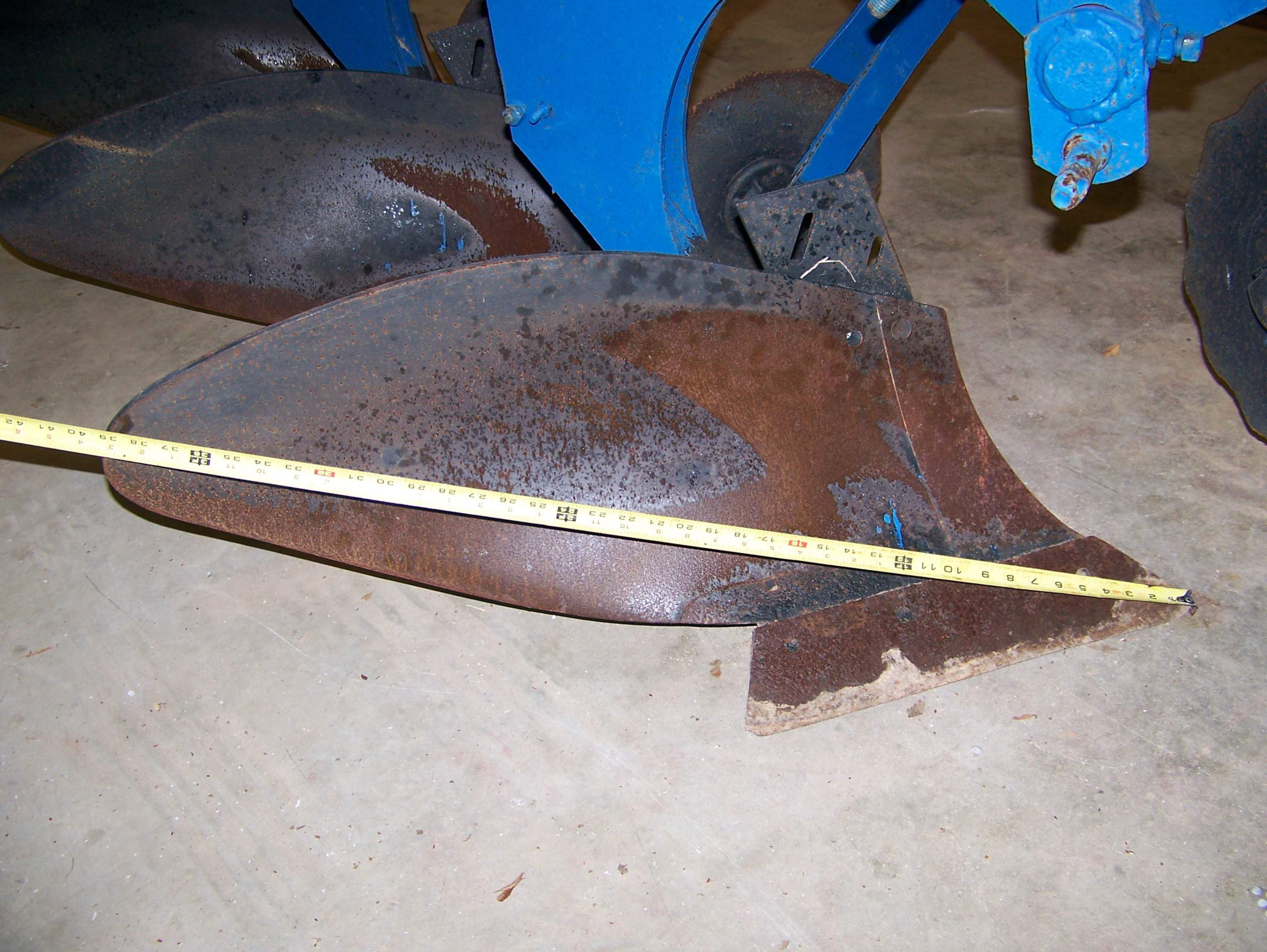

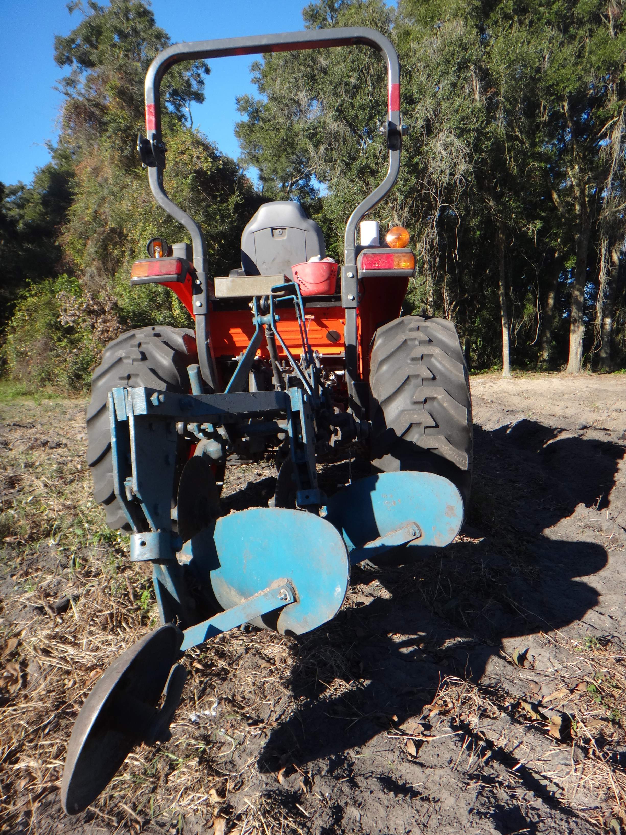

I just bought this Ford Model 101 3 bottom plow. It was near my house, so I jumped on it. I have a couple of questions. I read somewhere on TBN how to measure to know if you have a 16 inch or other size. The plows are about 16 inches apart and the share is 38 inches long. How do I tell? Also, the rear disc,..... is it called a coulter, or a wheel, or disc? Ford Model 101 3 Bottom Plow Right Side.jpgFord Model 101 3 Bottom Plow Rear View.jpgFord Model 101 3 Bottom Plow Rear Coulter.jpgFord Model 101 3 Bottom Plow Plow Share.jpgFord Model 101 3 Bottom Plow Left Side.jpgFord Model 101 3 Bottom Plow Front View.jpg

Measure horizontally from the inside of 1 beam to the outside of the next beam. This will give you plow size.
Rear wheel is a ROLLING LANDSIDE.

Jeff,
Beam centerline to beam centerline is 14 inches.
Rolling Landside. Got it!
Thanks.
Is what male or female? Since the plow will not sweat anything......................she must be female.:rolleyes: I don't care as long as it isn't new orange.:laughing::laughing::laughing:

/ Ford Model 101 3 Bottom Plow #4
There are 3 pieces or parts in the picture with the tape measure. The largest part is the mouldboard, the part directly in front of it is called a shin,
and the 3rd piece on the very bottom is the plow shear. Measure the length of the shear and this will tell you the plow size. The disc blades in front
of each bottom is called a coulter blade.

Zdog,
Thanks. Now I am really confused:rolleyes:............................all three shears are 18 inches.:confused3: So is it a 14 inch or a 18 inch?:confused: I think it is a 14 inch, because the beams are the same width as the shears, so shear to shear cuts would be 14 inches wide.;)

All of our plows were 6 bottom rollover plows and were called 16 inch because that was the length of the plowshare. Google Artsway 166 plow and you will see that they are sold as 14 or 16 inch. Yes, you could have 18 inch shears on a much smaller plow.

Per your own measurements, 14 inches center to center of the beams, you have a 14 inch plow. You do NOT measure the length of the shear (or share) to determine the size of your plow.

I have owned a three bottom 101 and it will be a good match for your tractor. Sure looks a 14" and you would measure between the beams as you have done or measure the width of the cut. I might have a parts book and an owner's manual for the 101 if interested. It will take a little while to set up but once that's done you're good forever.

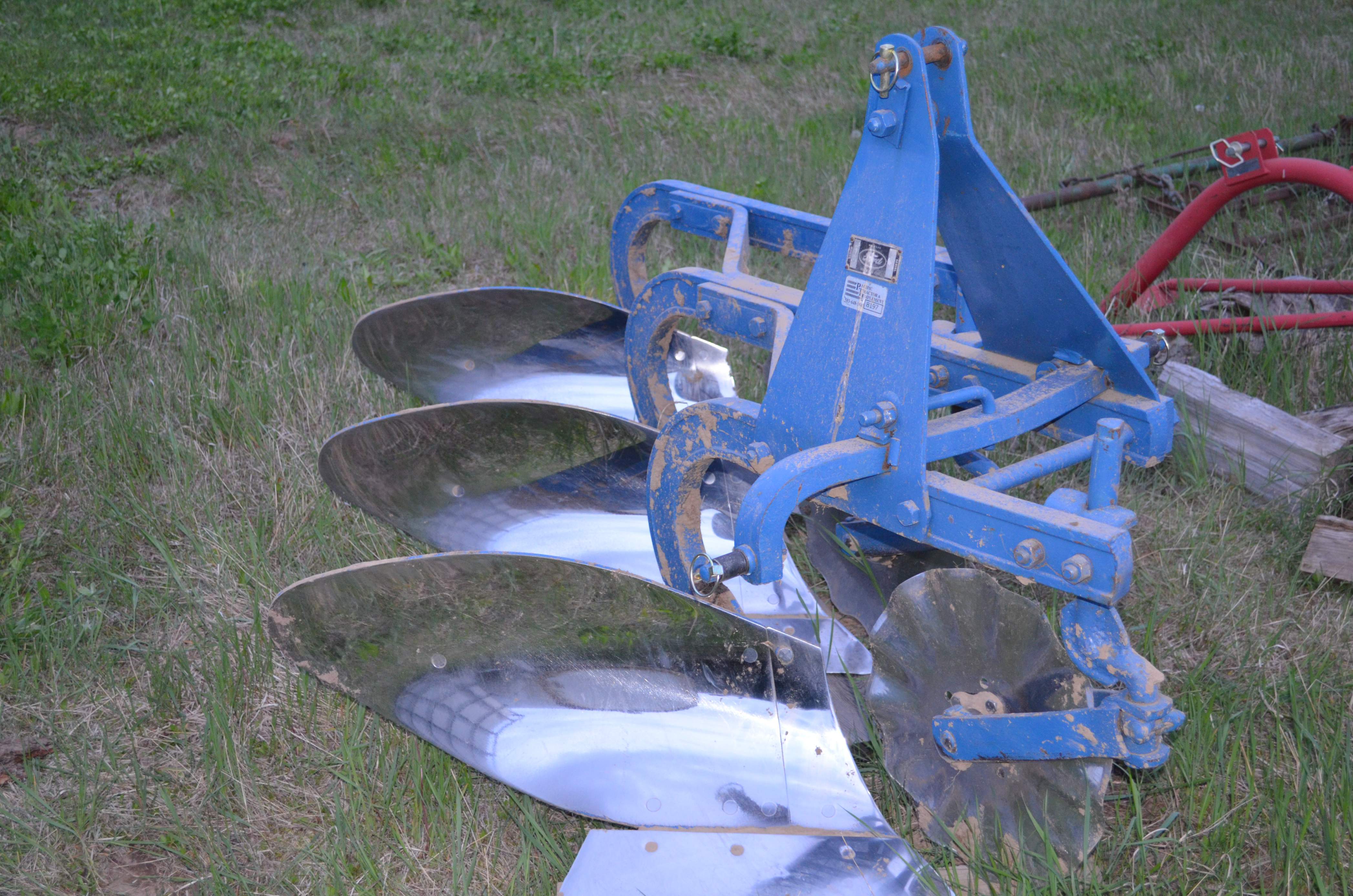

DSC_0420.jpgDSC_0405.jpgI have a Ford Dearborn 10-209, 3 x 16's with coulters. Yours should scour just like mine after a few hours. Looks like yours has trip bottoms when striking a solid object. Once you have it setup to your tractor the art form of plowing begins.

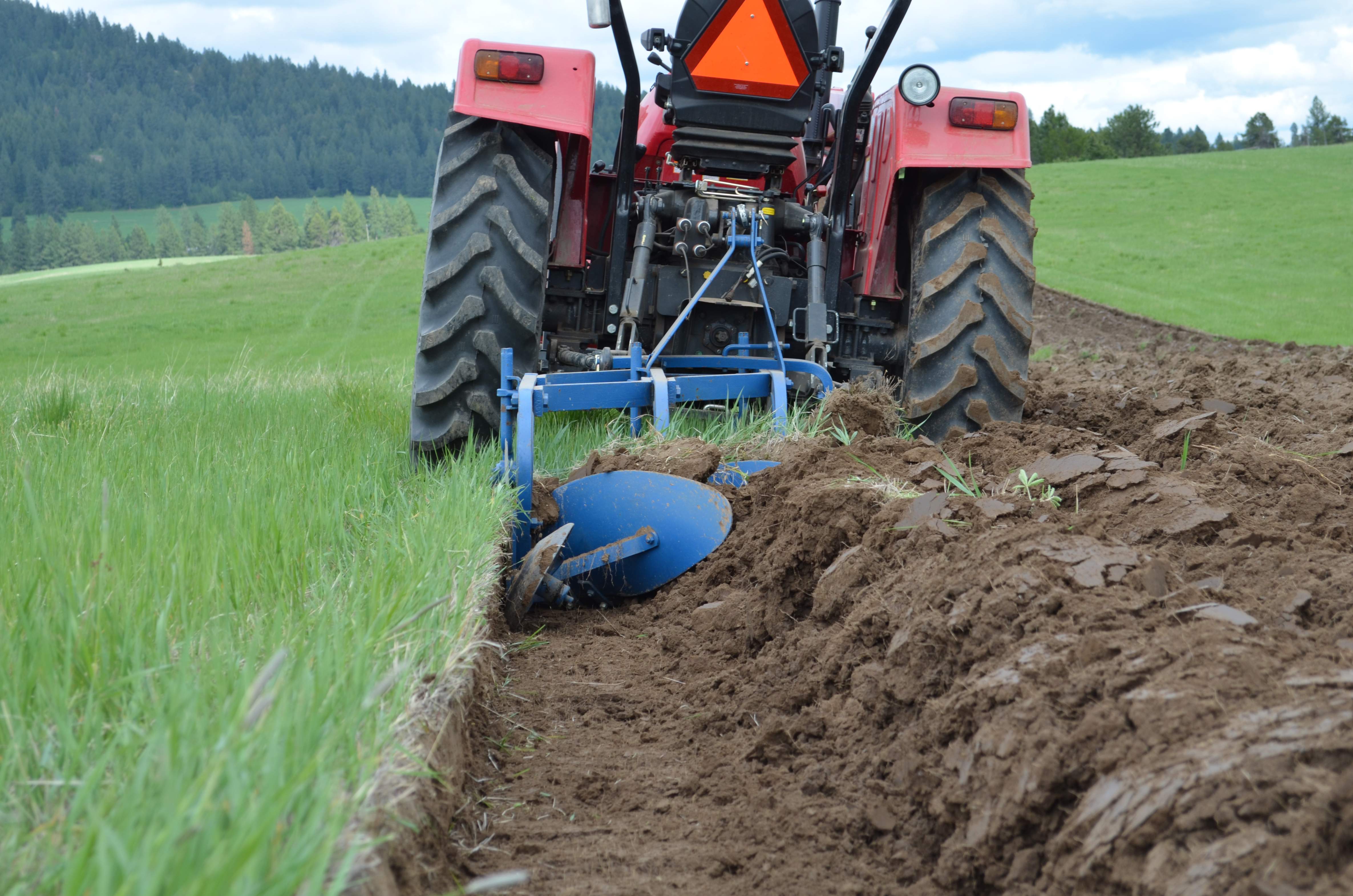

Those are beautiful looking bottoms. What is your soil type?
/ Ford Model 101 3 Bottom Plow #20
Palouse, I'm on the eastern edge of it. The massive rolling wheat fields are west about 5 miles. The soil was blown in from the South & West eons ago and volcanic ash mixed in also. A quick search of Palouse soil will give you a better idea of what this soil is like.
