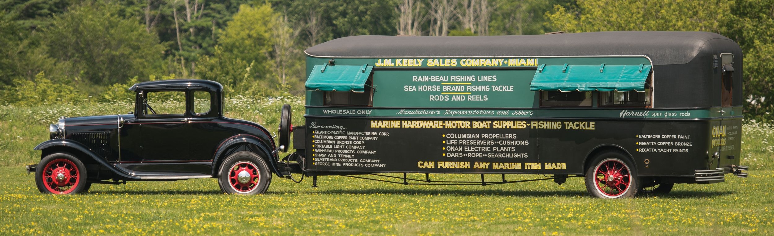

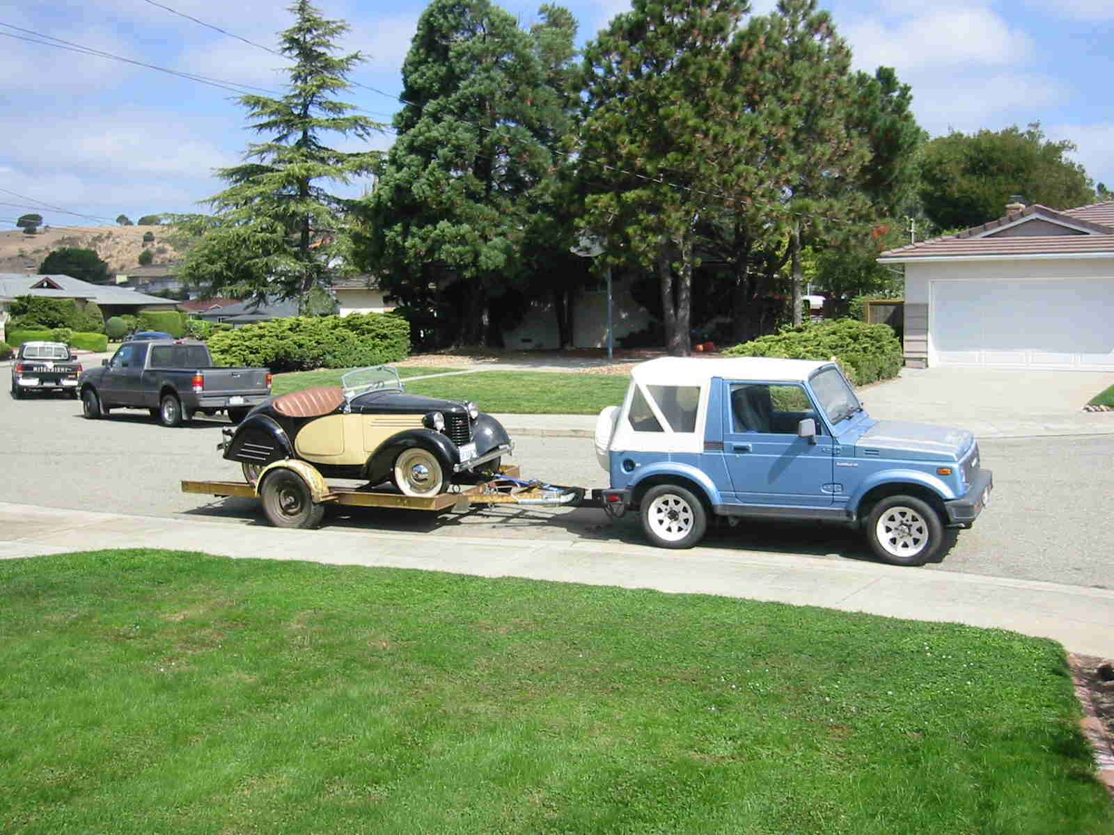

20 mph for 3 blocks is a risk I am willing to take plus in a panic stop the surge brakes should be at maximum.
The front disk brakes on the Samurai are large for such a light vehicle.
Kind of like a 1950 tractor bringing a loaded hay wagon in from the field… only 2 wheel brakes and running a quarter mile on paved county road.
But I have towed often with small rigs.
The bottom picture is all Mechanical Brakes with a lever to activate the trailer brake.

Considering towing capacity is assigned based on being able to handle it safely at highway speeds (as safely as a Samurai is at highway speeds on it's own! jk jk), 20mph vs 60mph should require like 1/9th the braking capability (kinetic energy = ½mv²) so I suspect you were reasonably safe.
