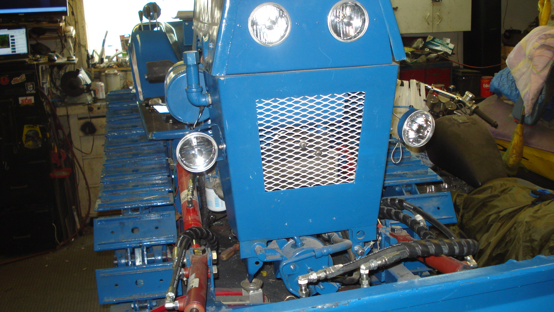

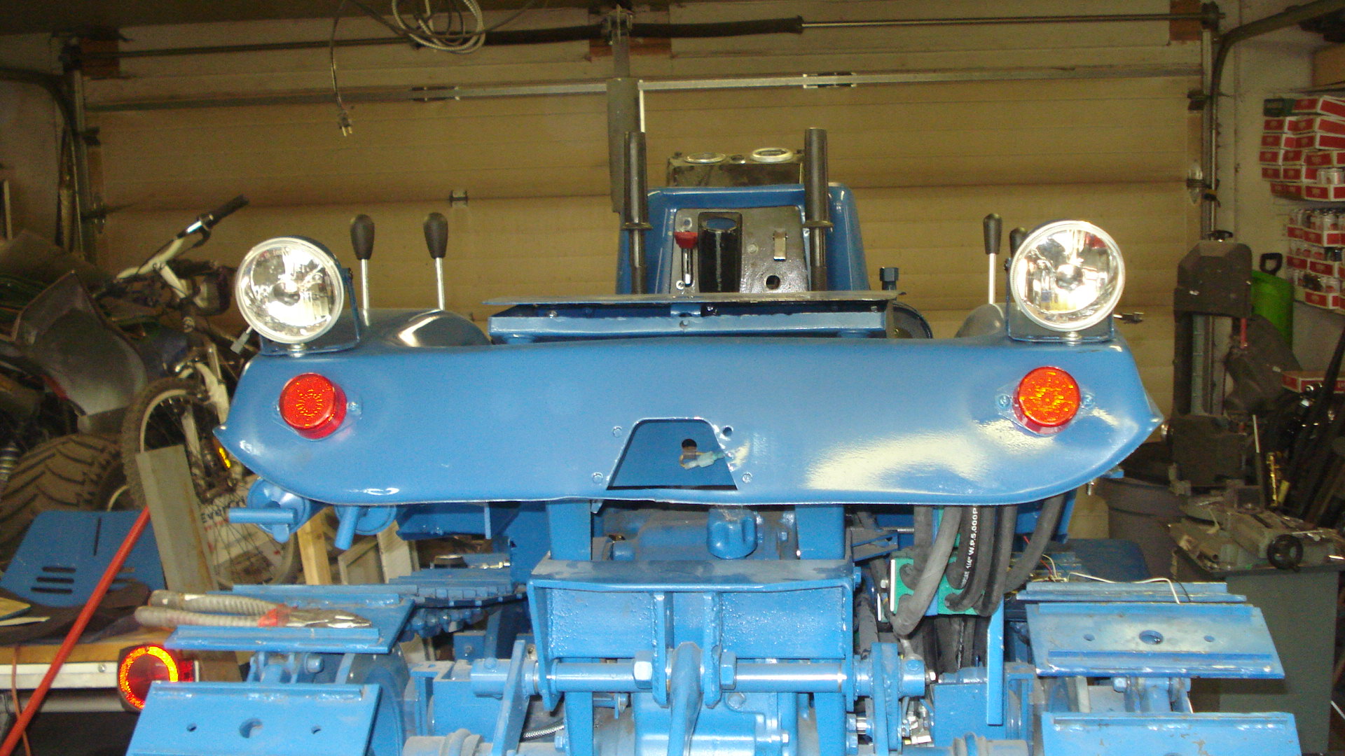

On the plus side I had it running today, and it moved under its own power. Front blade downforce was good, and all the front hydraulics worked as expected. The rear ripper was not strong enough to pick up the rear of the tractor.
Got all the lights installed and wired up

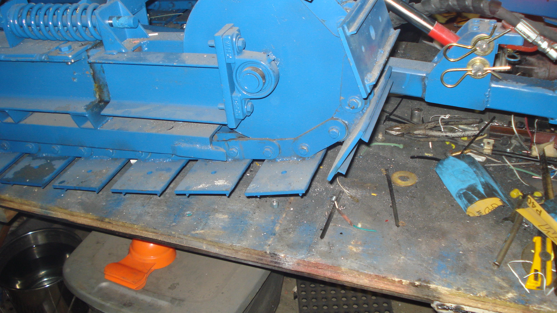

I discovered a problem in the linkage but I think I've got it fixed now. Unfortunately I had to split the tracks to do it.
Then after about 20 or so operations of the main power switch it shorted inside, I'll need a new one and a better circuit breaker. I'll pick that up tomorrow.

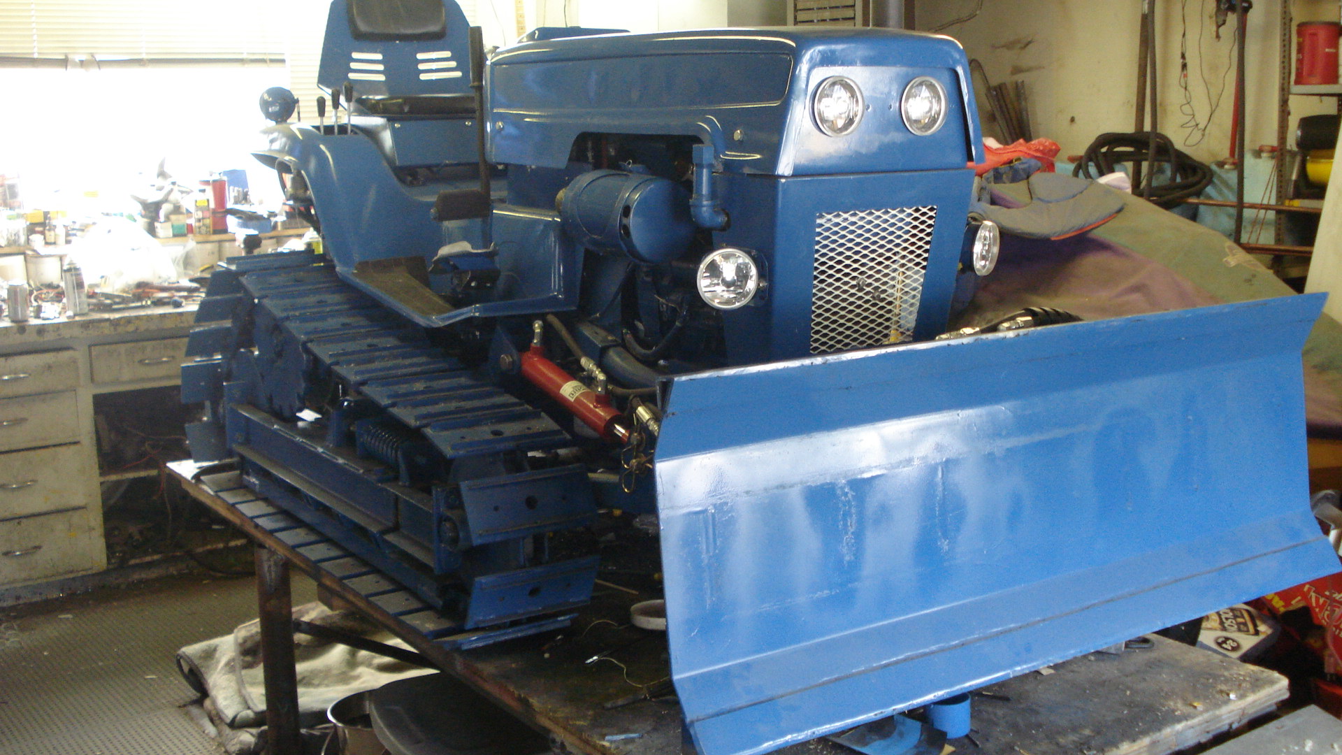

I blocked up the center of the tractor today, and managed to get it up on enough blocks and the front blade to check the tracks. They seem to move smoothly, and don't appear to load the engine much, even at idle. The front hydraulics can pick the front up to the full extent just off idle, so, I expect good things.012.JPG

She looks absolutely beautiful!!
   / Ford LGT Crawler Conversion
#49
You are my biggest fan.
Yes I 'm quite proud of her. It's the most ambitious/ expensive project I've built so far.
Just wait. I ordered the decals this morning.
