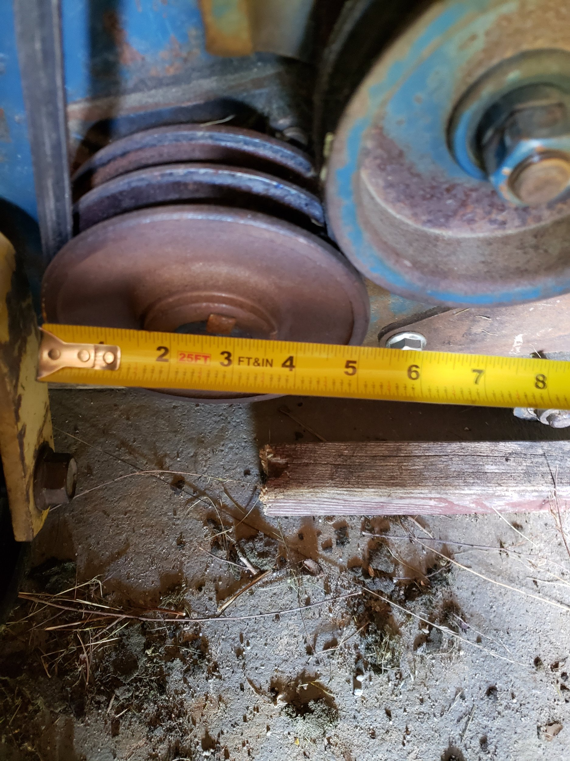

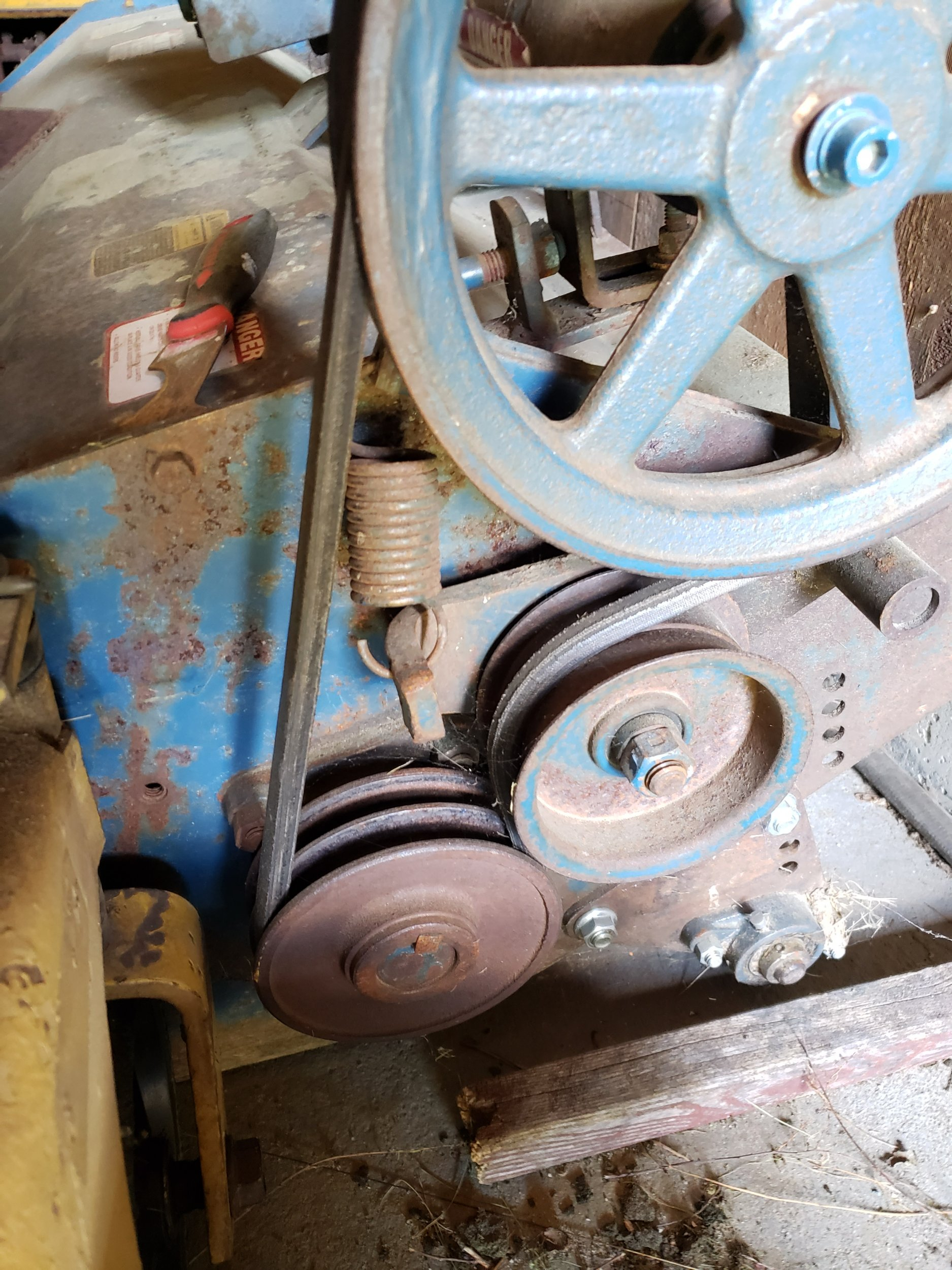

Last year I picked up a Ford 917L flail to use behind my 855 in an effort to keep the pastures around my house in check. I installed all new cutters from Flailmaster and it worked fairly well. The cut was great but the unit had some vibration. Upon inspection I could see the pulley on the cutter shaft moving. Turns out it's not the stock pulley and actually has a tapered bore (shaft is straight). I can grab it and wobble it back and forth.
The pulley is measuring 5 inches across. Can someone with a 917L measure the pulley on their flail so I can try to source the correct size pulley?

That is the drawing/pulley I am asking about. The only price I can find for that part is around $290. I am hoping to find out the diameter so I can try to source one that is a bit lower in cost.
Thank you.

You might try Shoup for a replacement pulley, they carry a ton of replacement parts and good prices too. I buy from them every year.
   / Ford 917L 60" Flail Pully #6
My 917 has a "K" in the serial number; the pulley is 7.58" OD. The belt tensioner is different from that shown above.
