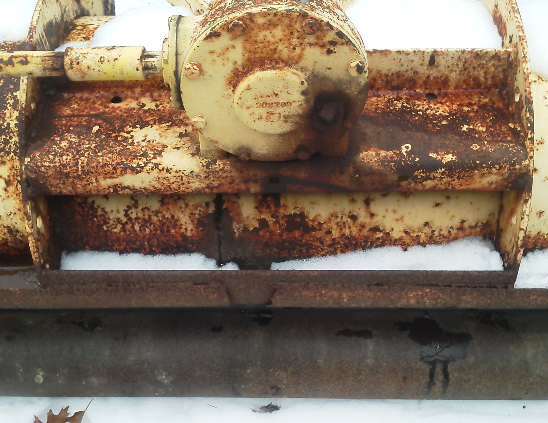

Thanks leonz. Here's a couple pics of the old brute. You can see the crack under the gearbox. Welding looks kinda scabby so I'm going to run some bolts through it in the spring. Thought I'd bolt a plate over the crack with 1/4-20 button heads which should allow clearance for the blades. The rear guard is missing and I may fabricate something simple if need be - is that the rear door you mentioned?
Just wondering if anyone else had seen similar damage?

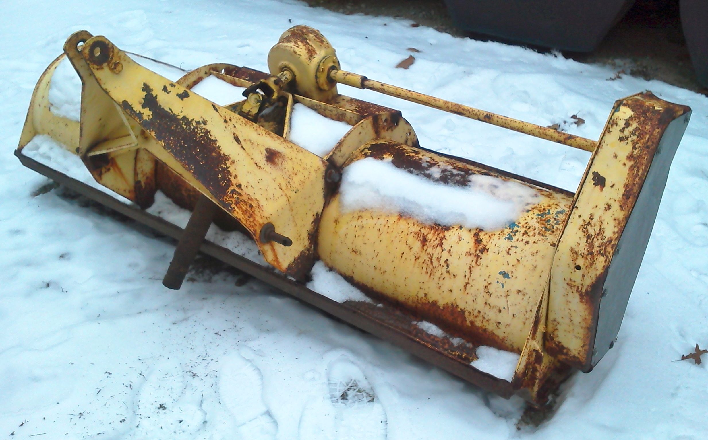

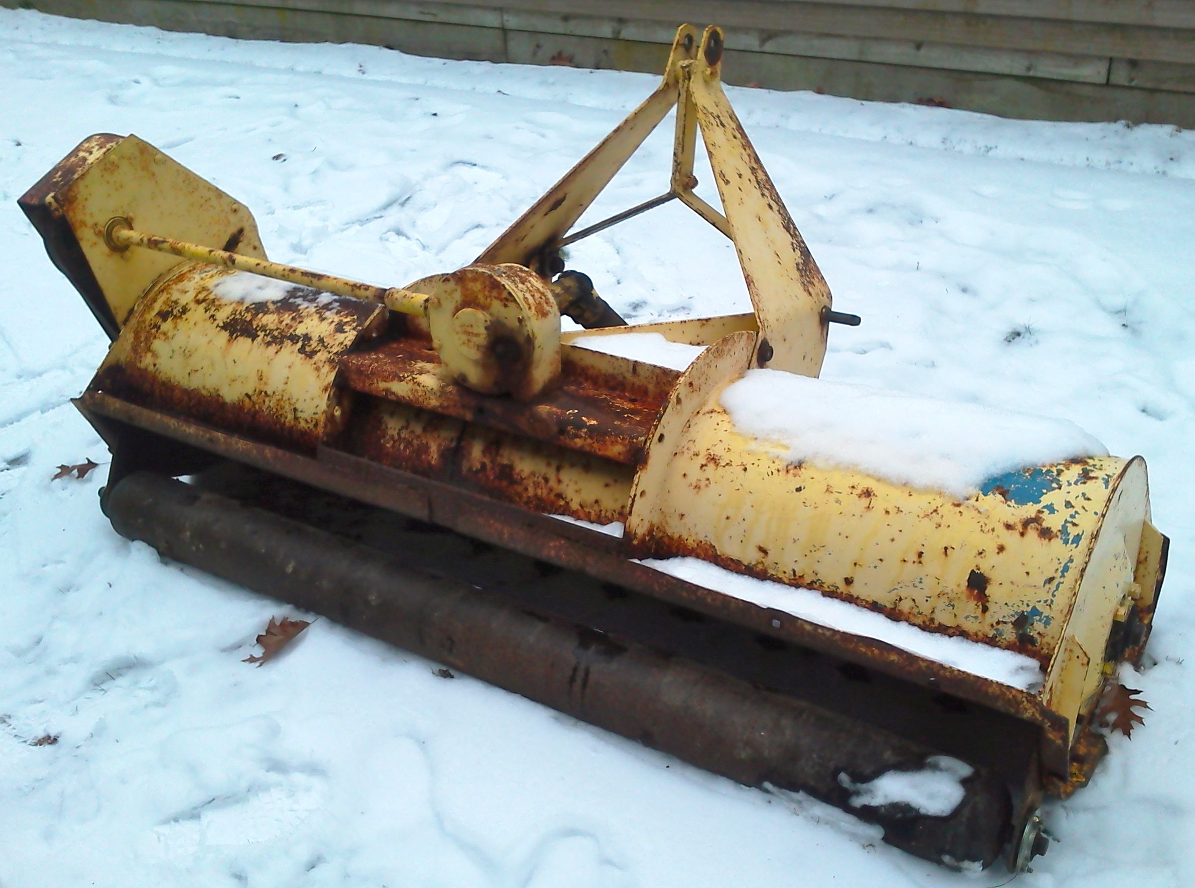

Greetings,
You do not have a rear discharge door on your Ford 907 flail mower
apparently :^(( Oh well.
Now as to the linear crack it looks like they spliced two pieces of steel
together to finish the build on this one.
For the fix;
you should or could locate metal shop that can roll and form a slug of curved steel sheet to
conform to the angle of the flail mower hood. you can buy a pattern finding tool
that follows the curve exactly-if you have a wood shop you may already have one to use.
You could also gas weld the crack together which would work very well too after
you clean out the rust.
Youcould also layer several pieces of thick sheet metal over and under the crack
then gas weld the edges.
getting the square holes is another issue and requires a
punch press that can do this for you.
View attachment 295583View attachment 295584View attachment 295585
