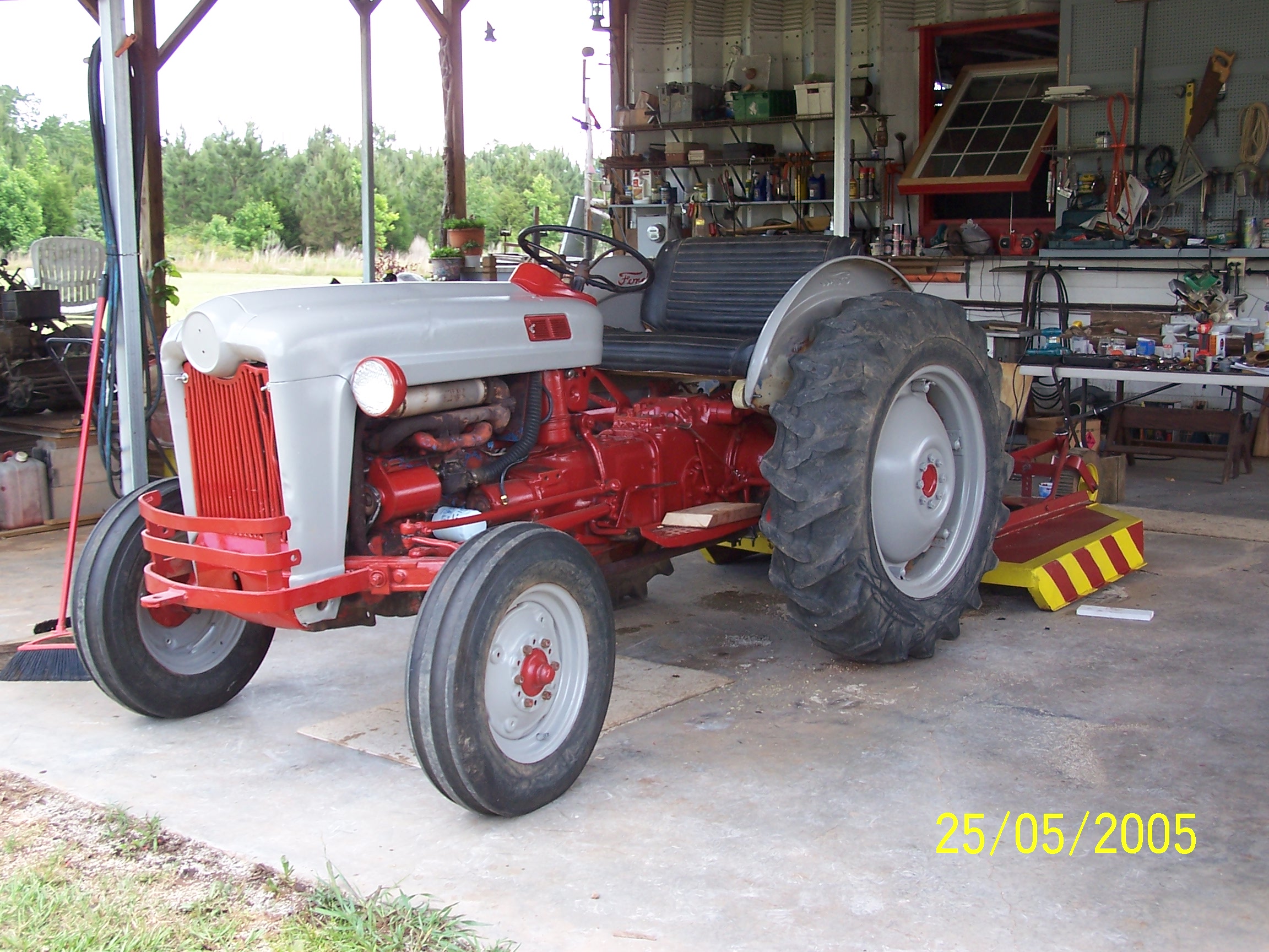

I brushed my old tractor, It came out good, Sure was less to do, an I have spray equipment.Be sure any paint you use has "UV"protection. The hood i did with brush an sealed it with a few rattle cans of clear. The hole thing was easy an fun, The most important thing is sand,clean it an tack rage, before painting.Good luck an give us pics:)

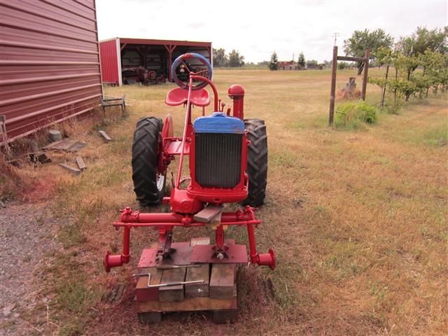

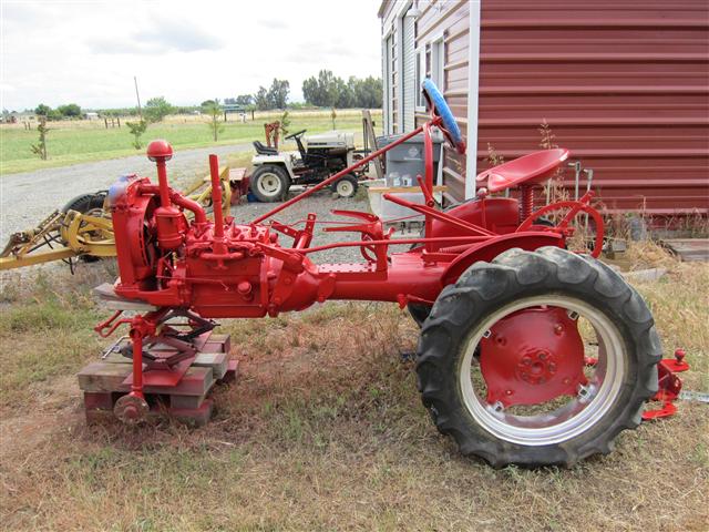

I'd get a gallon and apply with a $40 HVLP spray gun from Harbor Freight. That's what I use to paint my restorations, like this 1948 Farmall Cub
