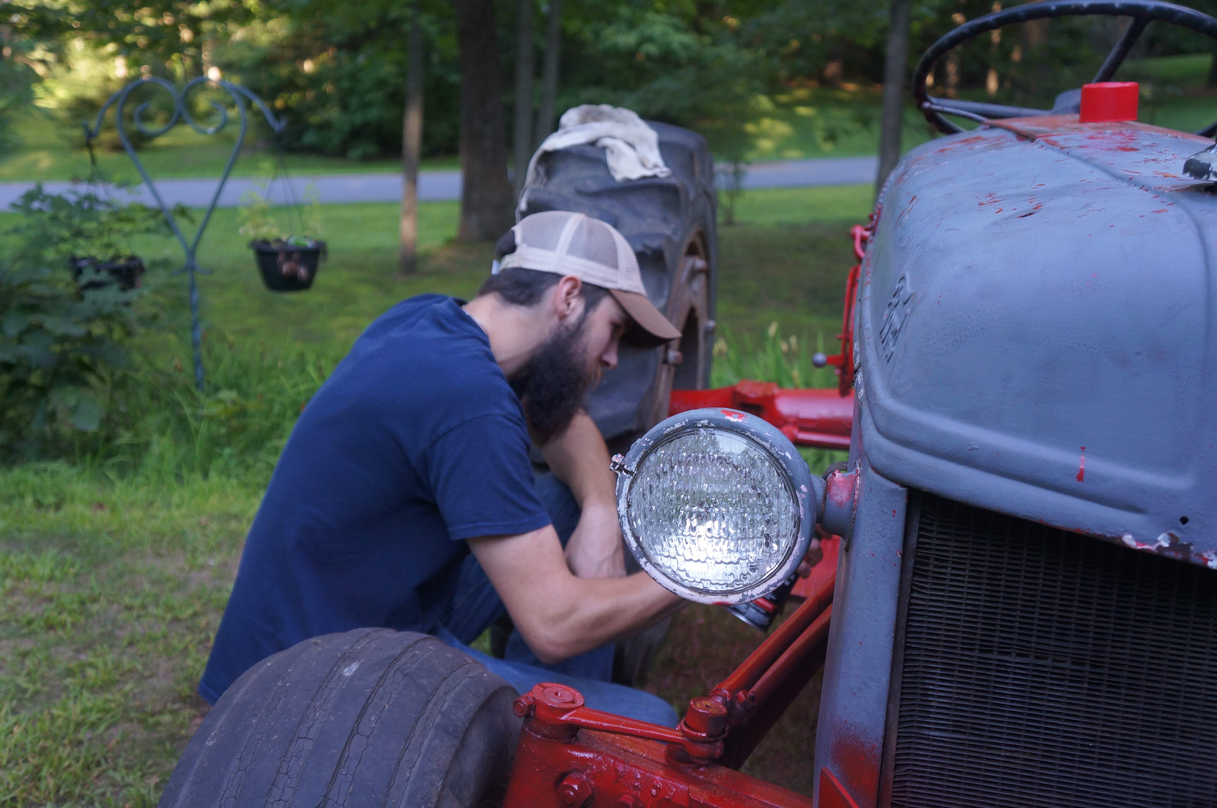

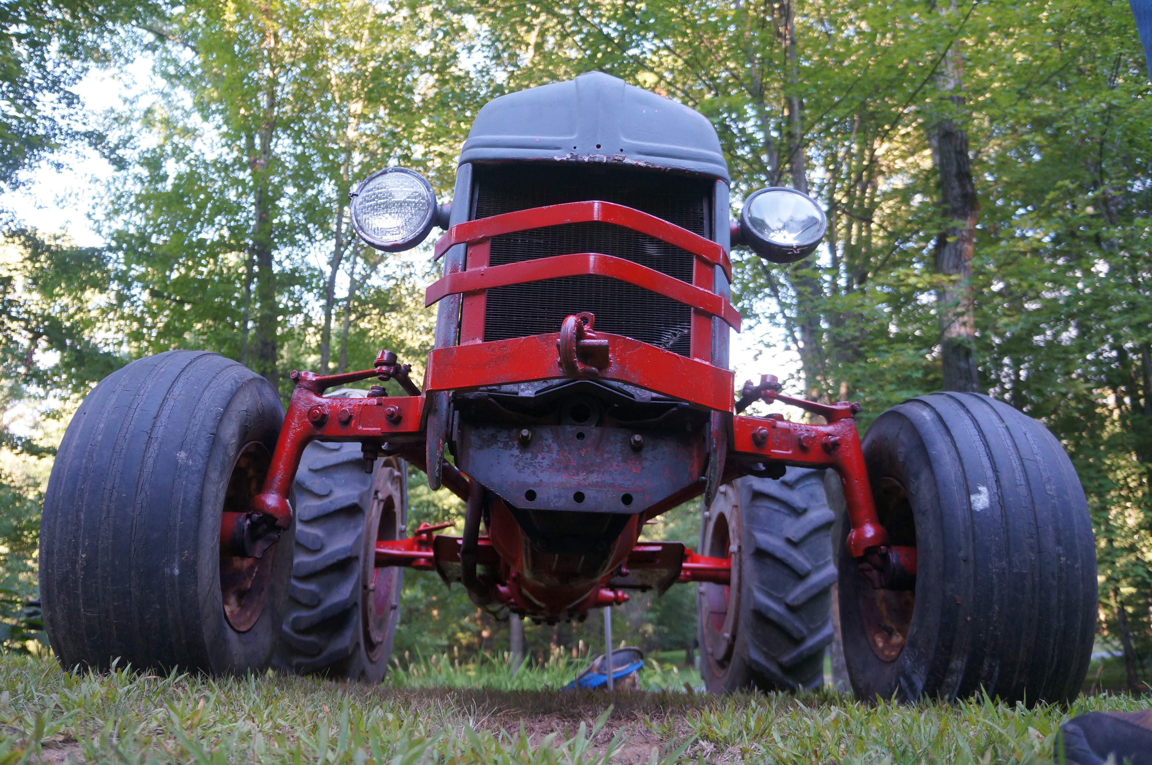

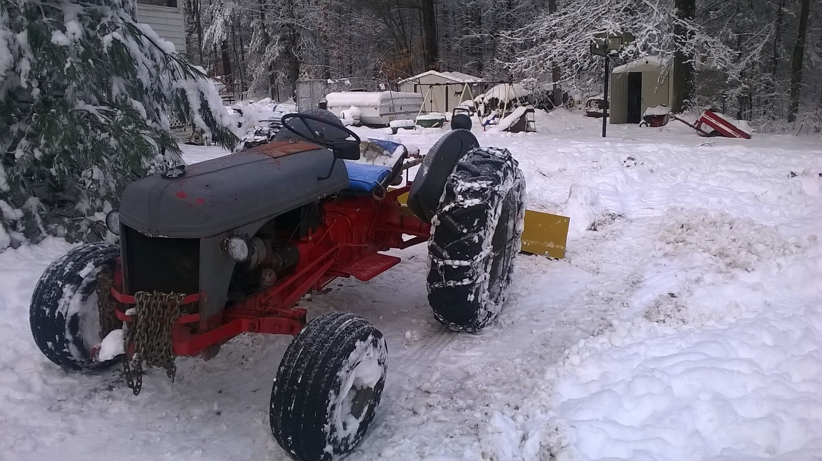

Hello fellow tractor enthusiast, I'm new to the forum and this is my first post.
So i have a Ford 8n and i was looking into power steering options, and for those of you who have also looked into those option for an older machine know that its tough to do without breaking the bank. Now i have a Dearborn 19-22 loader but will be picking up a Ford AI9 with a six foot bucket with all the extra weight id like to upgrade some parts. Now for any of you guys who have opinions of get a newer tractor with a newer bucket I've thought about that trust me. ! don't use my old Ford too much move a little dirt and plow some snow, and frankly i just love the looks of the early fords. future mods will include a 4wd system using parts from the local scrap yard.
Now here's the question for a topic, has any of you attempted to use a power steering pump and rack out of a car or truck to upgrade your steering in an old tractor, or a power steering pump and a hydraulic cylinder to upgrade your tractor.
I'd like to take the new and merge it into the beast aka "Ethel"
Any ideas? Here is a few pictures of the old girl.

Not that hard from where I am sitting. I would pick a side. From there, make the link on the side have a ram on it. Bend/weld new arms to the king pins or run them off of the bottom or the hub like a vehicle. Cross over drag link from 1 side to the other and run your pump. May lose a bit of radius because of the lack of the inner circle not as tight, but still not bad. Just like a solid axle pickup.
