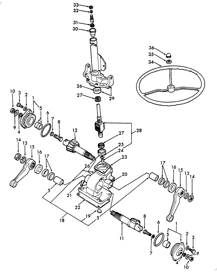

We have an 800 that had a bad bearing in the bottom of the steering shaft. After replacing it and putting oil in it, the oil leaches out of the steering gear shafts. ( the shaft that the pitman arm attaches to) What seals the shaft to keep oil from coming out or am I putting to much oil in it. How much oil is supposed to be in it. There is a pipe plug in the upper part of the housing that we are putting oil up to. The caps with the adjusters on them to take up slack have got new "o" rings on them. any help would be appreciated.
/ Ford 800 steering question #2
the sector shaft seals are leaking.
check yer FO20 or ford service manual.. should have replaced them when you did the thrust bearings.
In any even, if you don't want to go back in, get a grease fitting that will fit that box plug hole and pump in about 2 tubes of NLGI 00# grease ( it's a soft nearly pourable grease ).. JD stores carry a 'cornhead grease that works. Pump it in till it extrudes out under the steering wheel.
I have a ford service bulletin dated 10-31-1962 that reccomends using grease in the steering boxes to 'compensate' for leaky sector shaft seals.
your choice.. repalc ethe seals and go back in with gear oil ( might still leak if the sector bearing surface is worn ).. or grease it...

Are the seals located on the inside or the outside of the casting?
/ Ford 800 steering question #4
outboard o fthe bushing ( 5 ), and inboard of the steering arm.. seal is (17 )
yer parts and service manual has this diagram.. I sugest you get one and refer to it to make this easy repair easier.
