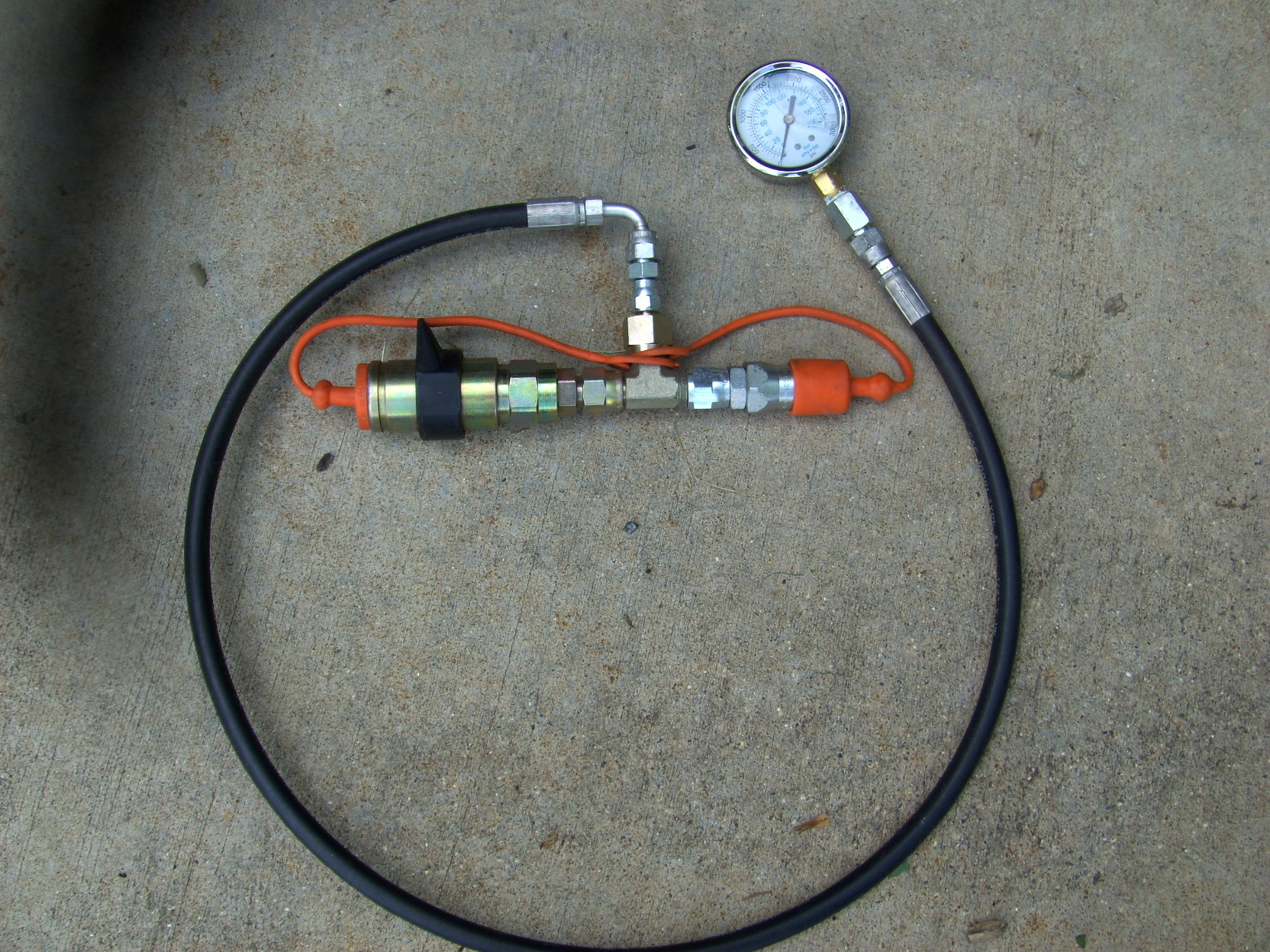

A hyd gauge in the hyd system is always good to have.
