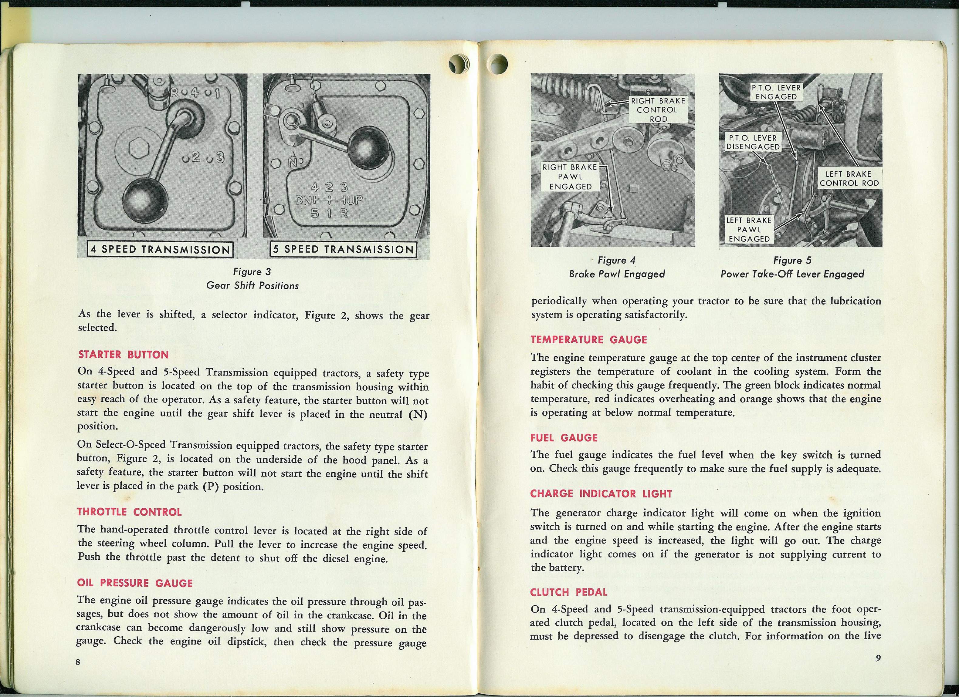

Three forward and reverse? A 641 should be four forward and one reverse.

That is exactly what I was thinking. Maybe I am mistaken. Where the shifter is, it looks as if it is embossed and it only has a 1, 2, and 3. It doesn't have a 4. However, when I look to check the serial number, 641 is the top number and then it has the actual serial number.
   / Ford 641 Workmaster Questions and Advice #26
if a *4* it has 4 gears forward, 1 reverse... shift to 1, pull back.. it's a modified H pattern
#27
Hi, I will run through the gears and check it out. I have only been in first, second and reverse so far. I'll check it out tomorrow.
Hey soundguy... any idea the capacities of the sumps? Do I need to fill each individual sump or does it circulate throughout the tractor. My neighbor was telling me that all of the fluid could circulate throughout the tractor but he wasn't sure. For example, if I just filled the differential sump then it would cycle itself to the transmission and the hydraulics? Or do I need to fill each individually? Also, do you know the capacities? I can't find them in my IT manual. Thanks guys.
Also, any reason why it only has the numbers 1, 2, and 3 where the shifter is? I can't find the number 4 anywhere?
   / Ford 641 Workmaster Questions and Advice #28
take a pic of your trans top. if it's a single stick and not a 3spd or 5spd. it is got the 4 molded in there.
the entire concept of seperate sump is just that. seperate. thus you need to fill each. 3 fills.. 3 drails.. 3 level checks.
the I&T manual does have it in the front under specifications and capacities.
figure on 5-6g of utf to do all rear sumps.. it's probably something 6-8-6 or 6-8-8 or something like that. i just fill em till the level check is happy then go.. have not really 'measured them vs book.. but know 6g is more than enough... 5 may do it.. dunno without looking at a manual
here' i scanned and uploaded a pic out of my 4000 4 cyl owners manual.. same 4spd trans in all the 00/01/000 4cyl machines. yours is the left pic. see the pattern?

Ok, that looks identical to the area where my shifter is... except there is no 4. That is a little odd.
