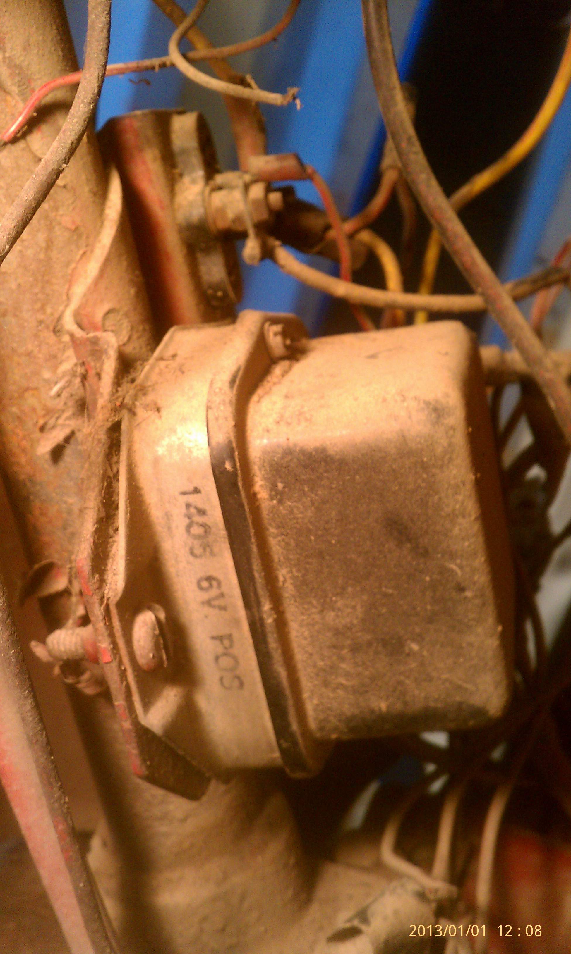

I bought this tractor well after the 12 Volt conversion was done to it. I was told the charging system worked but the Volt Meter wouldn't so I wasn't too concerned. I knew the 12V sealed beam lights didn't work but I figured that would be a fairly easy fix. Now that I have the hood off to fix a radiator issue I decided to tackle the small problem with the charging system. I spent last weekend gingerly unwrapping (breaking apart brittle plastic tape was more like it) gangs of wires in order not to break or disconnect anything as all I wanted to do was a simple repair. I didn't want to rewire the whole things. I had printed out the stock 6V wiring diagram and the standard 12V conversion diagram to see which mine represented the closest. As it turns out - neither.
I decided I needed to do my own wiring diagram. On it I numbered the wires and then I put tape on the wires themselves so I can make sure to account for everything. I've attached the wiring diagram.

2.) The Voltage Regulator is a 6V regulator (see picture).
3.) The 12V Coil is an External Resistor type (see picture) and there is an external resistor.
4.) Although the alternator goes to the 6V voltage regulator, the voltage regulator itself isn't hooked up to anything. It is grounded to the same mounting plate as the terminal block. And there is another wire that comes form that same ground screw that went to the front of the tractor near the alternator but wasn't hooked up.

hack the wires off.
get a real 12v coil.. napa ic14sb 16$
wire from alt charge to one side of an ammeter other side of ammeter to battery site of start solenoid. wire from alt side of ammeter to key, to coil. wire from alt side of ammeter to lamp switch to lamps.
wire crom coil side of key thru a 194 marker bulb to #1 terminal on al.
wire from charge stud on alt to #2 terminal on alt.
key on. lamp lights.
get her over 500 rpm.. lamp should go out and ammeter show charge. if backwards.. swap wires side to side.
all laods on alt side of meter.. battery on other side by itself.
that's it

Thanks, SG. That's kind of what I figured I'd have to do. The wires that are there are at least as old as that brittle plastic wrapping I pulled so it should be replaced anyway. Thanks for the advise.

SG, haven't been able to get over there much but finally did. I did the wiring per the 3 Wire conversion like you described and shown here: https://www.dropbox.com/s/7rwbu1c75xaywd7/Ford%20640%203%20Wire.pdf I did use the 194 bulb instead of the diode. It does light up at low RPM and go off at about 500. I had to replace the old battery as the old one wouldn't hold a charge any more. That's done. Lights and everything work. However, I don't think it's charging. The Amp meter doesn't move. Could it just be a bad meter? What steps should I take to figure out if it's charging and how to fix it if it isn't? Thanks for all the help.
/ Ford 640 12 Volt Conversion Clean Up #11
first determine if the ammeter is even hooked up correctly.
alt charge stud to one sode of amp meter.
wire that runs key switch and wire that runs lamps also on that side of the ammeter.
other side fo the ammeter tot he battery.
that gives you net charge / discharge.
the 500 rpm turn on sounds ok. most of them turn on about 350+ depending on pulley size..e tc.
a volt meter vest on bat before start, and then at throttle with 194 lamp off will tell you if the battery is being charged... irreguardless if the ammeter is hooekd up correctly.
most ammeters today are shunt voltmeters.. iven if they don't read.. they usually pass current thru the shunt.
post back

Well, SG, you were exactly right. I checked the wiring and it was right. So I fired it up. At 350 RMP (light barely glowing) it was at about 13.6 Volts. Passing 450 it rose to 14.7 Volts acorss the terminals and stayed there. So, the gauge is bad and the charging system is working just fine. Thanks for all the help.

cool deal.
those ammeters are usually shunt voltmeters.
this means the shunt is intact.. and the meter movement is simply bad.
easy to R&R
