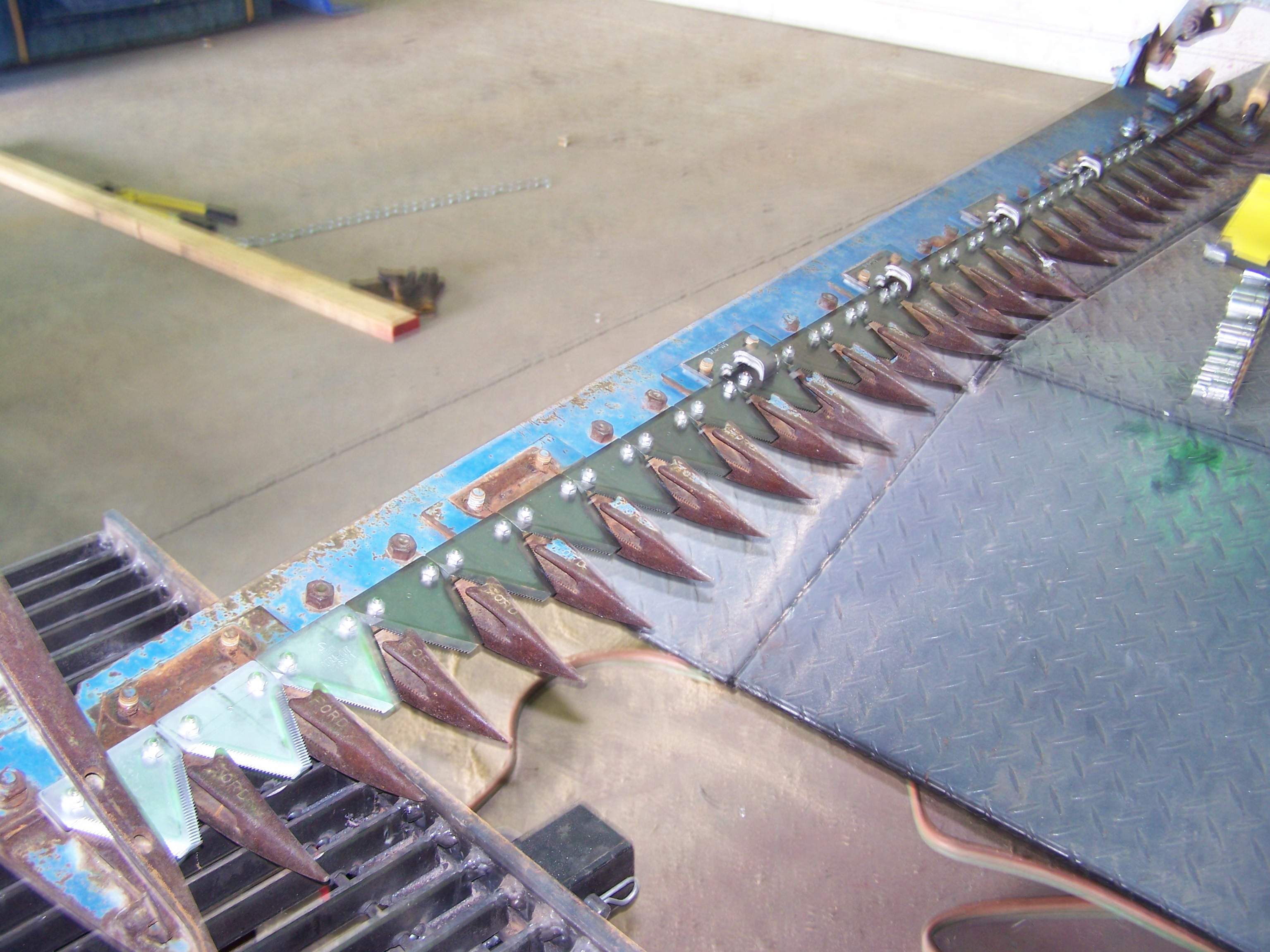

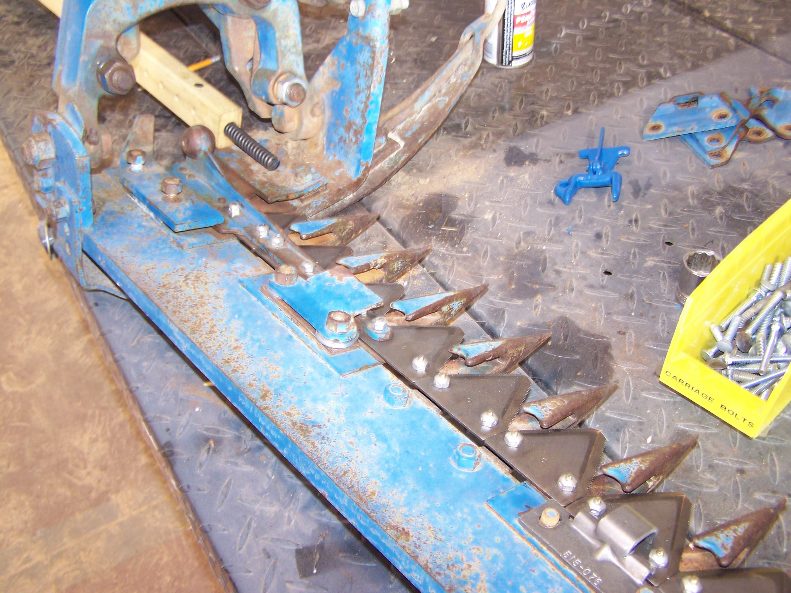

You can use bolts instead of the rivets. Just have to get "high" rise type knife clips. You can see in this pic of mine when I converted to bolts. I didn't want to mess with the rivets and buy the special tool. Easy to change blades.
