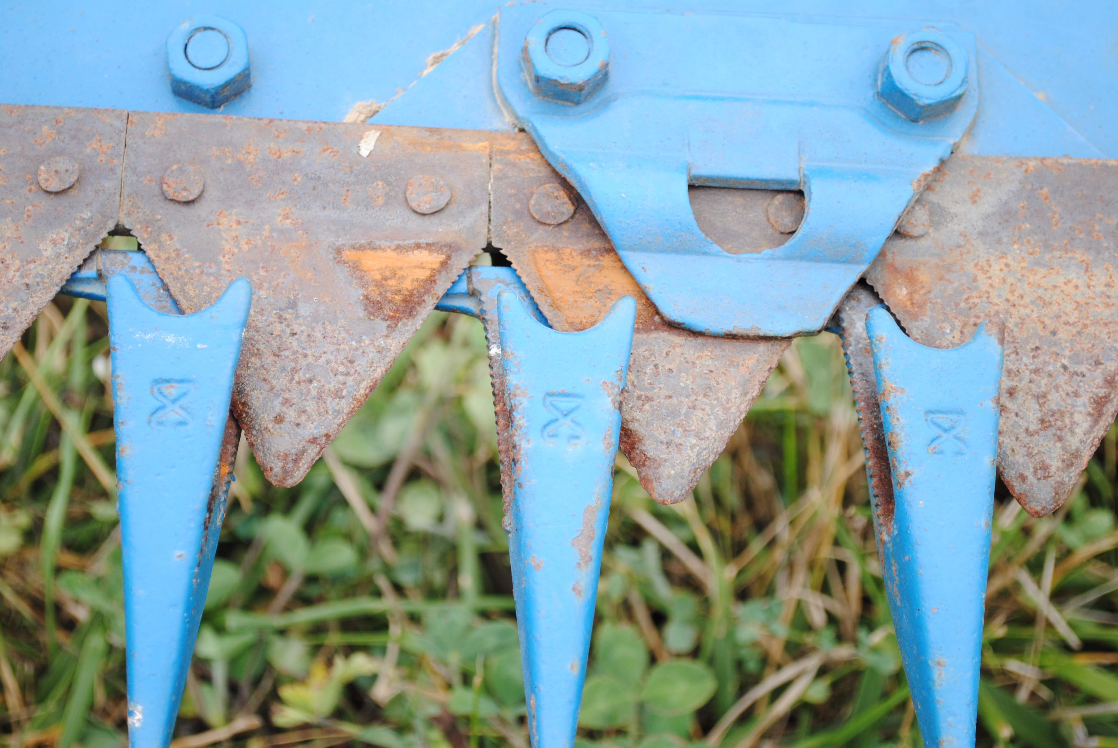

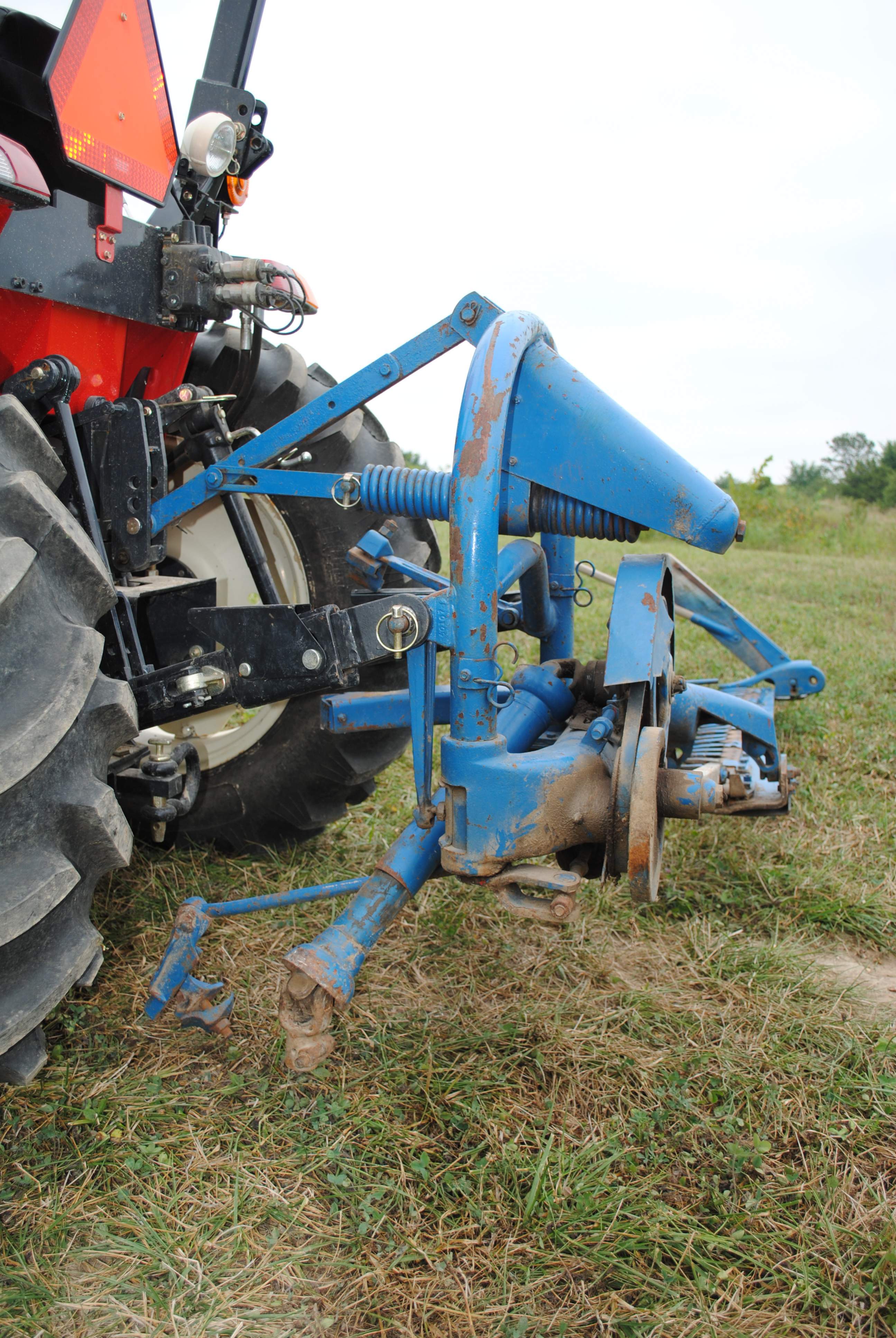

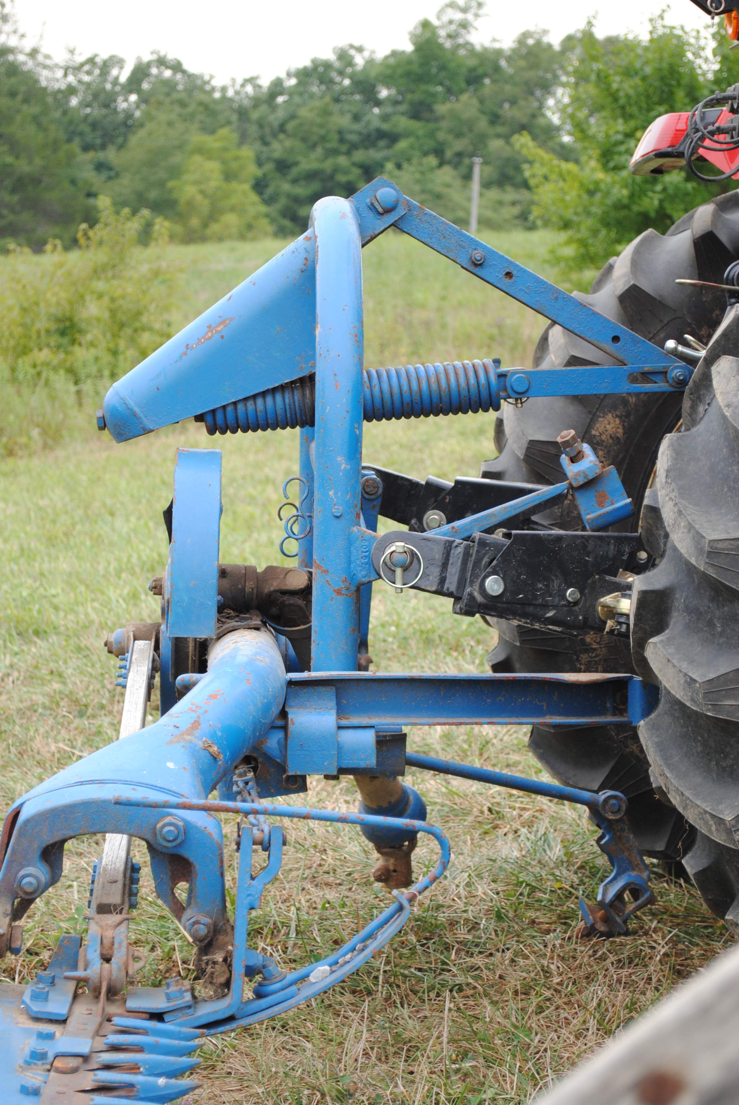

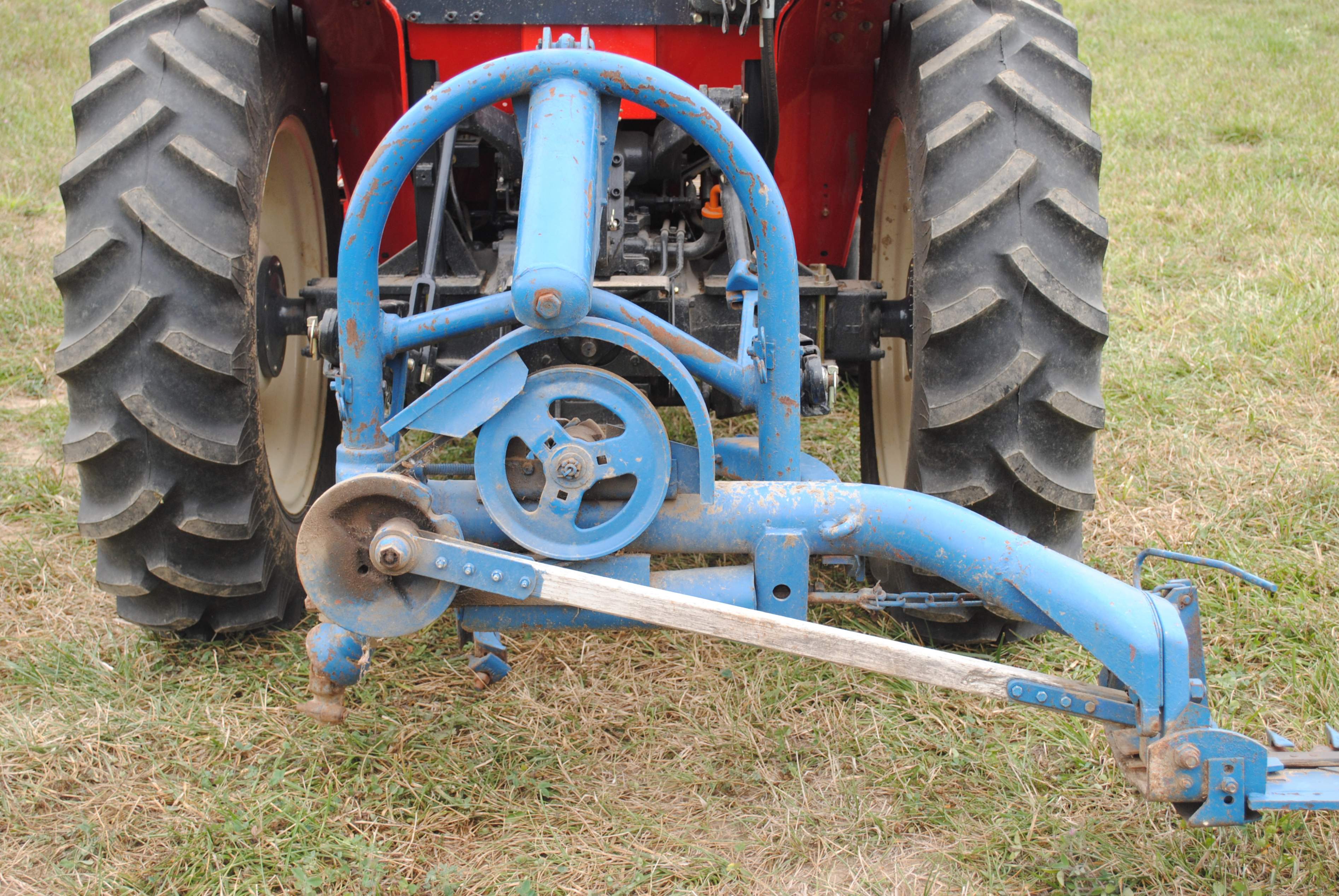

I am new to sickle mowers and have been wanting one to mow around the pond and some various other areas. I picked up this Ford 501 at an auction for $300. I didn't get a chance to look it over before bidding, but it seems in decent shape for the price. I greased everything up and it works fine, but I have a few questions.
1. It has what appears to be some kind of stabilizers that should attach to the 3 point hitch arms. The left one doesn't fit my tractor very well and the right one doesn't fit at all. Are these needed?
2. The cutting teeth are obviously dull and I am debating whether to sharpen or replace. Does anyone have suggestions on where to purchase new teeth and how much I should expect to spend?
3. Is there anything else that I'm forgetting?
Thanks for the help.

TSC or webbs sickle service are good places to get parts. You will need to figure a way to attach the mower left arm to the tractor lift arm. This one carries your cutterbar when you raise your mower with the 3 point lift. The right side is a stabilizer and does not need to be used, if you stabilizer the mower with your tractor sway chains. Ken Sweet

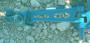

Here is what your left clamp should look like. The lift arm of the tractor just lays in the lower groove and the toe clamp holds it in place. Ken Sweet

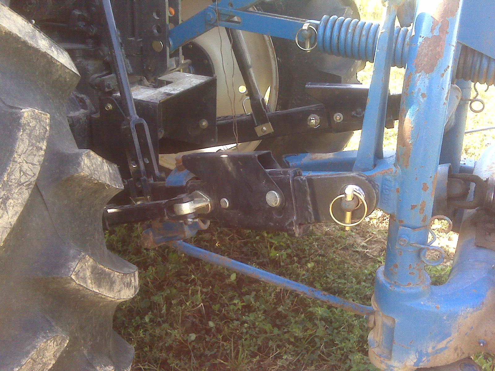

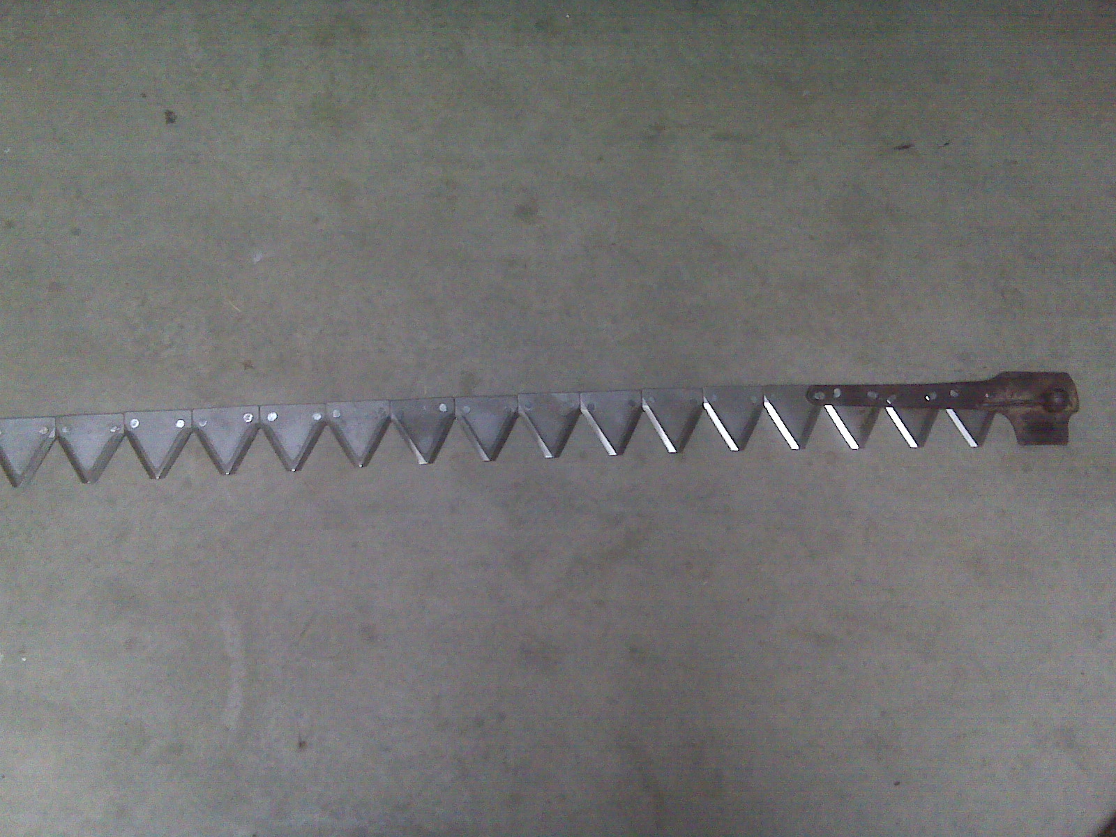

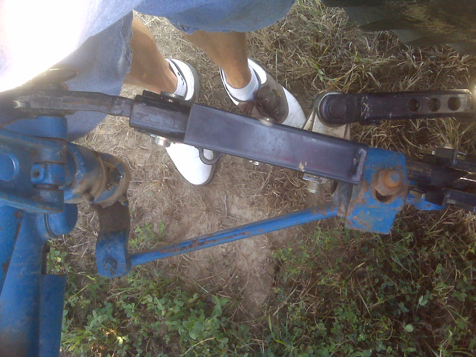

I found an online manual for the 501 and had some time to work on the mower Sunday. The manual was very helpful and many of the adjustments were way out of wack for my tractor. I was able to get the bottom portion of the left clamp to work but I had to attach it forward of the extendable lift arm release. The fold down portion of the clamp won't reach that far and even if it did, the release would get in the way. It's difficult to explain, but hopefully you can tell by the pics. I think that portion of the clamp just holds it from sliding on the lift arm and you can tell on the pics that it can't really slide anyway. Hopefully it won't cause any odd stress on my lift arm or the mower.
I got the knives replaced. Got them from the local farm store for $10 for a package of 10. I wanted to use bolts instead of rivets, but don't think that there is enough clearance under the knife clips.

use rivets. get one of the tools i told you about. one end punches out the old rivet, the other sets the new one. you can do it in the field on the mower if you knock a knife out on a rock.
/ Ford 501 Sickle Mower Help #11
You can use bolts instead of the rivets. Just have to get "high" rise type knife clips. You can see in this pic of mine when I converted to bolts. I didn't want to mess with the rivets and buy the special tool. Easy to change blades.

If you look in the manual you got,you'll see that lif arm attachments are specific to a cerain model tractor. I have the same problem; don't sweat it; attach as best you can figure out. The main one to attach is to the break away if I recall.
