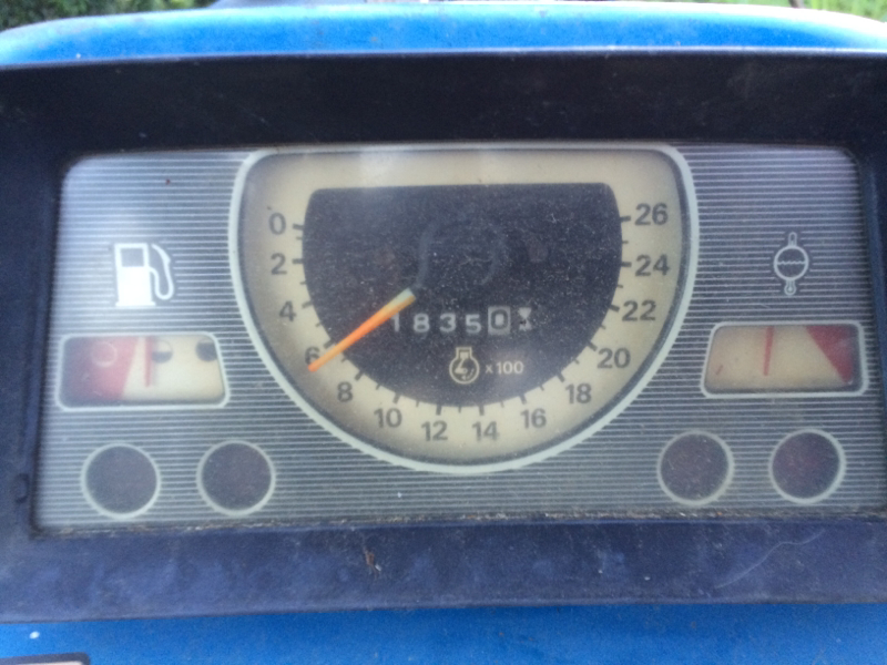

Ok I think I have a issue. Let's start from the top. I bought this tractor and seems to run and crank very well. But I first did a coolant flush and got rust colored coolant out. Filled with clean water plus radiator flush ran per directions and got more rust coolant out. Did again and more very rust colored coolant. Radiator pretty clean last drain but engine coolant very dirty. On top of this first drain out I got a lot more water than second and third drain out. It's like system is not completely filling back up and water is over core in radiator. Seems like less water in engine block. Also I don't see water moving in radiator but not sure I should. Next interesting part So backing up when I got the tractor I noticed temp gauge ran right up to red but would never go into red. I removed radiator cap and no boiling out etc. So I purchased a new 188 thermostat and now temp goes a little into the red. Next I decide to get a new temp sending unit and now it runs from little red mark (1st quarter of gauge) to middle of gauge as you would expect. See picture! My questions now are (1) why am I still getting rust out. (2) why can I now not get enough water back into the system (3) should I see water flowing in the radiator (4) And do the pics I took showing inferred thermometer look like normal temp readings. These are on the block not the manifold. Rear of engine definitely hotter that front. Is this normal? Please help!
Like sound guy said rust likes to settle down and stick in the water jacket, keep flushing.
I'd guess the new Tstat is holding tighter than old and not letting water gush out fast.
I usually remove Tstat only for the purpose of flushing.
Not much flow to see because the Engine isn't working hard enough to open Tstat completely.
I realize your not shooting the exhaust manifold but I think your getting some residual heat in the readings, holding the gun closer reduces the coverage area of the average temp.
I would shoot the temps of the Tstat housing, the lower rad hose, and maybe the oil pan(relative oil temp)

Thanks guys. All you said ended up on the mark. It took a total of 4 flushes with Gunk radiator cleaner to remove all the rust. Each time water looked very dark brown. I ended up removing the new Tstat I had just installed but had stopped working after only 4 hours and did the last two flushes. Then installed a new Tstat which works great so far. Thanks for your help as I'm a happy camper now.
